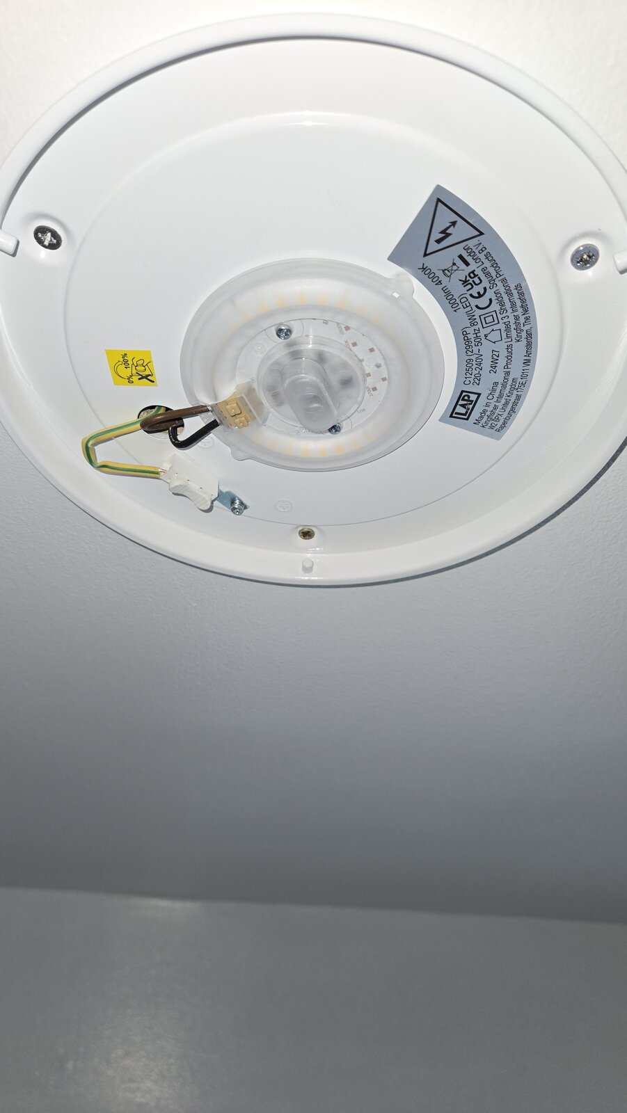

Yes that's what me and the wife think, so the tenant was a handy and he would always ask me first before doing anything around the house, for some reason this time he's changed a few ceiling lights without telling me. He's also changed the kitchen light too I can take photos of the the connections to the kitchen light tomorrow and put them on here.
Is that pic of the hall ceiling light ?
There must be some connections in the ceiling ,behind that light fitting and possibly in a junction box. As others have said the disconnection could be on another light fitting position ,so you will need to do some further investigating.
Yes that's the hall ceiling light I will take a pic of the kitchen one tomorrow also try to take pics of the connections behind the fitting

I've been so busy with work, had yesterday free though so went to the house and looked at all the new lights the tenant put up, found a loose wire on the light in the living room, got it working now, thank you guys for the all help you were all great
