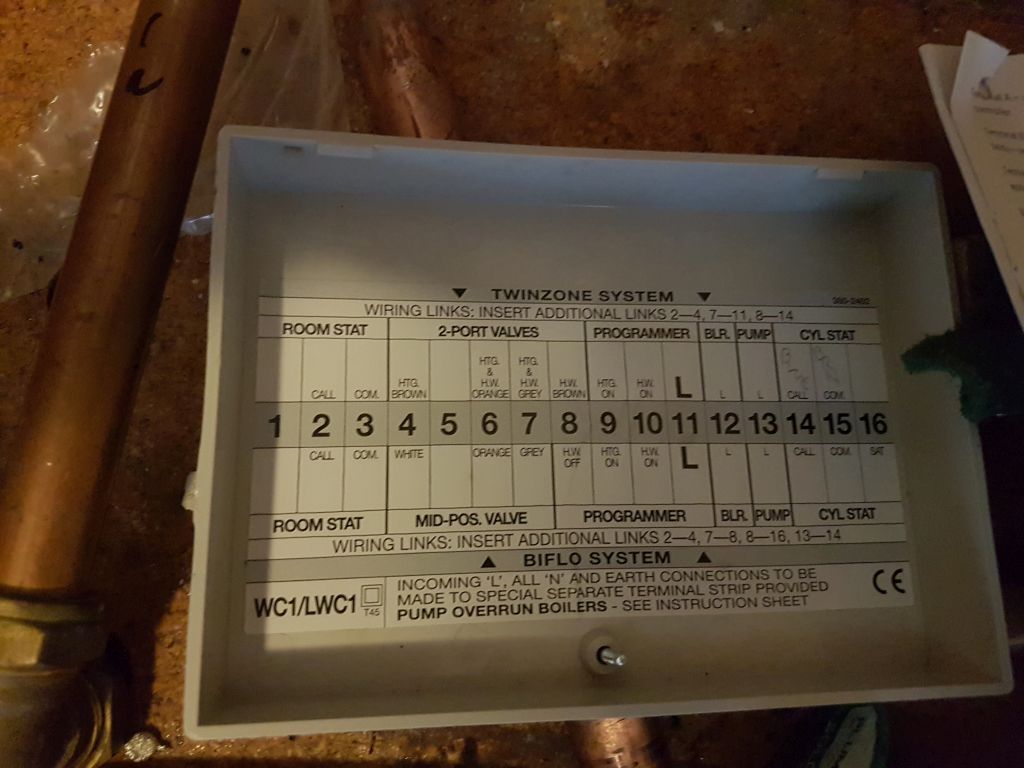

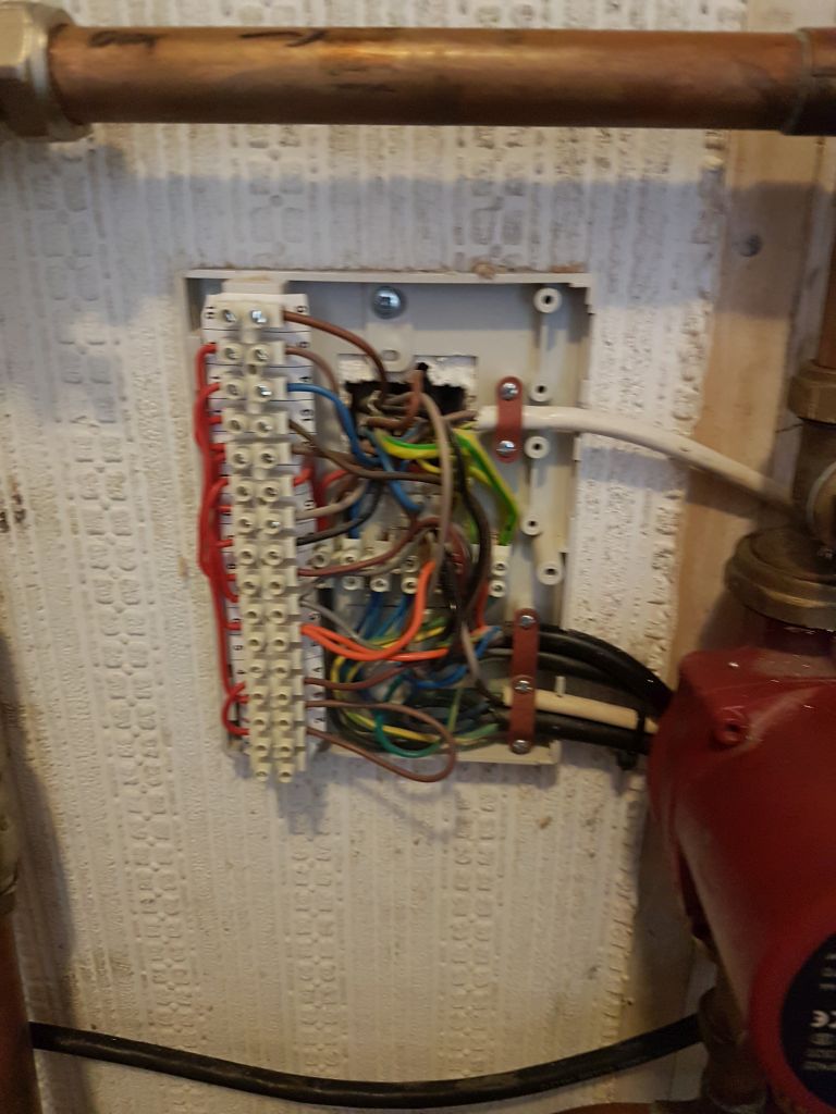

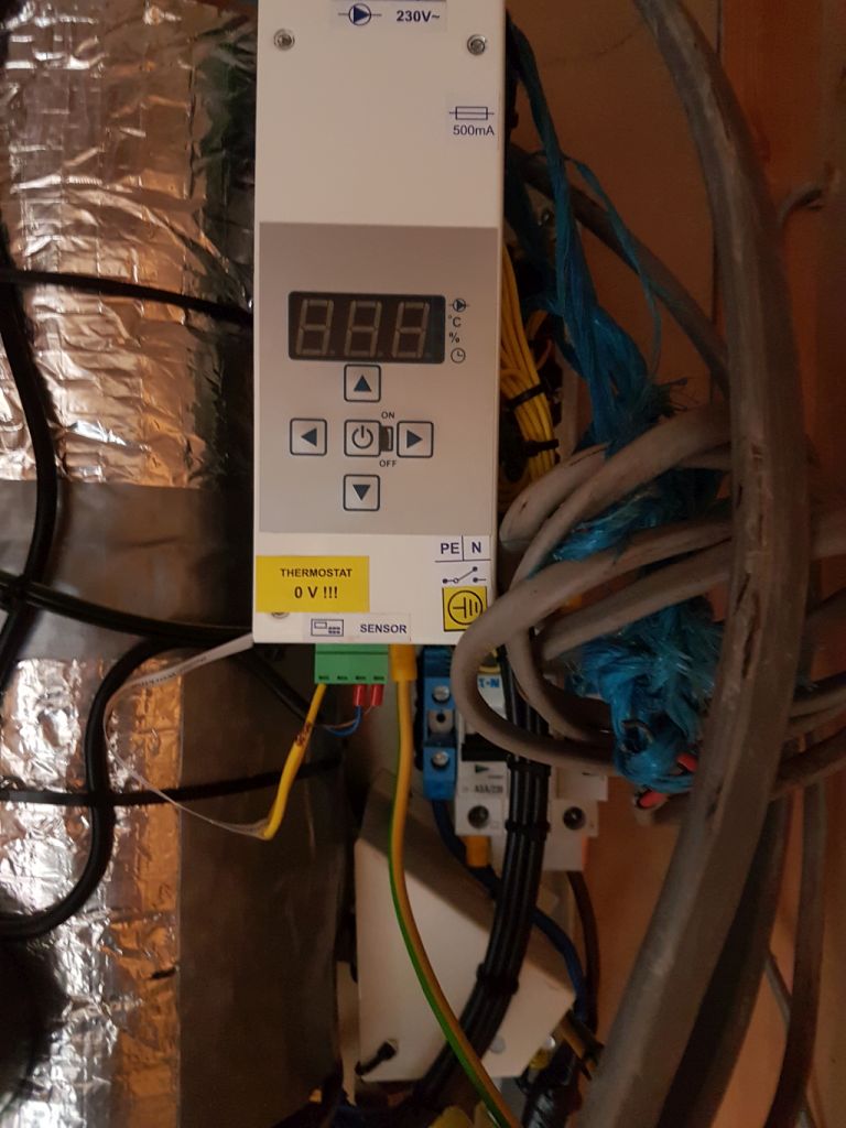

I like the idea of a switch between 2 boilers as only one will be used at the time. There is only one circulation pump and current oil boiler is wires to the junction box. Pictures below.

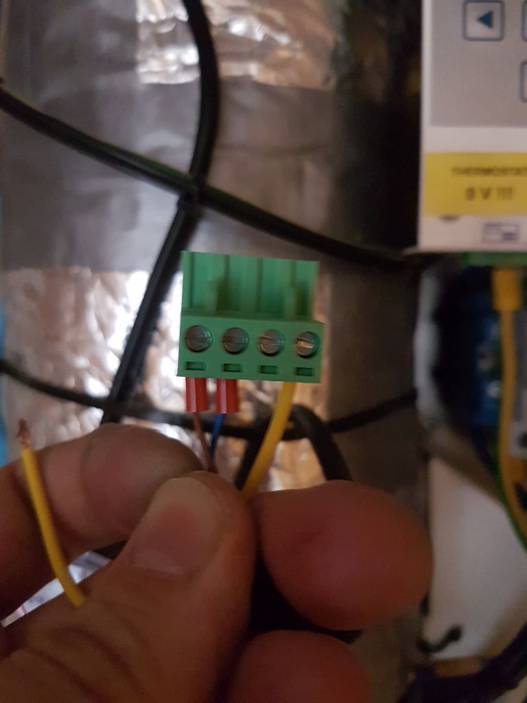

This is an electric boiler inside which has a plug to wire the thermostat. I'm using 2 channel hive for heating and hot water.
Plug after disconnection, has 2 spare terminals
Wire junction box where call and common are bridged together for hive
