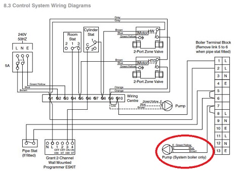

I did. Posted a picture of it. tells me nothing
If you don't like helping people for free I will pay you. Just tell me how to wire it.
I all fairness my plan was to take a wires from hive and connect them to 2 way light switch. Then one switch can operate oil boiler and other electric boiler.
You really are over simplifying it.
Let's start with the real basics. When you propose:
That is completely wrong, it's the motorised valves that control the boiler, not the programmer (Hive or otherwise) The Hive will control the motorised valves. Also, if one boiler has 'voltage free' control, the other has 230V control. Have you determined how are you going to achieve that from the same motorised valves?
And I'll mention it again, if (which you haven't confirmed or denied) your oil boiler is presently controlling the pump. How do you propose to get it to operate when the electric boiler is running?
Drayton used to make an item, RB2 relay which was used to prevent backfeeding boilers or pumps. Essentially, this was 2 double pole relays. A similar unit could be utilised to feed either/or heat source actuated by the throw of your changeover switch. To a competent 'spark', I'm sure it would be a straightforward job.
Will use separate thermostat just for electric boiler.
.....not insurmountable for an electrical engineer or someone with a high level of electrical knowledge / understanding to get around, but will require additional equipment but it's not certainly not straightforward.
If you were to wire a separate thermostat just for the electric boiler, that would start the boiler OK, [your proposed second pump would also have to be connected to it somehow] But the water wouldn't flow to the radiators because the heating motorised valve would remain closed.
1) The heating programmer/thermostat will operate the motorised valve.
2) The heating motorised valve when open, will then operate the boiler.
