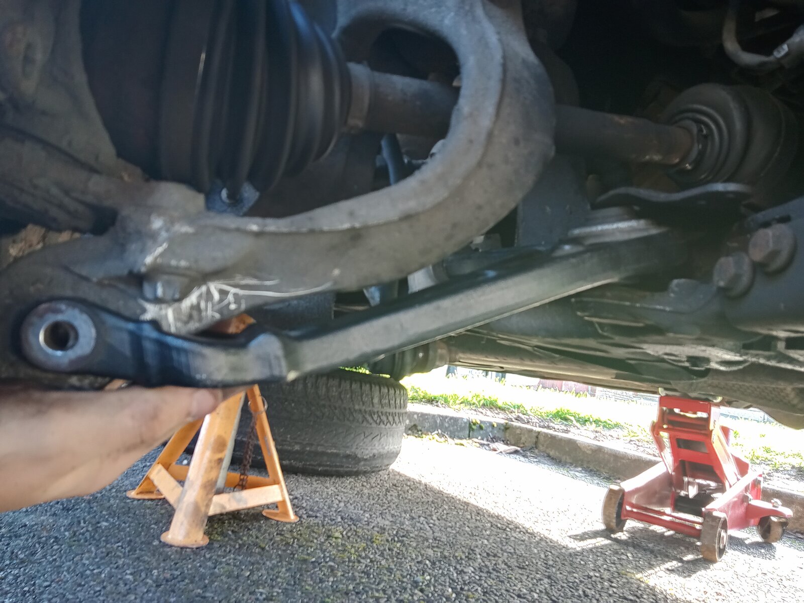

2010 Citroen c5. Things not lining up after trying to refit lower control arm, please help. pics and video inc

How will you move the arm when the suspension is under compression?
everything like driveshaft
Don't remove the driveshaft, and be really careful handling it; if you stretch or bend the CV boots too far the CV joint will drop to bits. At that point you'll either need several hours of patience and helpers to put the joint back together, or you'll be buying another driveshaft

Depends on the setup, in the past I've let the tyre down some so it rolls more side to side, or I've used a clamp to pull it, or to hold the suspension compressed then jacked up again slightly. Sometimes it means everything aligns enough to get a wooden lever into a suitable position to aid the refit. Not dissing your approach of removing the leg- also works but does have some similar challenges like getting the control arm bent down enough to get it back in.
Spring compressors can be very handy for these jobs..
Yeah, some are tight but on those cars, I find lowering the subframe on that side makes it easy.
No, just the suspension strut so that you can fit the wishbone on straight and under no tension.
Thanks but isn't the suspension strut what the brake calipers are on etc and the driveshaft goes through middle of it ?
To remove strut wouldn't I have to take all that stuff off it first ?
Also I can now fit the end fork thing onto hub but middle bolt won't go in it's still not lined up properly

Which part is bush clamp ?
It's the item fixed by two bolts, in the diagram of your first post in the thread. Near the words 'Up in air'.
If the bush is clamped without the car's weight sitting as it would normally be, on it's wheels, the bush will be distorted once it's weight goes back on it;s wheels.

The suspension strut, is the damper, with a spring surrounding it. Likely it will be bolted to the top of the inner wing by three bolts, which you can see when you raise the bonnet.
Looking at your latest pic......
Push the bolt into place (some bolts are tapered at the ends to make things easier) then jack the car weight up under the same spot - the centre bush should then line up.

But isn't the caliper etc fastened to that ? Do I'd have to unbolt all that first ?
John :)
That's the problem, I can't get the bolt through the hole .
Also it was a real pain getting that bolt out, the driveshaft was in way bring directly above it and the bolt has a washer thing at top that is integrated into the bolt .
The jack now seems stuck on other side of car I can't seem get it out .
I'm wondering if would be best to take everything off, driveshaft, caliper, strut etc , then tighten lower arm in place and refit everything ??
