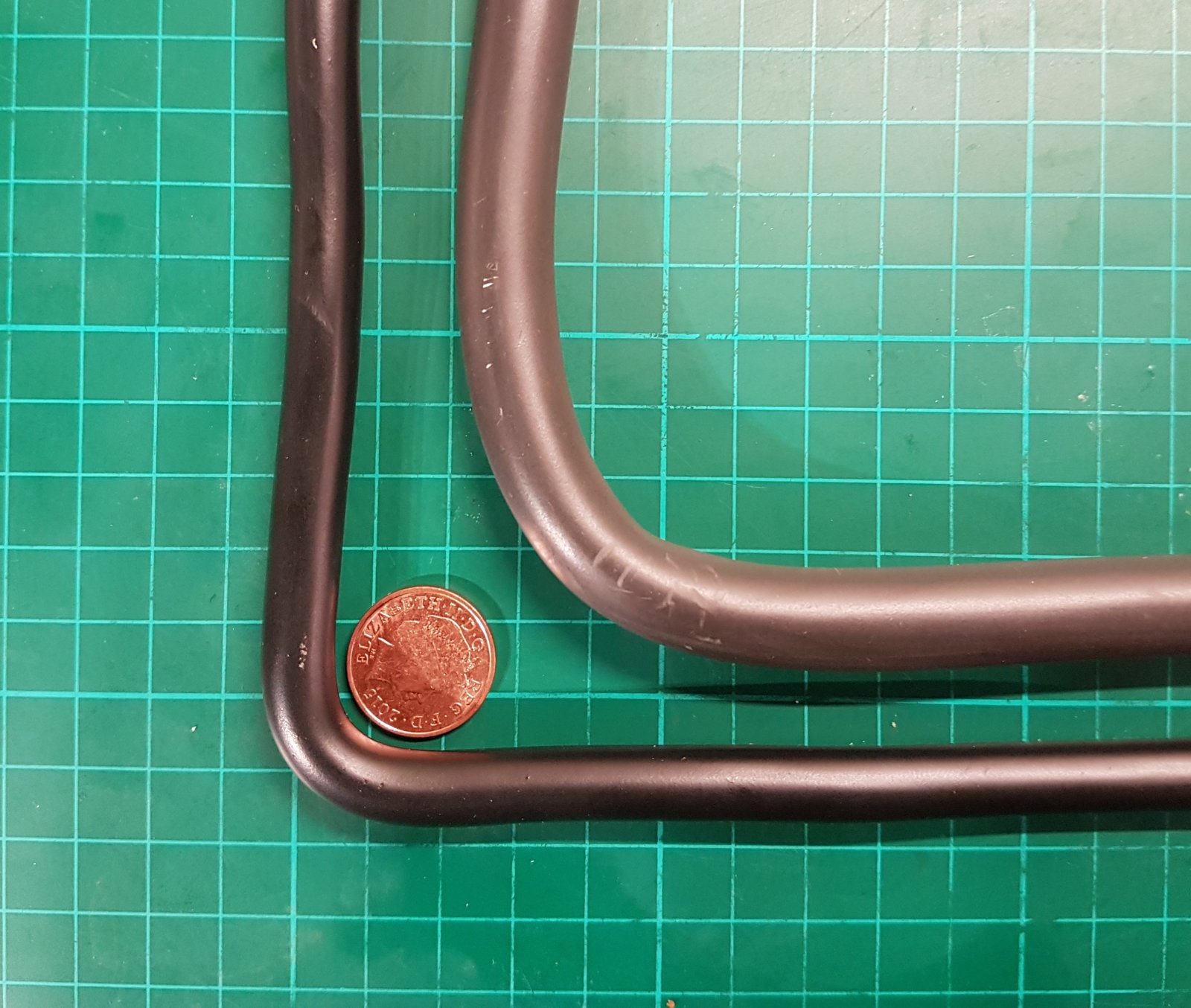

That reminds me, I found the off-cut I was looking for the other day, then forgot why I wanted it! :oops: Anyway... NYYJ vs SWA bend radius, both 3 × 2.5mm²... 1p is a much tighter radius than the manufacturers state though!
There's no way that what TLC sold as HiTuf ~20 years ago would do that (unless, perhaps, one applied a blow lamp!). How much force did you have to apply to get that bend?
I've got some somewhere - watch this space!
Kind Regards, John
