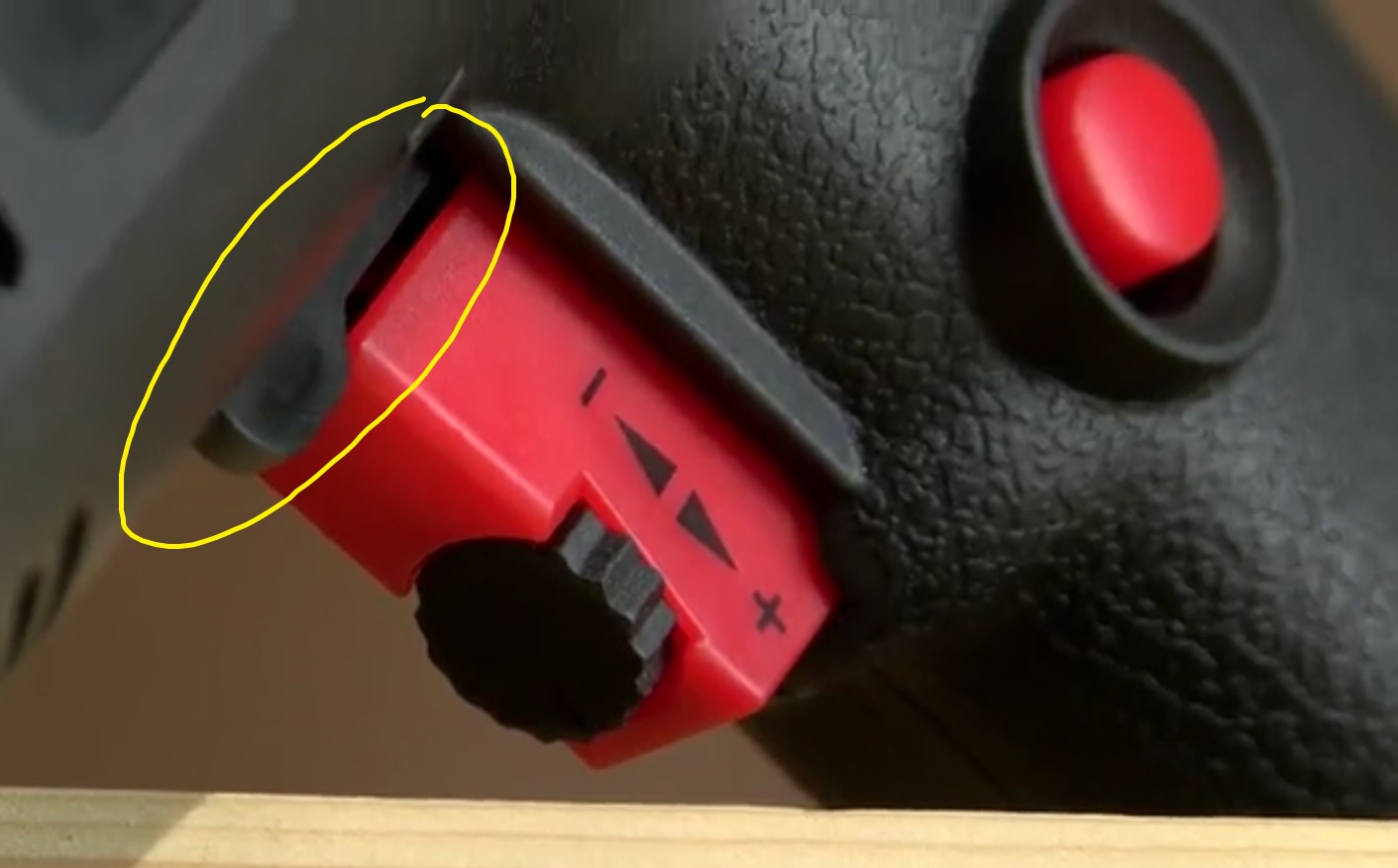

I have a 240v electric drill mounted horizontally on a bench and I need to be able to slow the speed down to quite a slow turn.
It has a small wheel on the trigger to adjust the speed but this doesn’t adjust it slow enough. Maybe its past its best as the drill is pretty old.

I thought I had found the answer at Argos for only £14.99. They have a cheap drill that I could use for this project only. It has a small wheel on the trigger like mine which I thought was to slow the speed down. I then watched a small video clip on the listing where they appeared to imply it was a reverse function so slightly confused about that.
http://www.argos.co.uk/product/7106062
has a small wheel ... ... a reverse function so slightly confused about that.
The wheel is the speed control. The reverse function is this little lever that moves left and right...
