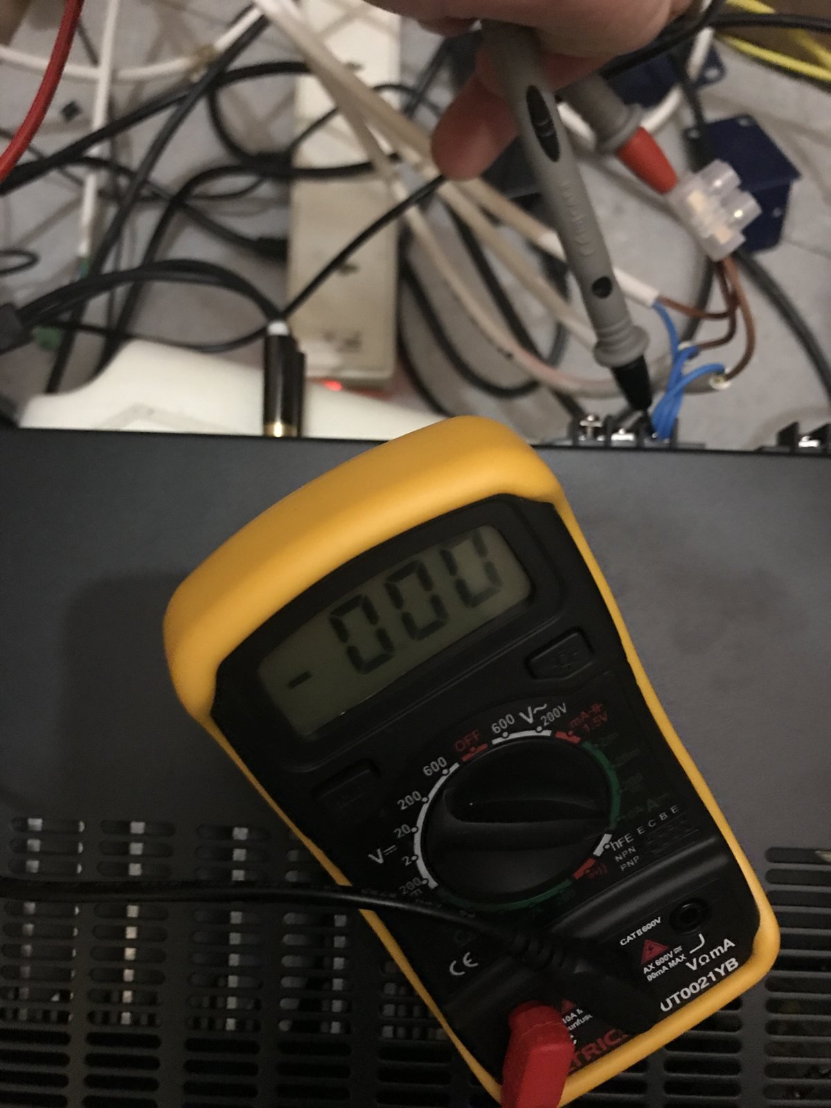

Hi there, I'm now back in the house and have re metered and the following reading are correct with the meter set to 2k. I just wanted to run this by you before carrying out any further test incase it has a knock on.

I've just tried the following test but unfortunately am not getting a read or an output from the speakers..?

Evening I did indeed, see attached. I grouped the browns for the test. Is this correct?
All good EXCEPT the COM probe from the meter needs to be on the 100v terminal of the amp (to complete the circuit), not the COM terminal of the amp :)
Ha, standard chimp error! I've done that now and am getting the test tones but no meter reading :(
Well that's good news. Try winding the thing up to as loud as you ever have it on all the speakers that work- if the meter still doesn't register then either my methodology is flawed or current draw is very low (<200 mA by the look of that meter)
I've done the test again with things cranked up and am getting good sound from the speakers but no meter reading?

Interesting (re the meter not showing any current). Have a read of the instructions, see if there's an internal fuse for the 10A bit, make sure it is in place and intact.
Check your meter instructions, see what it says about measuring up to 200 mA- set it up for that but start out at a low level (200 mA will be the amp delivering 20w so not very loud)

There were no instructions with the meter unfortunately. It was a cheap thing off amazon, I've asked the question on there and will double check the setup.
