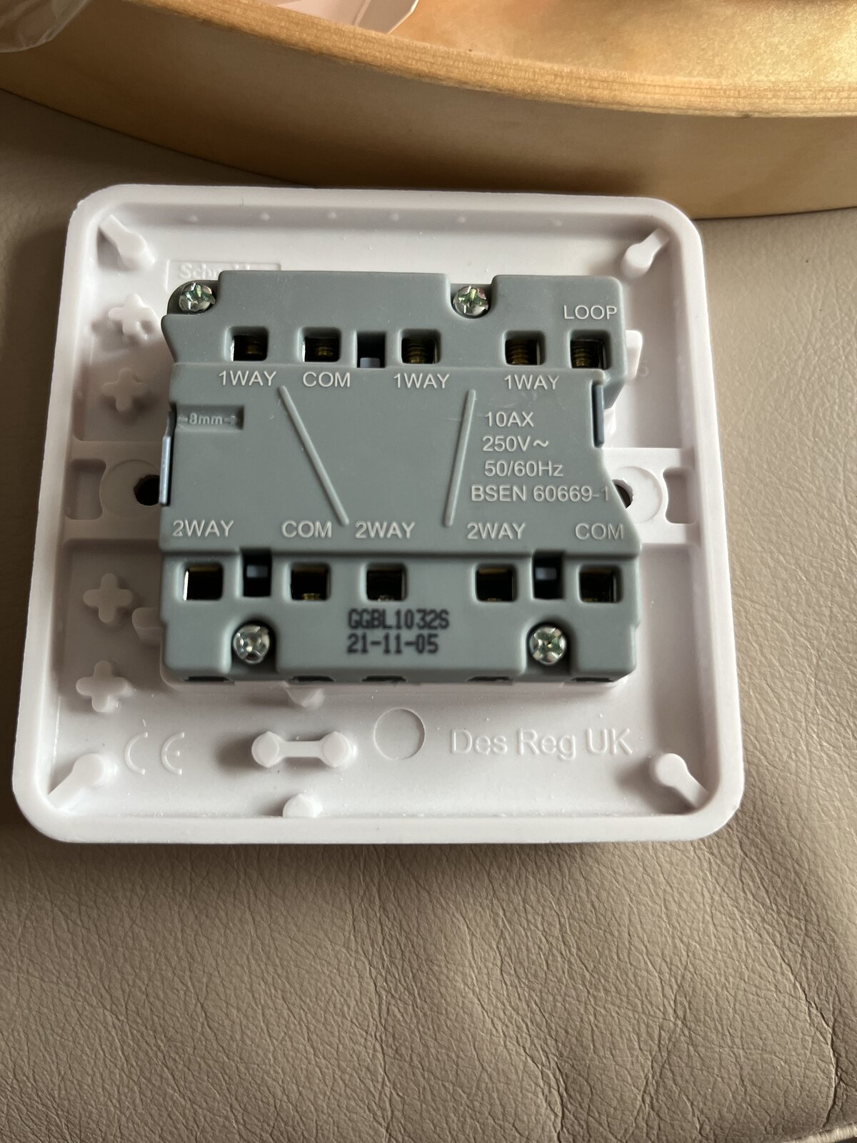

Ok, am scratching my head. Don’t want to call an electrician to change a light switch, as that would be embarrassing…..
I have a three gang switch, all controlling three individual lights. Simple on/off for each one, no complexity with other switches.
I want to change to plastic switch, so bought a lisse three gang switch, hoping for a simple, three wires into each at the top, into three out wires at the bottom. How wrong I was!
Looking at this, would I be correct in thinking the following.
From left to right.
S1 - live in at the bottom com, out at the 1 way at the top.
S2 - live in at the top com, and then also out at the top.
S3 - live in at the bottom right Com, and out at the top 1 way?
Feels weird but thought best ask….
I do need to also check the back of the existing switch, but that’s for the weekend when I can turn off the electric without incurring the wrath of the offspring for interrupting his evening gaming sessions

On each switch you need com and 1 if that is how they are labelled. It does not matter which way round, so you could have all your lives in the top and all your outs in the bottom.
Ta! So guessing my guess is right, the way they are segmented by lines on the back, shows the switches? So the middle switch has com and 1 at the top?
Daft markings - and unusual positioning.
If you connected COM and 2WAY, it would still be a one-way arrangement though you would think the switch rocker was upside down.
Plus - for two-way switching COM, 1WAY and 2WAY would all have wires in them.
Of course, if the whole switch was upside down and you connected all of them COM and 2WAY, it would be the same as COM and 1WAY is now.
