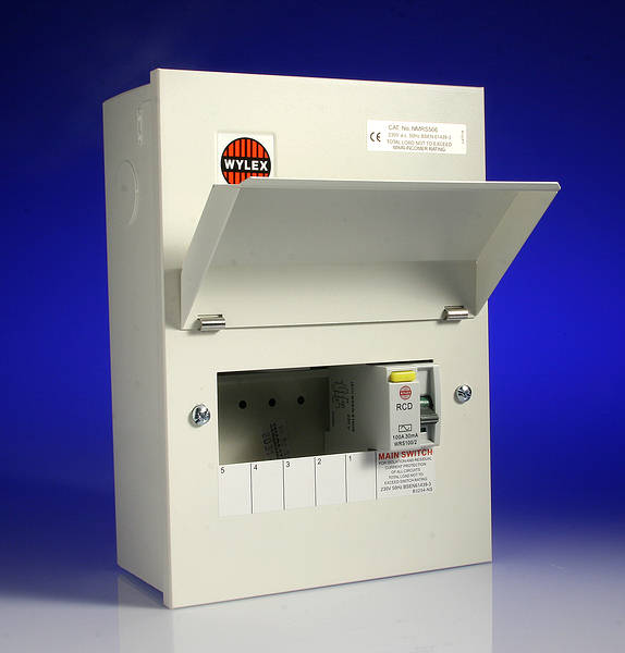

I have looked at one of these Wylex 100amp CU with RCD (£50), I think it would look good in a small workshop looks somewhat commercial.
But would go for whatever setup is cost effective!

Possible but not something that is desirable, necessary or to be recommended. ... If you only want a few circuits, a 2 or 4 way 3 phase board would be a far better option, those would provide up to 6 or 12 single phase circuits and still retain the possibility of one or more 3 phase circuits as well for the inevitable day when some new piece of 3 phase equipment arrives. ... For metering, a meter is installed. A 3 phase one in the supply to your new board.

Existing 3 phase supply -> 5 core cable -> 3 phase meter -> 5 core cable -> new 3 phase board which can have a selection of single or 3 phase circuits connected.
Meter registers total energy used for the new board regardless of what circuits are in it.
As I said previously - this is a very simple, everyday installation. It's just a sub board with it's own meter. Thousands of similar installations in commercial premises everywhere.
Existing 3 phase supply -> 5 core cable -> 3 phase meter -> 5 core cable -> new 3 phase board which can have a selection of single or 3 phase circuits connected. Meter registers total energy used for the new board regardless of what circuits are in it. ... It's just a sub board with it's own meter.
Indeed. I misunderstood, and thought you were suggesting that the entire installation (including the OP's single-phase circuits) should be fed from a single 3-phase board (which is why I said that was probably what they already had).
In that case, if I now understand you correctly, the only difference between your proposal and the OP's is that he proposed a 3-core (L,N,E) feed from one of the three phases feeding (via a single-phase meter) a single-phase sub board containing single phase MCBs for his single-phase circuits, whereas you are propose a 5-core feed (via a 3-phase meter) to a 3-phase sub board which (currently) would contain single-phase MCBs for his single phase circuits. Is that correct?
If so, I agree that your suggestion would represent theoretical 'future-proofing' but if the OP is certain that he will never need any 3-phase circuits, it presumably would not offer any advantage? Whilst nothing is impossible, if he currently estimates his 'maximum machinery load as 2-3kW, it would seem that he is probably right in saying that he is never likely to need 3-phase loads.
