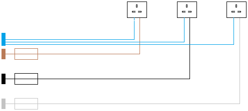

Ooh, interesting one. I assume you mean you have a 3P circuit which you don't need to run anything 3P - so you stick (say) 3off BS1363 double sockets off the end of it, one per phase, all sharing one neutral.
As long as the phases all share a linked protection device, then I'm not sure there would be anything against it. You could not have spearate protection (i.e. 3off single phase breakers) because you are not allowed shared neutrals like that.
The only thing I can think of would be the requirement to provide segregation of circuits so as to minimise danger or inconvenience when one of them trips - in this case, if any of the 3 loads causes the breaker to trip, then all 3 will go off. However, since this is likely to be a radial, you could argue that it's not like having all the sockets in your house on one circuit - there are likely to be other sockets around - and in any case you aren't going to lose your lights.
In some ways it would be better than 3off single phase radials of the same characteristics. As long as more than one phase is loaded, the volt drops would be less than with separate circuits - and of course it uses less copper, could be 5 cores vs 9 cores for separate circuits.

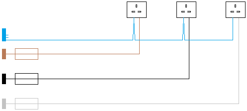

A sub board is considered to be a 3ph load and may be fed by 3 fuses or 3ph MCB and a common neutral.
At that point onwards single phase circuits with their own phase and neutral wires are not considered to be sharing a neutral as in this:
This is not permitted unless the OCD is a 3p MCB:

A sub board is considered to be a 3ph load and may be fed by 3 fuses or 3ph MCB and a common neutral. ... At that point onwards single phase circuits with their own phase and neutral wires are not considered to be sharing a neutral as in this:
Indeed - and that's what I thought Simon was talking about (hence my comments/question) when he wrote ...
In in other words, I assumed he was talking about each circuit (corresponding to each of te single-phase breakers) having both L & N going back to the DB
This is not permitted unless the OCD is a 3p MCB:...
Agreed, but I don't think that's peculiar to 3-phase setups. Even if it's a single-phase board one cannot have a neutral shared in that way by multiple final circuits - and, 'allowed' aside, it won't even work if one has RCBOs or some of the circuits sharing a common RCD.

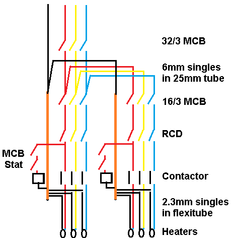

I had an interesting situation a while back correcting following an EICR. I was sent to site with a drum of 2.5mm² blue and had to make phone calls to find out what the problem was.
3ph board, 32A MCB, 6mm² singles in 25mm steel tube looping in and out to 2 small steel enclosures containing 16A MCB, 4P RCD and contactor plus a smaller sp mcb for thermostat. load side of each being 3x flexible 20mm steel tubes with 2.5mm² singles to an immersion heater, six in total in 2 chillers to stop freezing.
I could see nothing wrong with the set-up and I certainly wouldn't have started installing blue neutral wires with the existing old colours.
The SP MCB may have come from the live supply

Yes, it is indeed. The twist here is having 3 phases and (we assume) 3 poles on one MCB. Some might be tempted to swap out the 3pole MCB for 3 single pole ones - which as already mentioned would be non compliant.
As I said, it's really just a specific instance of the fact that (even with just one phase, let alone three), one can't have two 'circuits' (suppled by two different OPDs) sharing one neutral.
I'm not convinced that the situation you are envisioning would be at all likely to arise in practice. If one started off with 3 single pole MCBs (hence '3 circuits'), one would naturally have separate L & N for each circuit running back to the DB. If one started with a 3-pole MCB, supplying all the loads (maybe with a 'common neutral'), each with one of the three phases, I really don't see why one would be 'tempted to' change that the 3 single-pole MCBs, possibly creating the 'non compliant' situation you mention - and, even if one did, for some reason, succumb to that temptation, one would hope that consdieration would be given to what changes might be needed to the neutral wiring!.
