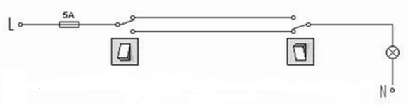

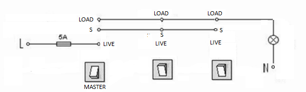

This is what you have at the moment:

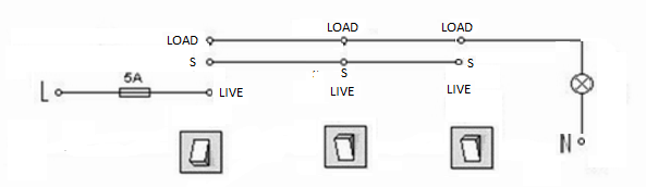

and this is what you need:

Take no notice of the 5A - I should have erased it.
It doesn't matter which colour you use for Load and S as long as the switches are all the same.

If you're going to try that, you want to do this:
Double Switch (Master)
Live - Red from common
Load - Red
S-Link - Black
Intermediate Switch (Slave)
Load - Both Reds
S-Link Both Blacks
Third Switch (Slave)
Load - Single Red
Live - Red (from T+E)
S-Link - Black
You're using the blacks from the T+E to connect the S-Link, the red from T+E to connect the Load, and then the live is just fed from the switch by the front door. The lamp is then connected at the third switch (with the red on it's own)
Do let us know how you get on

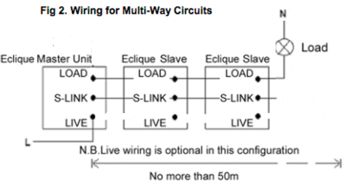

so looking at that I would just put 1 live (I presume red) into 1st (master) then in the other two just have neutral (I presume black) through the load, but how would I connect the s-links?

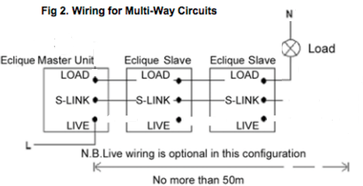

3. The dimmers will only work as per the diagrams
You can try returning the dimmers for replacements, or you can acquire a bit of cable to temporarily test the correct wiring as per the diagram and see if it works
