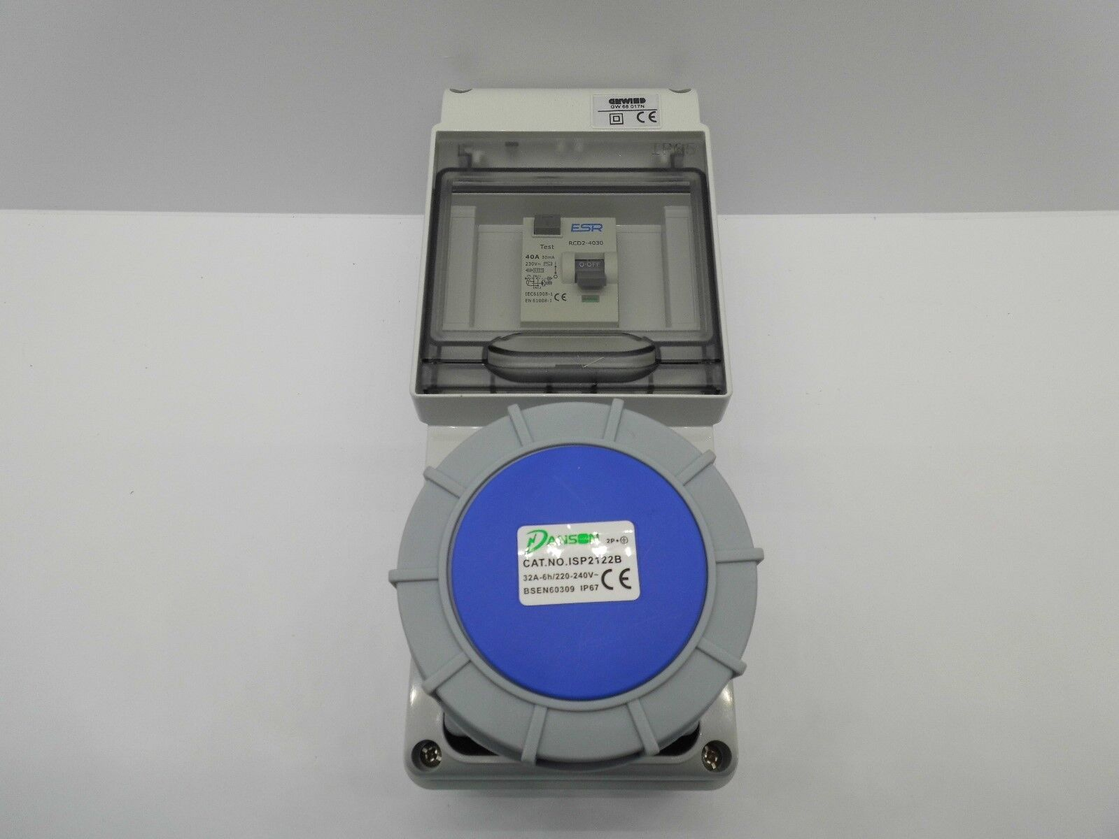

I assume there is RCD in there somewhere or RCBO (a picture of your consumer unit would be handy) and on that basis I personally would suggest something like this;
fitted with a 2 pole B32 MCB where you need it would be your best option. The next thing would be feeding the cable to it and quite honestly if the existing cooker feed is at least 6mm² (minimum for 40A MCB) I don't think any rules would be broken to simply connect this to the live side of the cooker switch. Even if the mixer is running there will be >4KW left for the cookerwhich will probably be plenty for 'everyday use'.

it sounds like an interlocked switched socket such as
would meet the regulations.

It would - but it would probably be a pretty 'chunky' (and probably not inexpensive) thing.
Reading this thread ................ It sounds like an interlocked switched socket such as ....... would meet the regulations.
AS you've probably seen that is open to debate. In terms of electrical common sense, it probably offers at least as much protection as does a shuttered socket, but, strictly speaking, one probably cannot get away from the requirement of the regs for a shuttered socket (without suggesting that an 'interlocked' one is an acceptable alternative).
