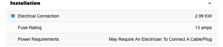

The info says
So, @Angela Robertson , the best option is to change the wall outlet to a standard single 13A socket, and connect up a cable with a 13A plug on it.
