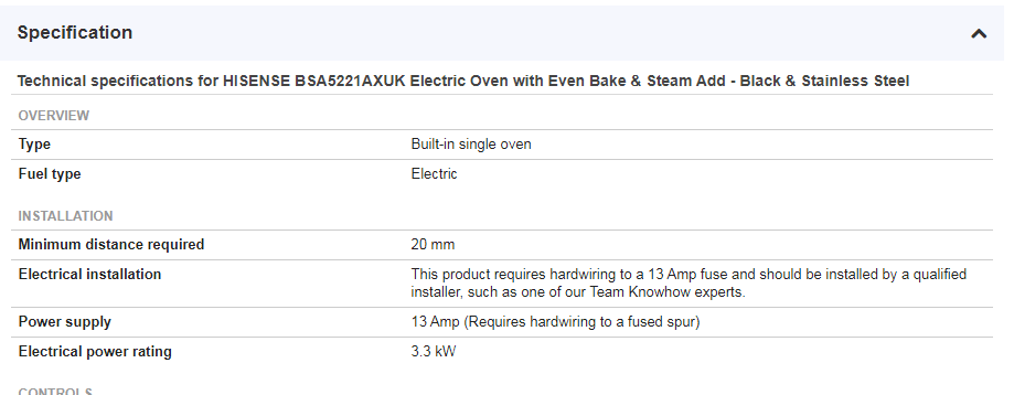

Using pre installed cooker circuit for 13amp or 16amp oven.
As there is absolutely no difference between an FCU and a socket and plug, it surely - for sale in the UK - should be supplied with a moulded plug on the flex if suitable.
I suspect that they can wriggle out of the requirement to fit a plug (for sale in UK) by saying that it "requires hardwiring"?
You will note that it states "Power supply" [not fuse]- 13A. (Requires hard wiring to a fused spur) - This must be written in the UK because of the incorrect use of 'fused spur'.
Indeed, but I suppose by saying that it requires a "13A Supply" and a "Fused Spur", this means that the "Fused Spur"/FCU has to ciontain a 13A fuse.
The other one states "Power supply" - 16A (Requires hardwiring to a dedicated circuit) - This appears to be the normal for appliances in Europe.
Indeed - which is why I offered the suggestions and asked the questions above. However, we now know that the model numbers of both include "UK", so presumably even the second one is intended for sale in the UK - which makes it even stranger.

This from the first link above:
as they are both quoted at 3.3kW something is not right,
Yes very confusing both 3.3kw but saying to connect different ways.oven came with flex cable but not socket on it so was wondering would it be ok to hard wire straight into cooker connection plate and drop MCB to 16amp just wasn't sure the 1.5mm flex cable supplied would be ok in 16amp?

As I, and others, said before, 1.5mm² cable is OK for a current of around 16A (figures vary slightly according to source) - so would be OK.

If you really want to address this issue in a very 'strict' way, then there's probably nothing much to choose between changing the MCB and changing the cable.
I certainly don't think you should be concerned about the difference between 15A and 16A - you've already been told that there are slight differences between tabulated ratings, but the rating for 1.5mm² flex is definitely "about 15/16A".
