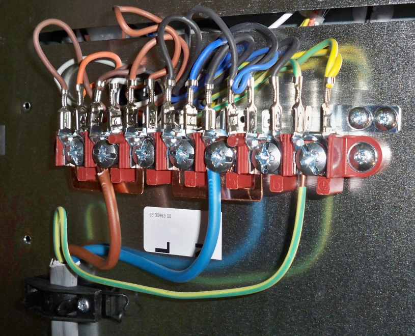

Here is a picture of the connections to a very large (in physical size) 15kW range cooker for which the manufacturer's instructions (wrongly) stated that it must have a 45A MCB on the circuit.
You will note how small the internal wiring is - the same as all cookers/ovens.
