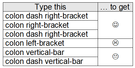

Probably not as old as me ;) However, if you click on the one at the top of the message composing window, you'll find hundreds of emoticons to choose from. Alternatively, if you prefer to 'just type', then type (after a space) 'colon dash right-bracket' and you'll (sometimes!) get a choice of about three, the first of which is a wink, like this ;) More generally,, try these ...
