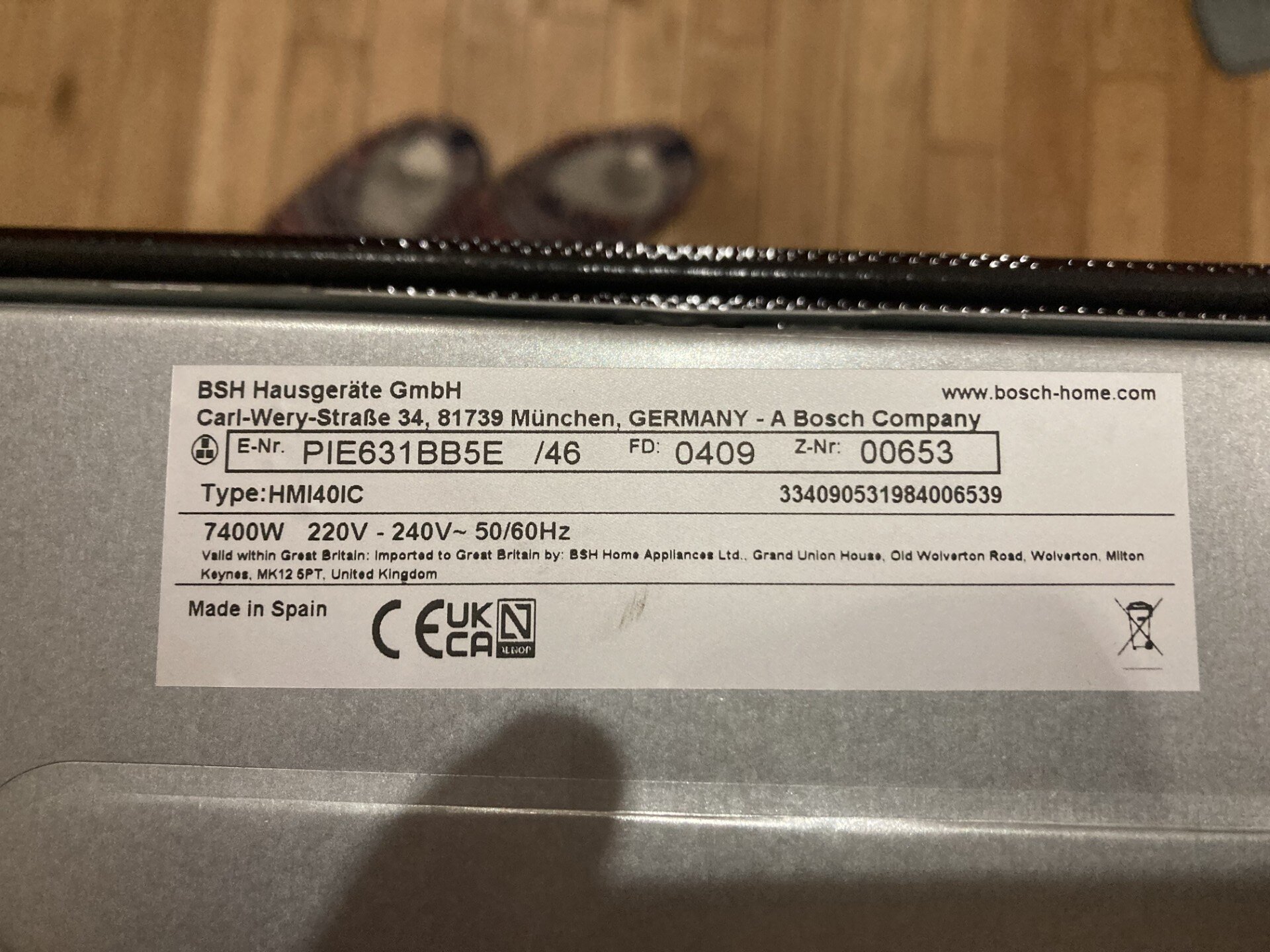

Still awaiting a photo of hob's spec plate. Thanks for the info.
Are you sure it is 2.5mm²?
That would be very unusual with a 30A rewireable fuse - although as it is half way up the wall presumably it has been altered before.
We need more details of the hob.
Finally got the specs. Looks like it's 7.4 Kw. Does that make it approx 30 amps?

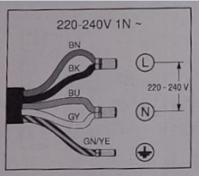

https://www.bosch-home.co.uk/en/product/00636260 appears to be 5 cores of 1.5 sq mm each from my reading of the description.
They sell a longer length and, if desired, one could get an equivalent to run through that conduit to the switch and avoid another connection point?

Should we use a 30 amp standard junction box to connect the hob's 5 wires to the 2.5mm (currently terminates in a standard single socket) T&E behind the hob's base unit? Or something else?
