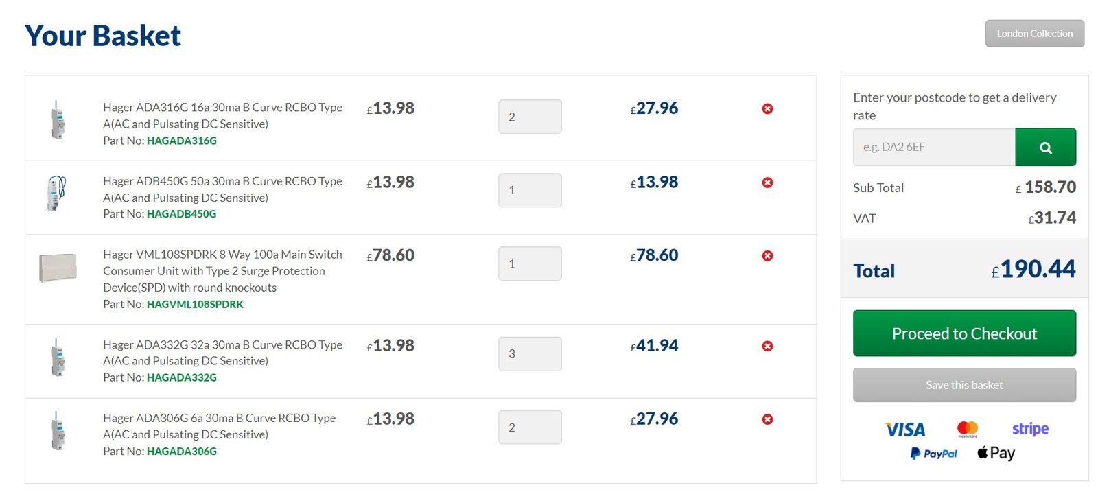

Hello
In process of collecting some Hager RCBO to update my CU.
I am purchasing some miniture Hager ADA306G, ADA316G and ADA332G. I have a 10.5K shower on 2m of 10mm clipped cable. That Hager range don't make anything above 32A but seen a few different models available ADN150, ADB450G, ADA145G.
I am guessing I can get away with minimin 45A as last resort. but not sure which model is best suited to the ADA3 range.
Any feeback will be appreciated
For a 50A RCBO, ADB450G is the current product.
ADN150 is an obsolete Type AC. ADA145G is a 45 amp item which is also obsolete, replaced with ADB445G

Due to the limited space I have decided on this CU..So gradually buying brand new boxed RCBO from ebay when I spot good deals.
So far got hold of 2 ADA316G. Same seller had 3 ADA332G but sold very quicky.
