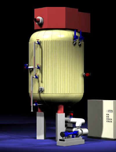

Here's one for you:
That one's only 25MW - they can do you a 60MW if you prefer. You do have a 10kV supply, don't you? :LOL: :LOL:

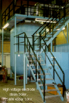

I'm sorry - I may have suggested an inappropriate product. The drawing above doesn't really give any indication of scale, but elsewhere on their website they have a photo which does:
hope you're not disappointed..
So, enough for a couple of baths and a load in the WM, then, Ban???
I leave it as an exercise to the reader (i.e. anyone who can be bothered) to work out, assuming 100% efficiency, how many 300l baths could be filled per second with water raised from 10C to 40C in a 60MW boiler...
