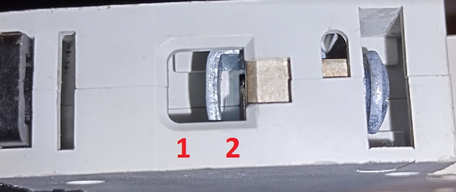

I different contractor attended yesterday. Tried yet another MCB, the buzzing was still there. They said it's a 10mm cable (not 6mm), and that the MCB was probably getting close to it's limit (40amp MCB, shower pulling between 37-39amp) and causing some kind of vibration. The vibrating stopped if you lifted the MCB slightly so it's fixing hook was tight against the bracket it attaches to.
They installed 50amp MCB and the buzzing has gone.

What brand is the distribution board/MCB's? you wouldn't expect a 40A mcb to chatter even if it was drawing a little more than 40A
BG MCBs can be installed incorrectly so that the connection to the busbar isn't clamped under the terminal.
Should be in position 2 in the image, but can be installed with it in position 1 which will result in a poor connection, overheating, arcing, buzzing and whatever else.
The installation of another 50A MCB may just have coincidentally connected to the busbar properly and the previous ones were not.
Better quality devices have an additional metal tab on the moving cage contact so that incorrect installation is impossible.
