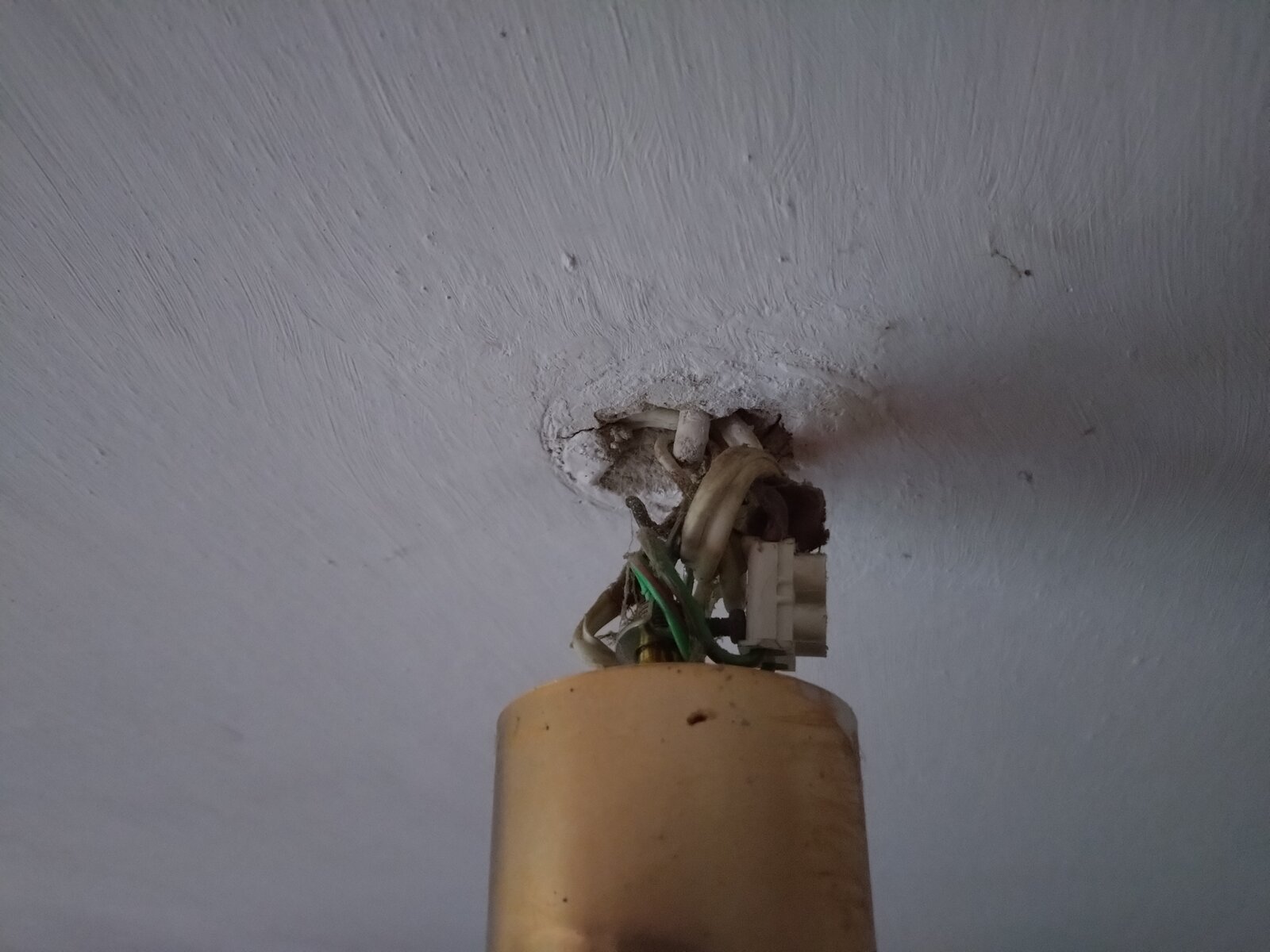

So i have this annoying problem i have no idea how to deal with best. What i really want is to replace old hook type ceiling lamp to a new led type one .
Problem is mounting , the old one is so old , so it has no electric box neither any mounting parts , just got to hang on wires . Added a picture below. All i want to is to replace this contraption to flat one mounted with screws . Any suggestions ? Thank you.

Look through wire hole and see which way joist goes.
There should be one going across near hole.
Draw pencil line across on ceiling to mark so you know where to fix new light screws...
Is that what your asking?
Usually the new LED light will be screwed to the ceiling and the cables go straight into the light. Don’t cut the hook unless you absolutely have to, someone might want a pendant fixture again in the future. Make sure you don’t hit the cable drilling the holes for the new light.
The ceiling could well be concrete, in that case no joists to be found.

Thank you for quick response , i forgot to mention that ceiling is a pure concrete , so there is no joist , would be way easier to fix it without trouble.
It is possible to drill into concrete ceilings to mount light fittings.
However, one must be careful not to drill into cables/conduits lying just below (above !) the surface of the ceiling.
Usually (?) it is possible to determine the direction in which any conduit/cable is going
and
avoid this "zone", when drilling.

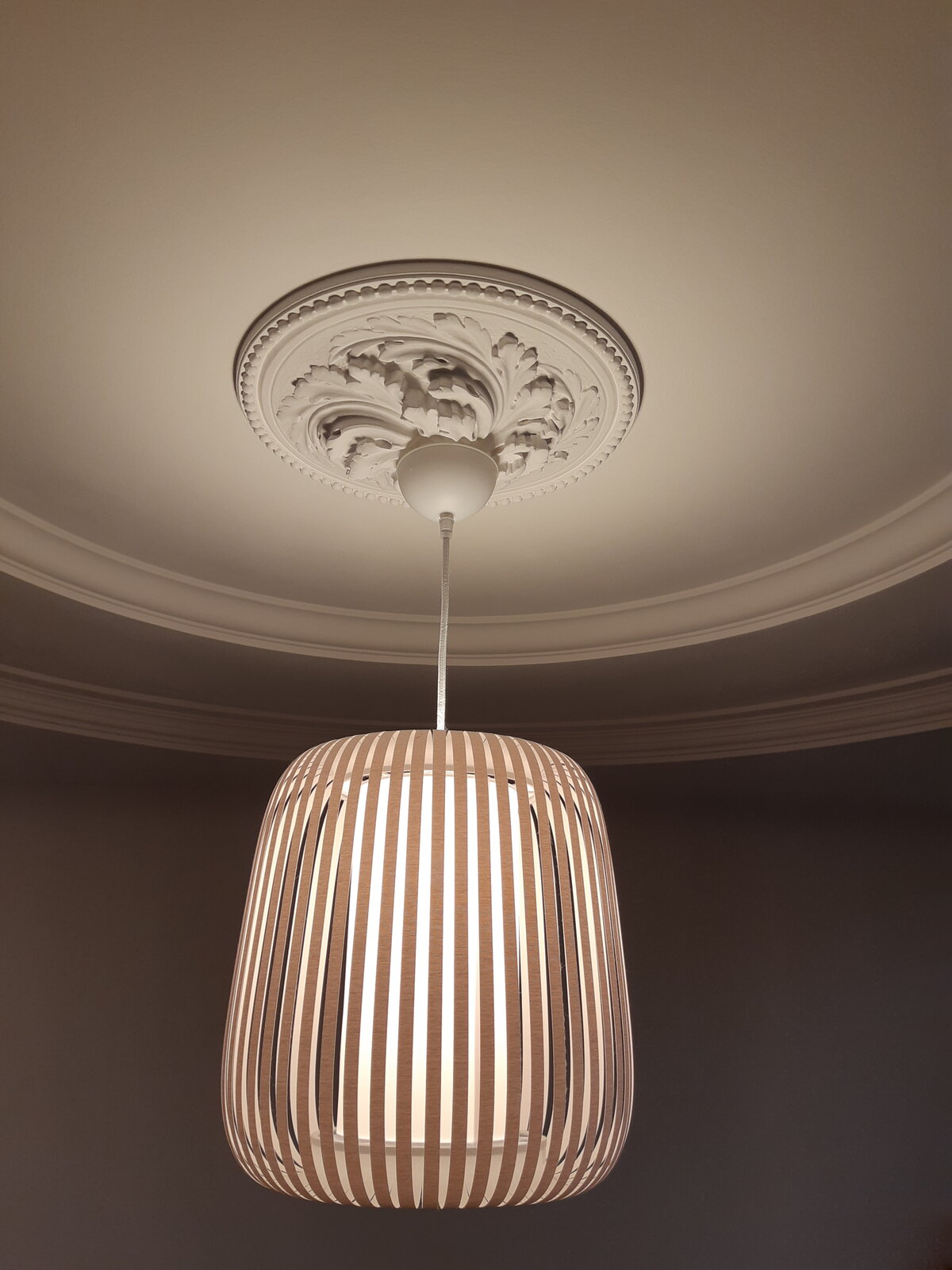

We have these all over our house and it is very difficult to put a fitting that has to go flush with the ceiling because:
a) 99.99% of the time the wires are stiff and you can't manipulate them to fit in the fitting and get it flush and
b) the hook is in the way of any modern fitting
We gave up and just used a suspension kit that has an integrated piece of plastic that hangs on the hook and allows you to choose any bulb/lampshade combination that you like. It is still a massive pain to fit, but once it is on you can at least change the bulb/lampshade when you want.

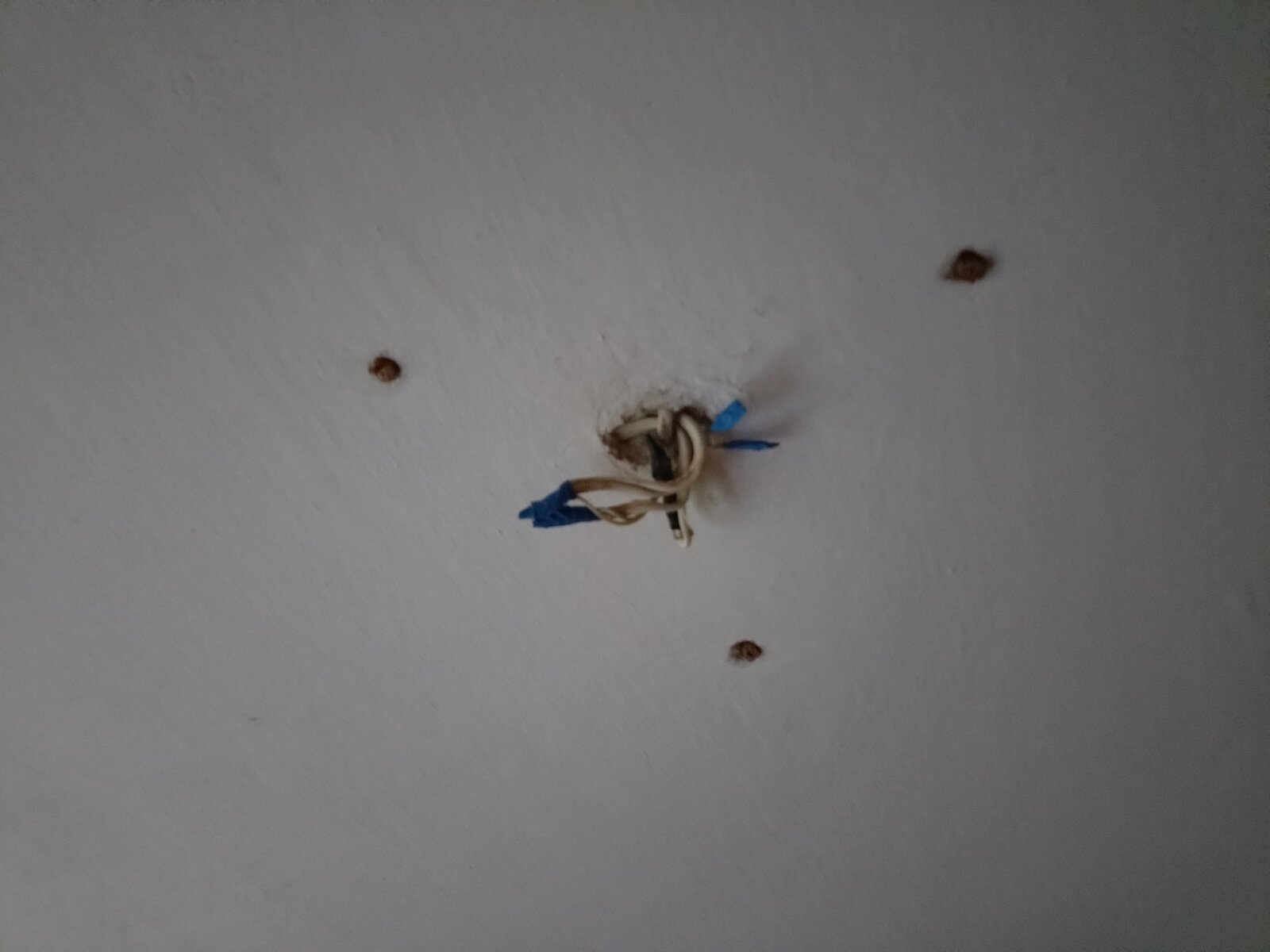

So I decided to go with drilling. And boy it was a nightmare. I have no idea what those old buildings were made of, but every time I tried to fit plastic fixing parts, lamp comes with, those just pop out . Three sizes of drills and effect is the same, concrete, if this even can be described as such, crumbles and becomes unfit. Now I don't have a modern lighting, don't have a old lamp hanging over and don't have any clue how to better fix this. It's a nightmare.

Once again, Epoxy Resin can be your friend.
You have drilled the holes.
The "material" into which you have drilled is "crumbling"
and
"Plastic Anchors" will not stay in.
Place a disposable cover (e.g. Newspaper) over the floor underneath - to catch any "drips".
Internally, cote the "crumbling holes" liberally with fresh correctly mixed epoxy resin,
cote the (just long enough) "Plastic Anchors" with the Resin
and
insert them into the coated holes.
Apply "Sellotape" (or the equivalent) to hold the anchors and epoxy resin in place, while the resin sets.
If you have mixed the Resin correctly,
after the "setting time" (which may be 24 hours) you will have very solidly set anchors - which certainly will hold up a "Light Fitting".

An old trick is a tube of plaster repair filler, e.g. Moltofill. Squeeze in as much as you can and push a regular plastic plug into the goo. Wait for a few hours and fix whatever you want to fix. Works 90% of the time unless you‘ve got extremely crumbly bricks or soft mortar.
