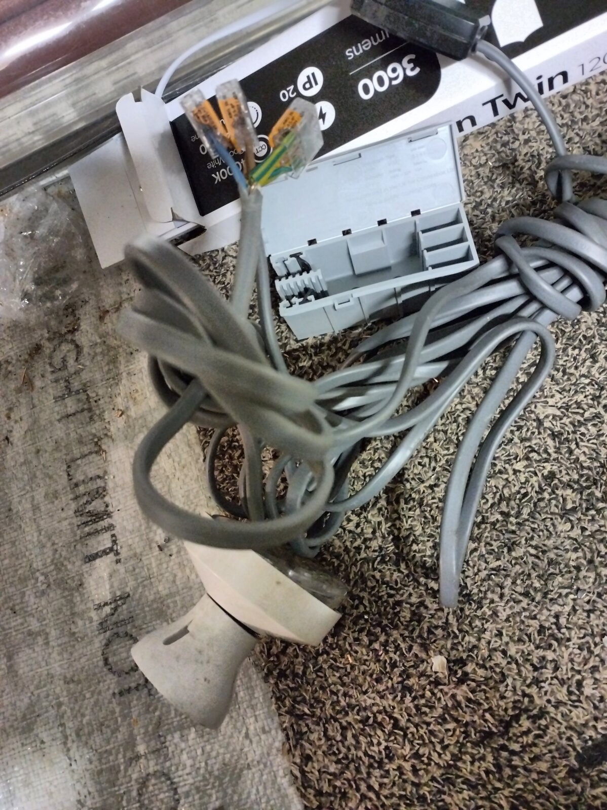

However, can I stick a plug onto the lighting rig and plug it in the mains to test it all works? I assume these battons or these battons can be plugged into the socket mains to test the connections are working? (or will their internal wiring and fuses break as as lighting circuits are lower tolerances)?

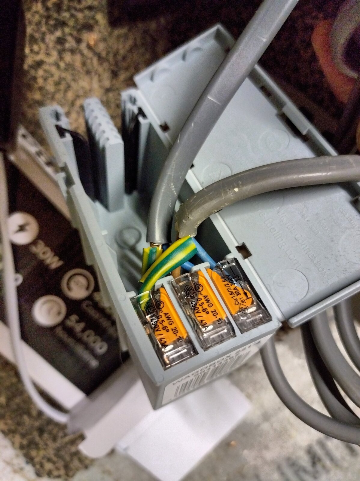

This is the setup
Connection to the large light

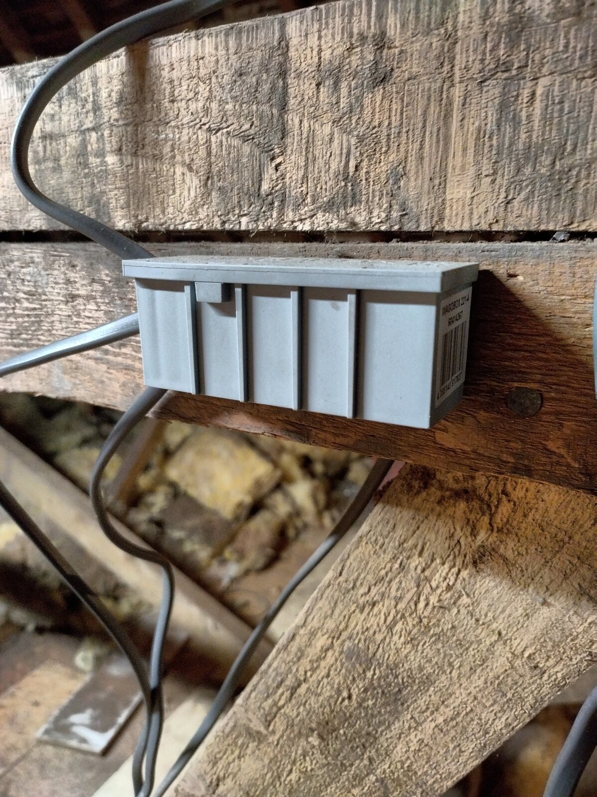

Split connection being the wago box to the two lights.
But, Does anyone know how I get the wago connectors out of these box slots? I pushed them into the slots and can't get them out now.... am I missing a trick?
Got -em out with plyers and a lot of yanking - crazy design.

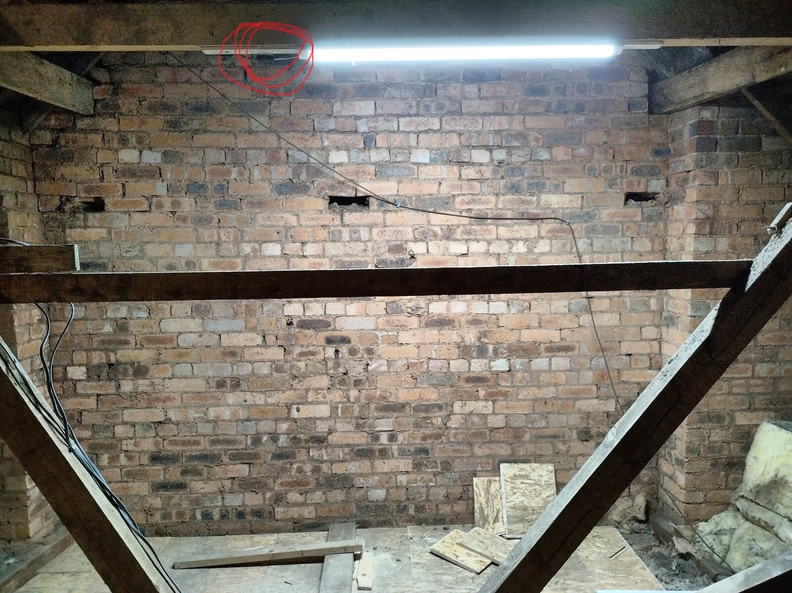

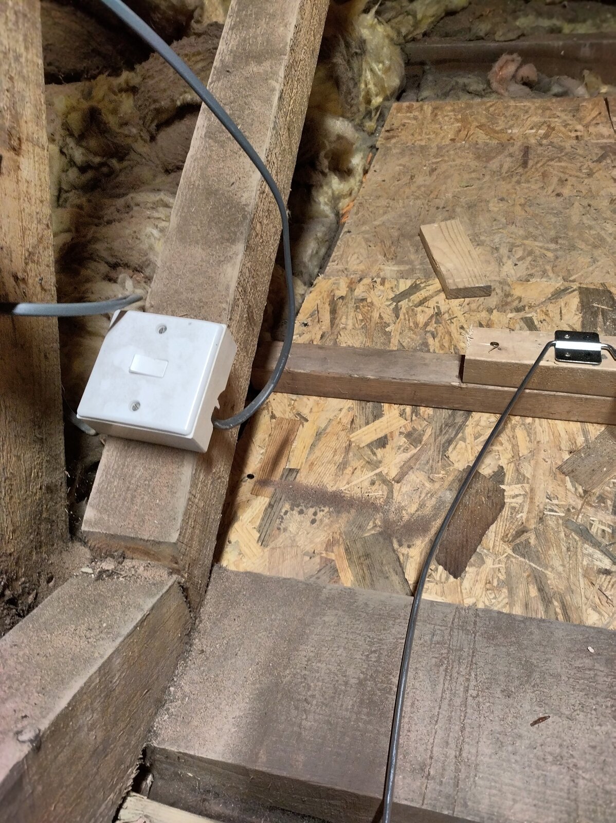

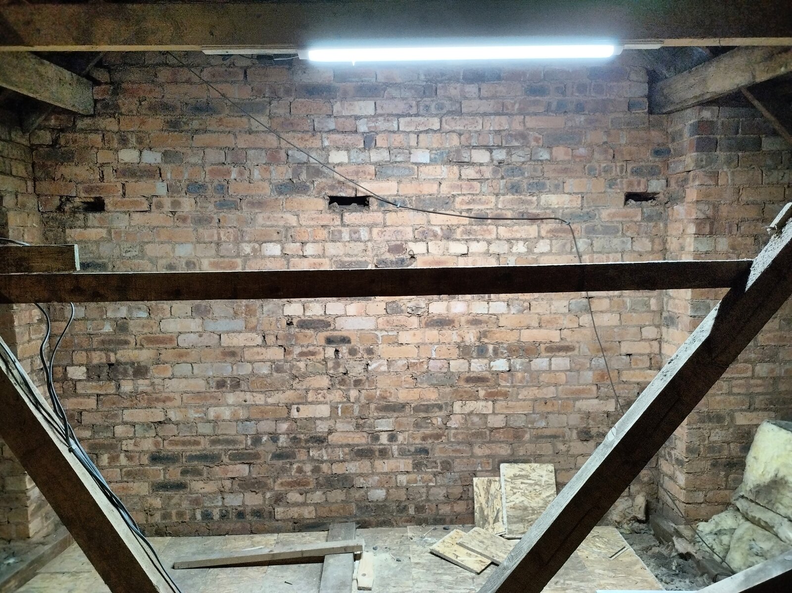

Loft lighting project went well. Thanks to the suggestion of the tube. Light and floor coming along. Will upload some pics. Fanks to the contributors for setting me straight(!)
The LED batton made all the difference. Highly recommended.

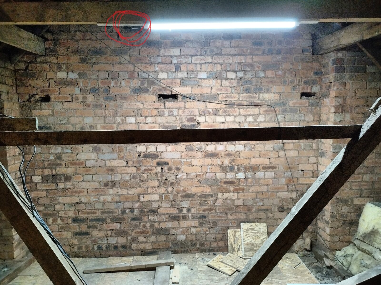

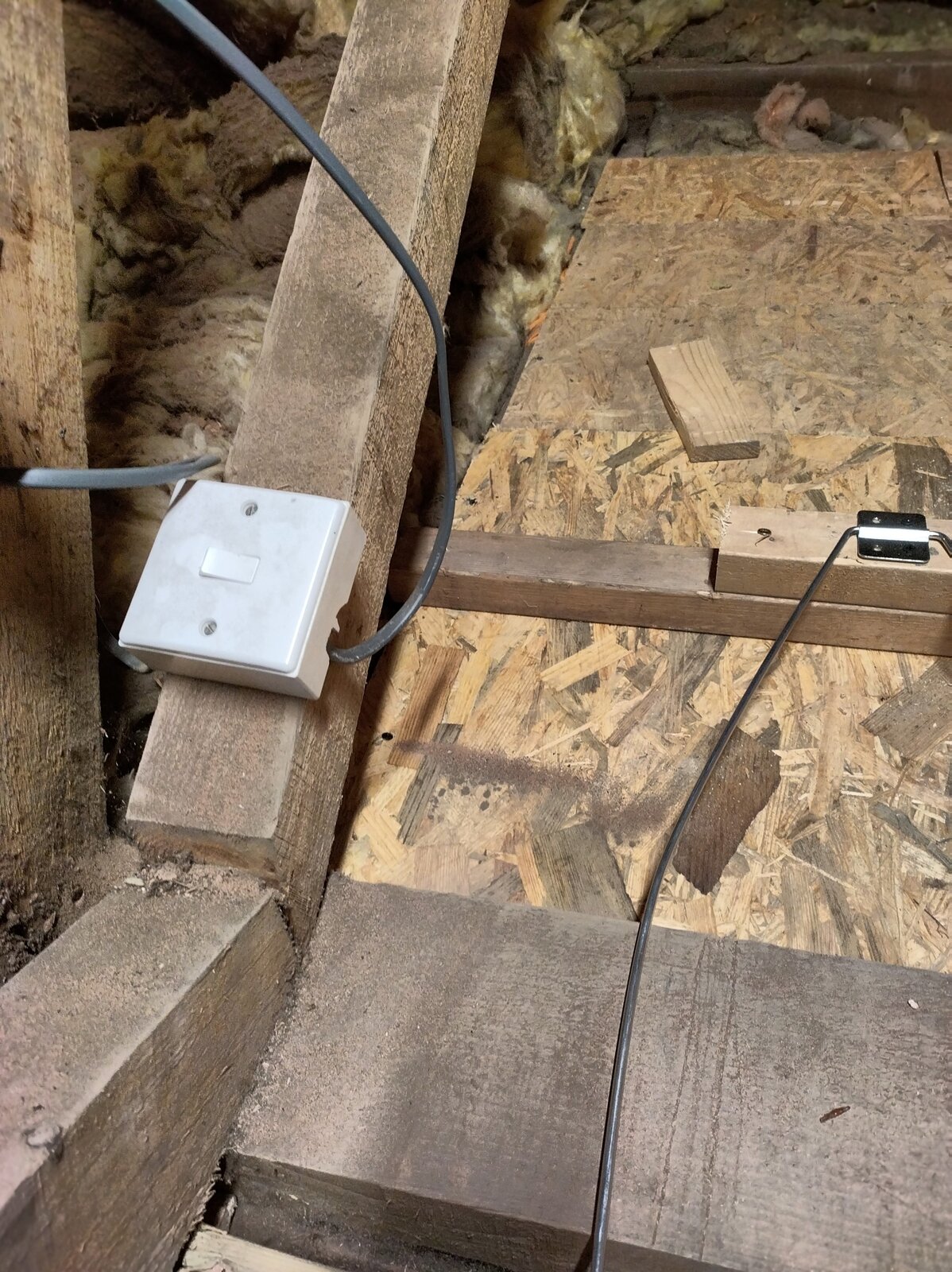

Cables from/ to switch need clipping to the joist. And the Junction box to the left of the light should not be hanging like that.IMG_20240529_150913_DRO.jpg
Thanks for feedback. The grey wago junction bag isn't hanging, there is a clip to the rear that secure it to the wood.
