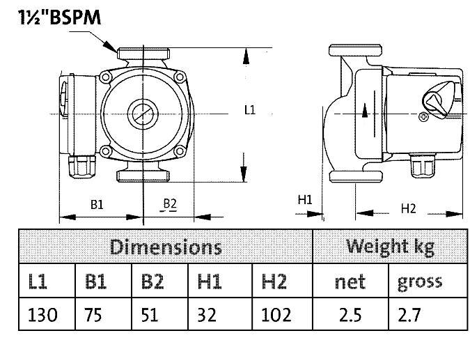

If you have over 75mm from the underside of the floorboard covering the pipe to the centre of the pipe, you will be able to turn the pump. The switch will then be on the top.
Here are the pump dimensions:
I totally agree but it looks to me that the pump is between the joists, probably under the floor, so turning it up to a proper orientation would not be an easy job - would need re-siting.
