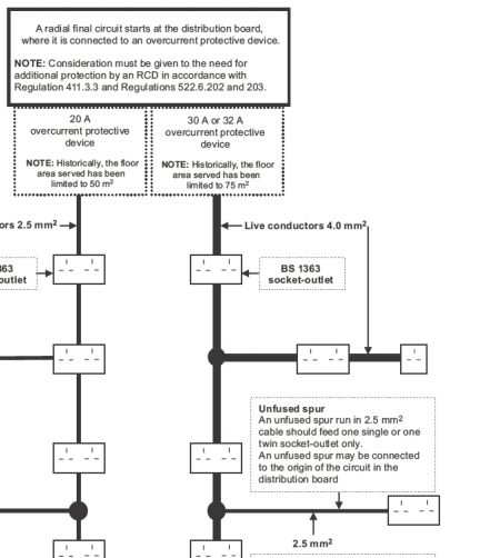

Of course, Appendix 15B does show an unfused spur(branch) to more than one socket with 4mm² cable from a 32A circuit.
What is the difference?
Also note that it does not call this an unfused spur.

I would point out that such a rule would negate or contravene the regulations relating to the positioning (or indeed omission) of overcurrent protection devices which actually do allow two single sockets on a 2.5mm² spur from a 32A circuit.
So it seems that there are technical regulations and then there are "apparent cover-all" statements which contradict them.

Maybe the person(s) who invented Appendix 15 had it in their mind(s) that 433.1.204's minimum requirement of a CCC or 20A for the cable of a ring final circuit also applied to the cable of an unfused spur, such that it might not be adequate for 26A, but would be adequate for what they regarded (as seemingly other do) as being the (20A) 'rating' of a double socket - hence their guidance that an unfused 2.5mm spur could supply one double socket but not two single ones (which I don't think anyone disputes would each be 'rated' at 13A)?
