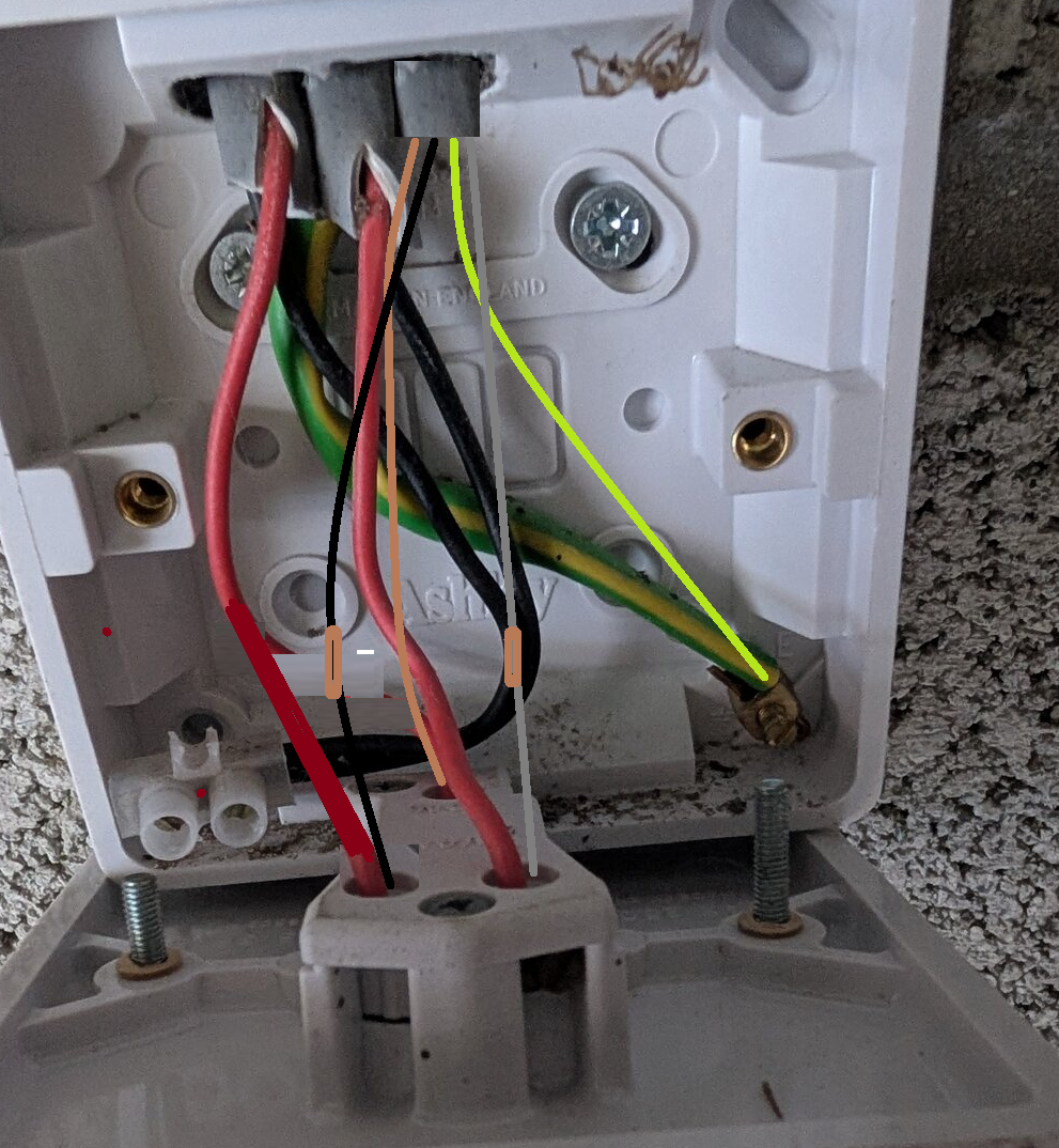

Adding a wireless switch in garage
thanks - got the above yesterday. Just need to figure out the wiring and fit it later on
I forgot to mention sleeving, the existing earth sleeve looks quite big, it may slide off to allow the new to be included and slid back on., the new black and grey should be tagged with brown (or red) sleeve, tape will be fine too.
The new cable will be connected to the other switch in exactly the same layout.

Dammit, the cable i had in mind to use is a 2core and earth, not 3. Looks like it will be a job for tomorrow but thank you for the diagram. Hopefully it makes sense when I get around to it!

You didn't follow the shopping list! Ah well.

Wow....great diagram
ha yeah got the correct switch ;) Just thought I had a 3 core cable at home but turns out it was 2 core, so quick visit to screwfix earlier, ready to sort this tomorrow

Thanks again for this diagram. Finally had time to fit everything this morning and can confirm all working as expected !
