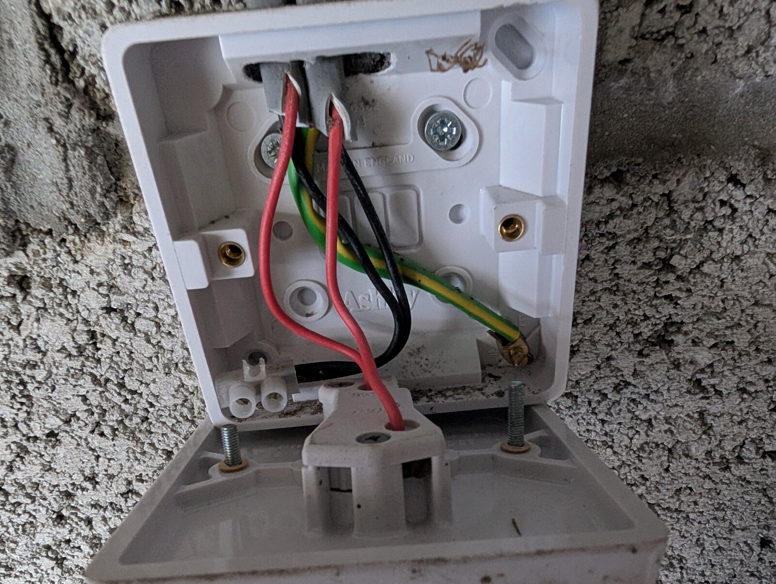

I literally just want to know if the receiver in the link you have pasted could connect to the switch I have already. So i can use both the original switch and the wireless one. Will post a pic of the wiring soon

Sorry @pete01 - edited my reply above as noticed it was you that sent the link to the exact wireless switch I am looking to get. So i tweaked it to suit that. Will post pic of wiring now
See wiring below. Poor spider seen better days
Just clip a 3 core and earth round to the new switch position as wayners said, that's the easiest option.

Sounds like it's the least complicated. Just noticed your link has 2 switches and 1 receiver. Could I not just fit that and get rid of the current switch?
You could yes, fit the receiver in place of that switch and put the switches where you want.

Cheers, I might give that a go rather than cable from one side of the garage to the other. Will check backplate first
