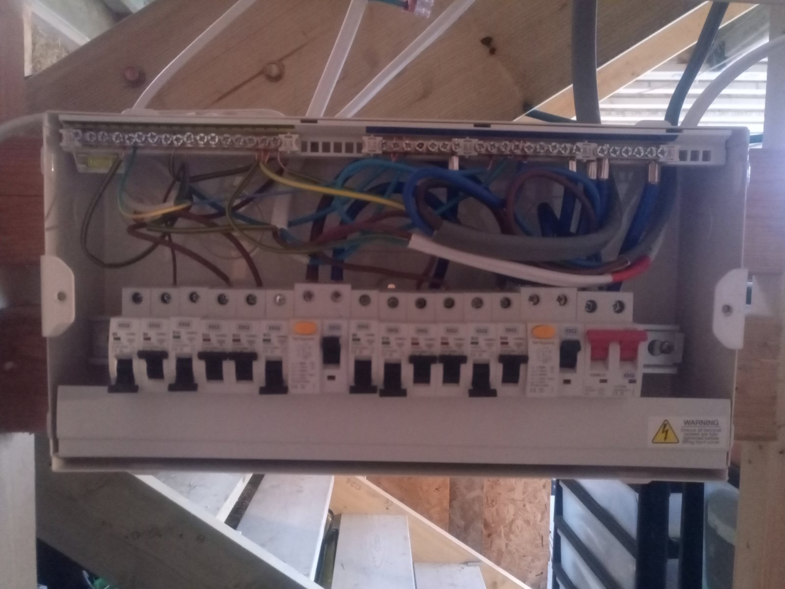

I have a (yes, currently very messy) consumer unit. It's a standard BG dual RCD unit. I want to put a single rcbo in for an electric shower. If you look at the picture
there's a busbar across the 6 rcbs to the RCD in each case.
I want to put in an rcbo. I think I shouldn't use the busbar because they're controlled by the RCDs. And I know the neutral goes to the neutral bar, but where should I get the line in from?
Any thoughts greatfully received.

1: If you need to ask, you should not be doing.
2: That consumer unit and the way it is installed is a pile of junk and is best placed in a skip.
WHY does it need to be an rcbo?
Why can't you fit an mcb that is fed by one of the RCDs?
Out of interest, what are those RCDs rated at (in A)?
As you have rcd there is no value using rcbo unless space by main switch (there isn’t )
You could install an Mcb
Or as you have it, the rcbo if it doesn’t hit wires.
Live connects to bus bar prong.
The cu is in a new build, and we're adding to it as we work on new sections, which is why it hasn't been tiedied yet and why a number of MCBs are not yet in use. The picture was taken just after I put 2 new MCBs to n ahead of populating them today.
The RCDs are rated at 63amps.
So a suitable - say 40amp MCB would suffice, instead of an RCBO?
