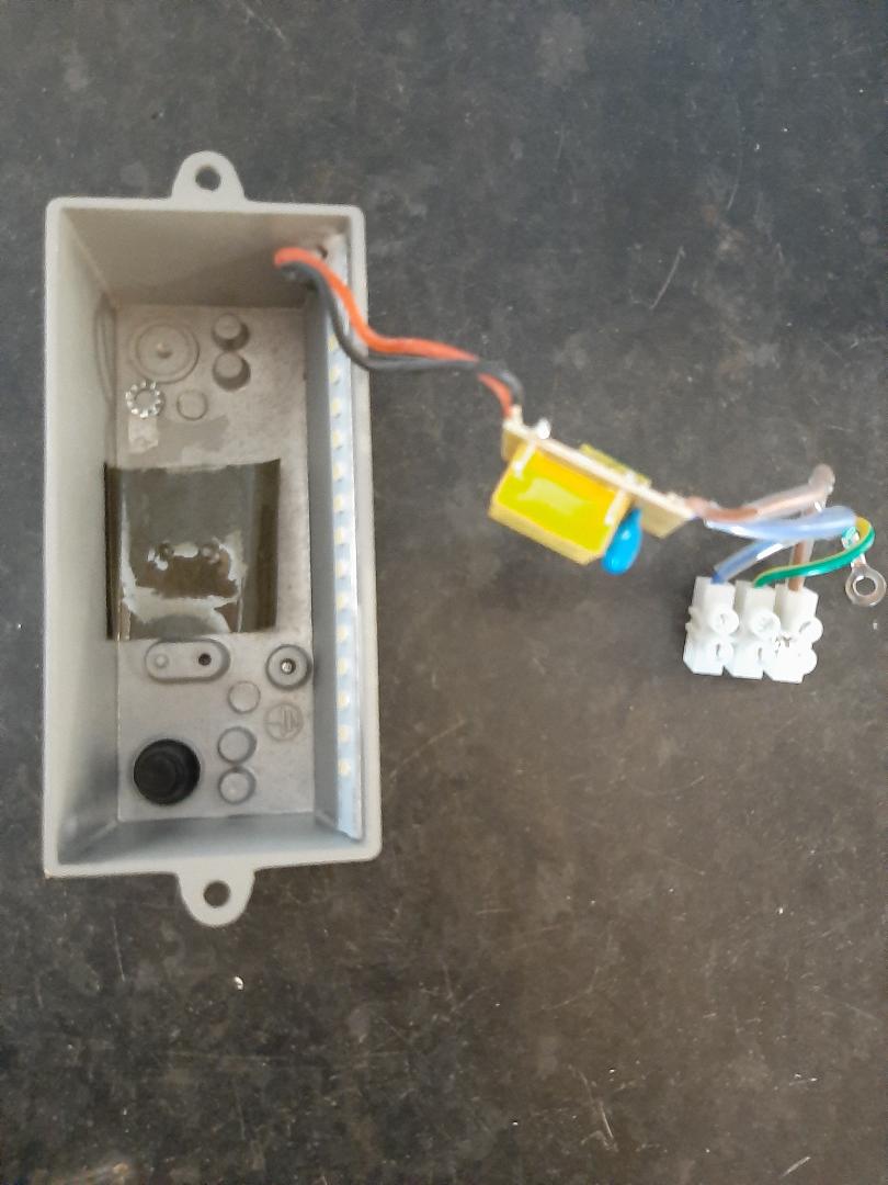

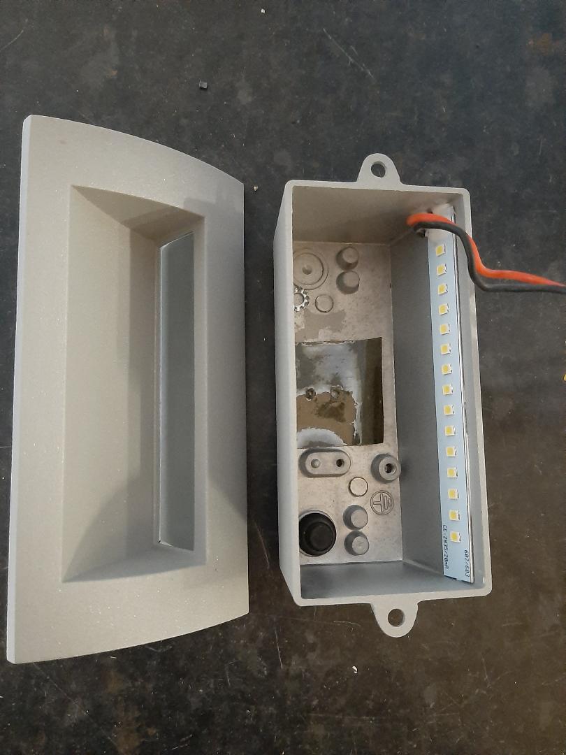

I have measured the pitch and it looks about 2.5mm, I've realised the brick lights I was going to use are 240v. I've added a photo of the lights, I'm guessing I could remove the guts and fit a 12v compatible lamp/led?
I think I'm going to need to route the cables from the circuit board through the motor housing and to a wall mounted enclosure as there isn't much room within the motor housing itself to fit anything in to be honest. With this in mind could you possibly recommend a parts list please?:D:D

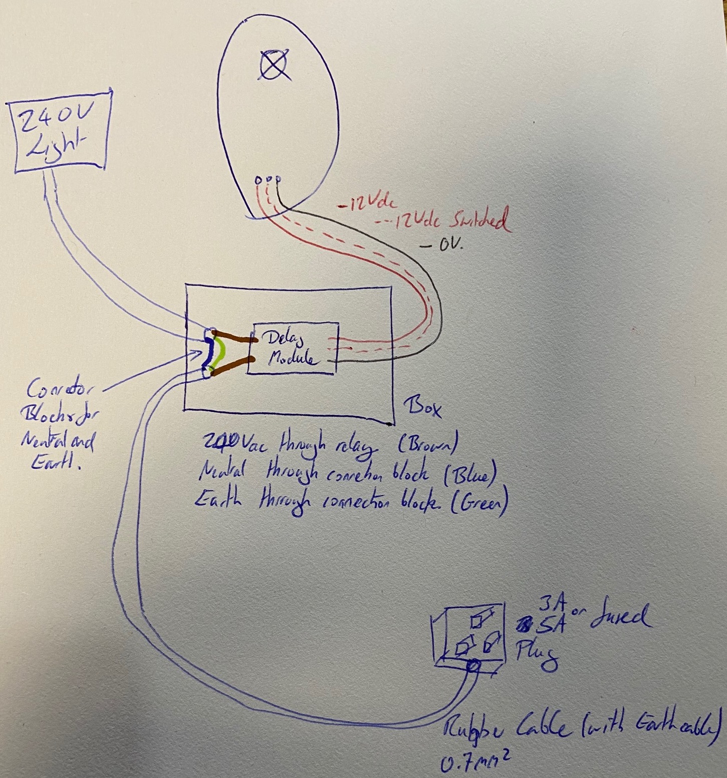

Why change lamp to 12V?
Suggest you keep it as 240V.
Also, I show my solution with a Delay Relay Module, but exactly the same wiring is used with Relay only module.
Shopping List and wiring diagram (happy if Oldbutdead shoots it down)

Relay Module with run on delay
https://www.ebay.co.uk/itm/New-12VD...144375?hash=item1c7e2083b7:g:svgAAOSw~AVYtW9x
or
Relay Module
https://www.ebay.co.uk/itm/1-channe...378827?hash=item25f2dd4acb:g:4a0AAOSwb9BaymBV
I show it with Delay Relay Module, but this is same wiring if used with Relay only module.

Blooming heck that was quick, impressive and obviously extremely knowledgeable.
I didn't realise I could connect one side of the relay to the mains supply and the other side to the 12v output pins on the circuit board.
