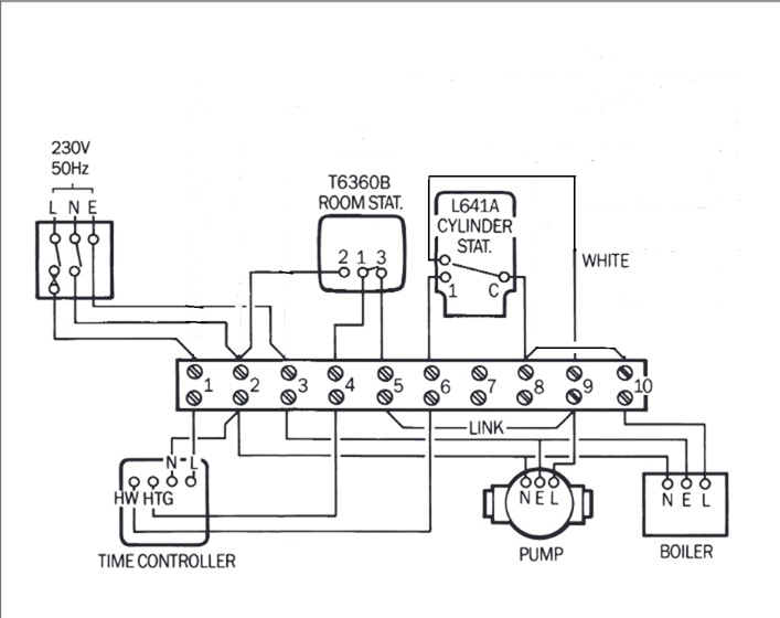

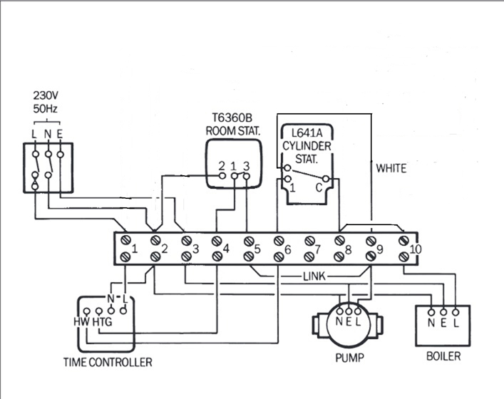

I am happy to believe it shows the significant wiring features.
If there was a motorised valve installed:
1) It would be significant and shown
2) This thread would not have been started, as the issue wouldn't be present.
I looked at the old diagram
c-plan_old-jpg.163867
and there was no motorised valve however the domestic hot water was thermo syphon, so I considered how you would add a pump for the domestic hot water, and I realised as the original post if central heating is running you automatic get domestic hot water.

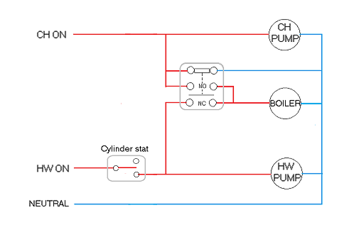

Thanks for the brilliant responses - I spent another hour crawling around tracing wiring and piping. There are def not any valves in the system. The HW pump wiring is via the cylinder thermostat and the pump is right near the cylinder upstairs, so although a gravity fed system a pump has been added to help the flow when the cylinder temp is low.
I am going to dive into the relay specs and see how to wire it in - Andy ... I may ping you for some help on wiring once I have a straw man plan(!)
