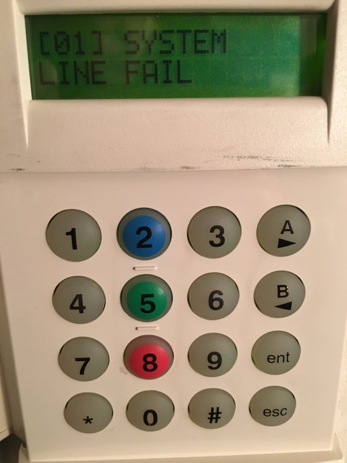

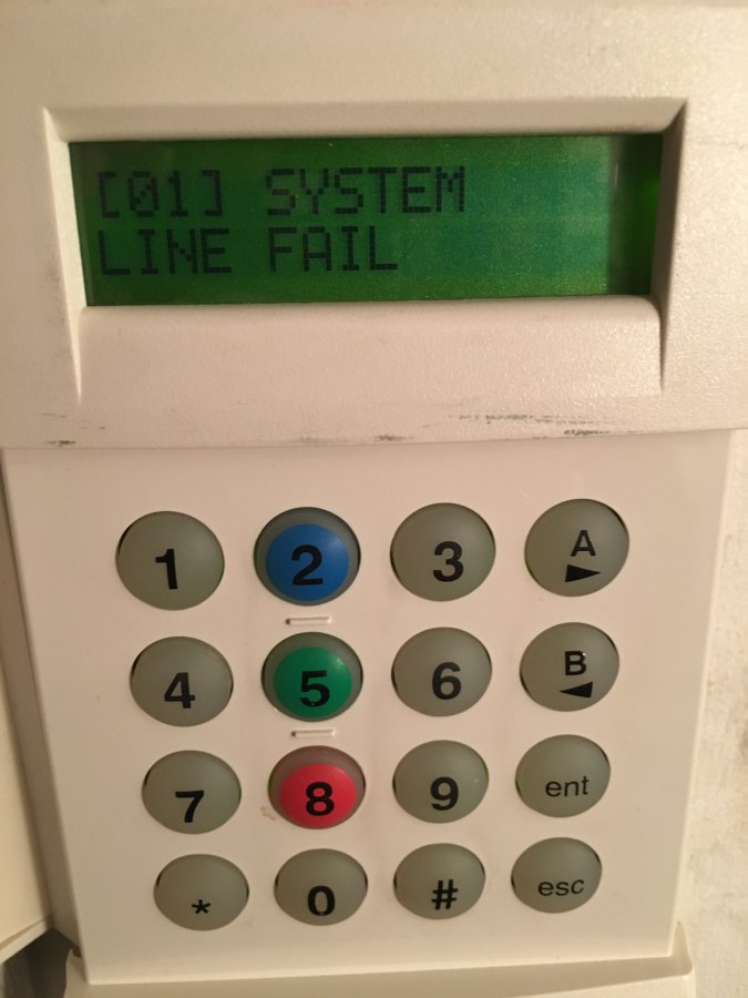

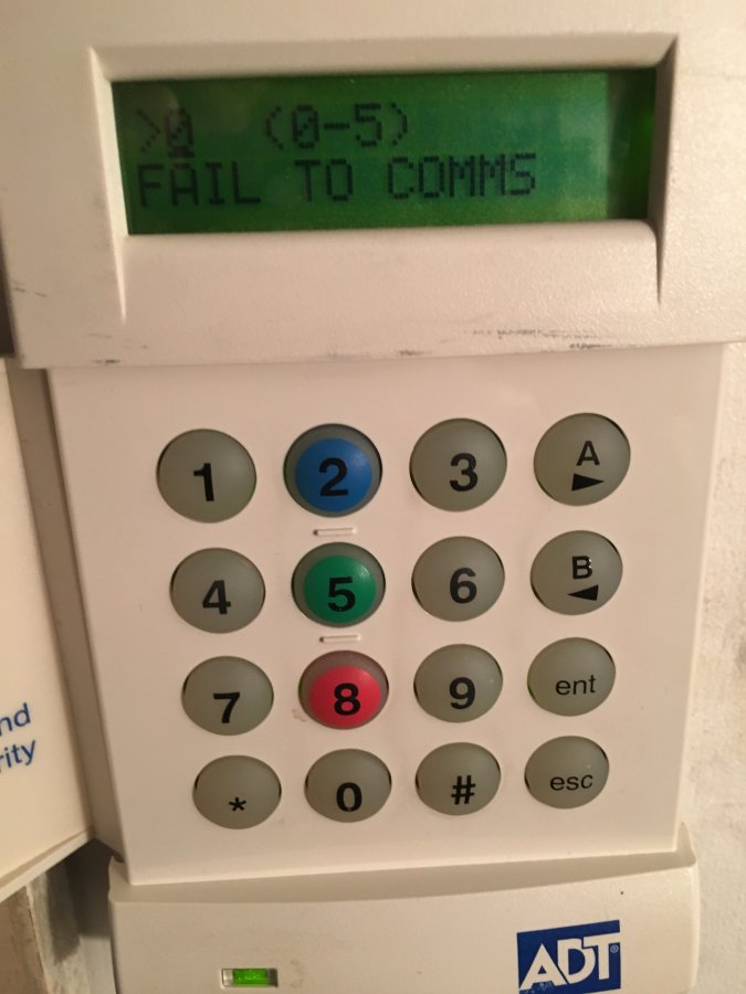

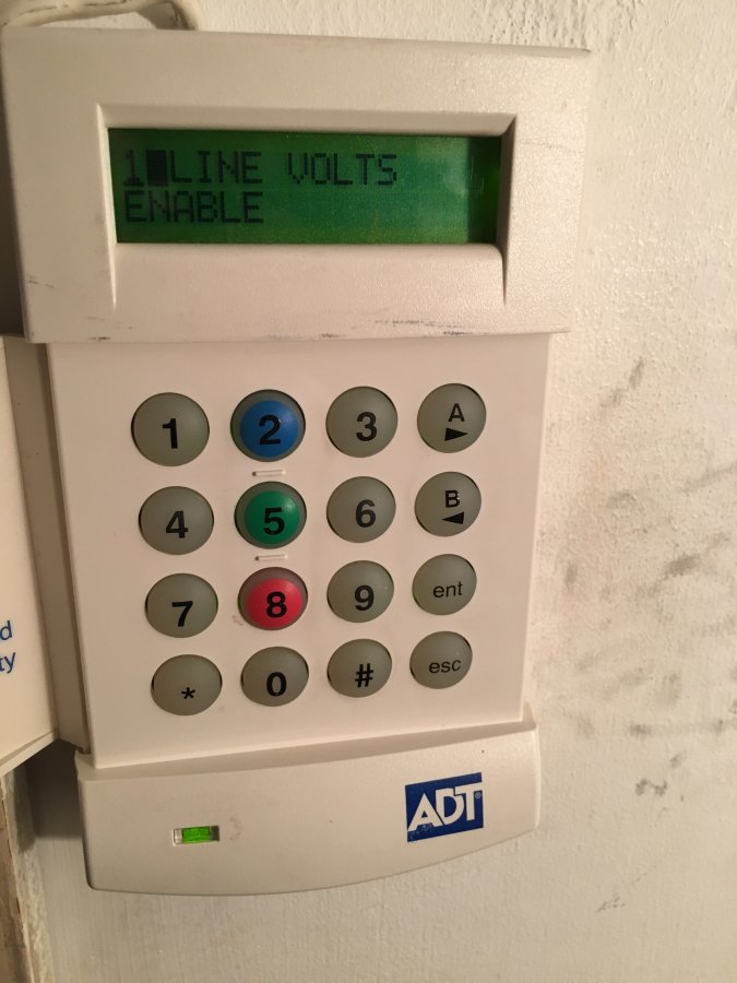

Thanks Scott how do you disable in 13 . It says 1 to enable but not how to disable .assume 0 is to disable but it won't accept that ?
Yes tried that but goes to a - symbol rather than 1 but does not turn it off ?

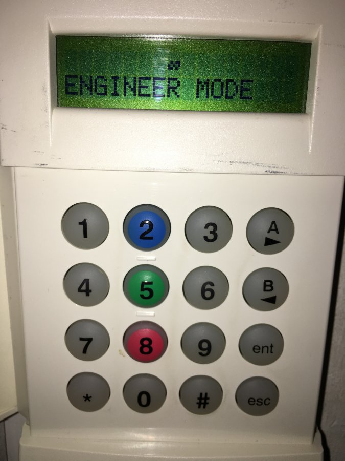

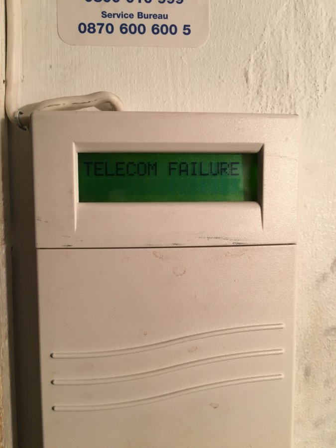

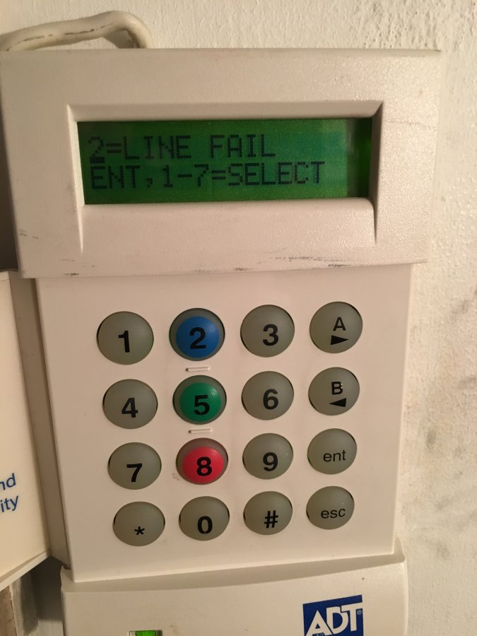

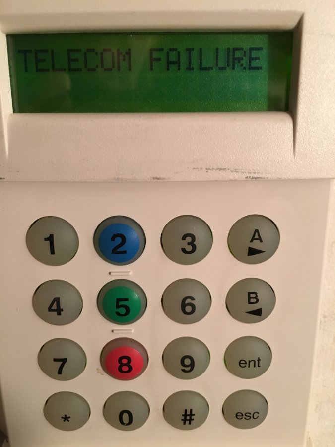

I've managed to trace the line back and the BT engineer had definitely disconnected the alarm feed for the phone. Still getting line fail and telecoms failure but I still done seem to be able to disable the coms even with the engineers code?

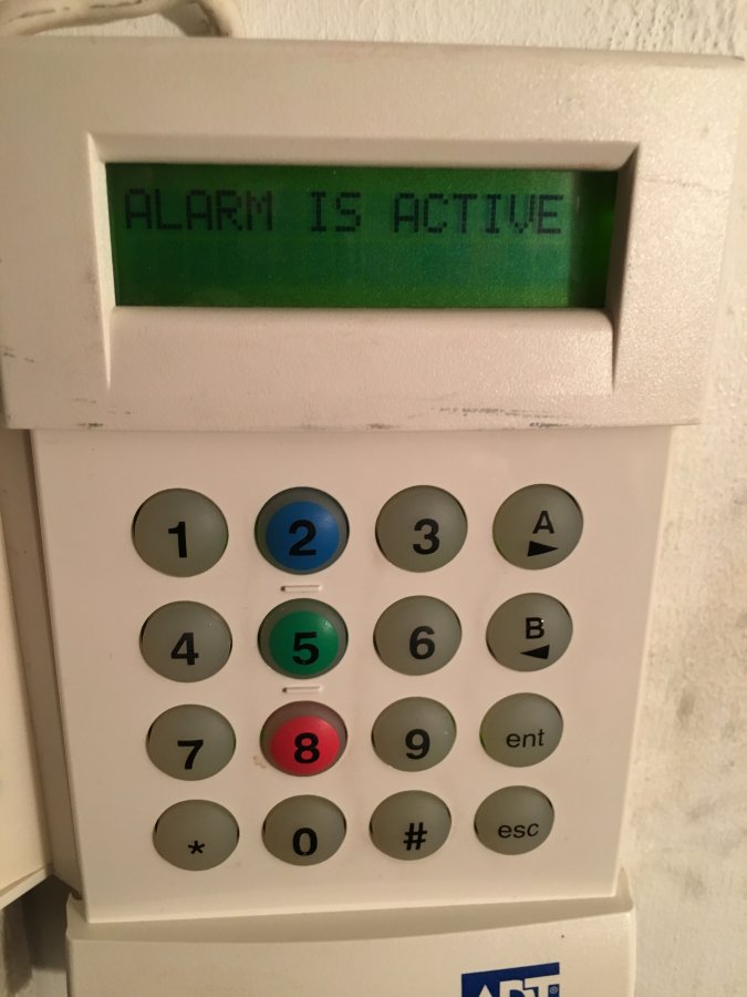

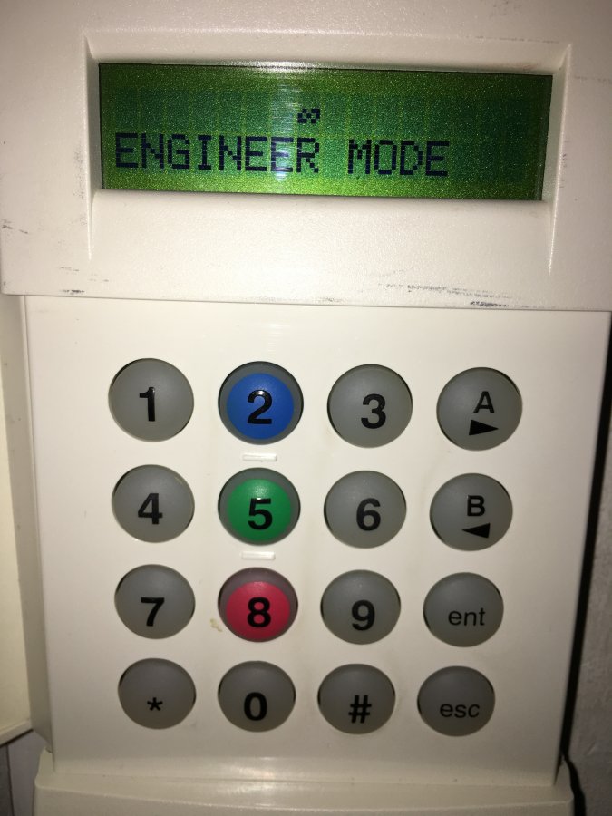

Used the alarm today and came back and it has call adt etc . Put eng code in and all I can find in error log is "system timeout" does anybody know what causes this error and if it's what cause the alarm to fail or a red herring ?
What's happening is that the panel has had an alarm condition and reset. It then generates a code that needs a cooresponding external reset code entered in order to flush a reset through the panel. You would normally contact the provider, tell them the code and if they were happy that it was a standard false alarm, they would generate and provide you the reset code to reset the system. If they weren't happy, they would schedule a service call and you would be locked out of the system until they arrived and reset it. If you hadn't paid your maintenance bill, then no reset...
If the system is not under maintenance, the technistore reset needs disabled. Menu 6 (parameters), then 10 (Remote Reset) to 0 (Off).
