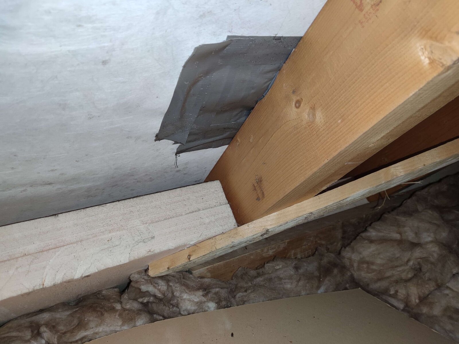

I told the roofer about this and that the job did not fix the leak and I pointed out that the spot in my box room is directly below the dormer window. He came out to see what I meant and then had a look in my loft. He was saying the roof wasn't built properly as the felt has no counter battens and has a hole that was patched with gaffa tape. He said all the tiles on that side of the roof need to come off, felt redone and then the tiles put back and I'd be looking at £2-2.5k.
He suggested I should contact NHBC and tell them my roof needs redoing. Seems odd as there are no signs of any water ingress in the loft, even where the hole in the felt was patched. It's a tight seal on the patch. NHBC won't help with the dormer, I already tried and they declined based on the fact they declined a claim from the previous owner 6 years earlier for the same thing (a claim the previous owner never declared when selling). I've not spoken with them about the counter battens yet, that sounds like a different issue. Are counter battens required? This is what my loft looks like:

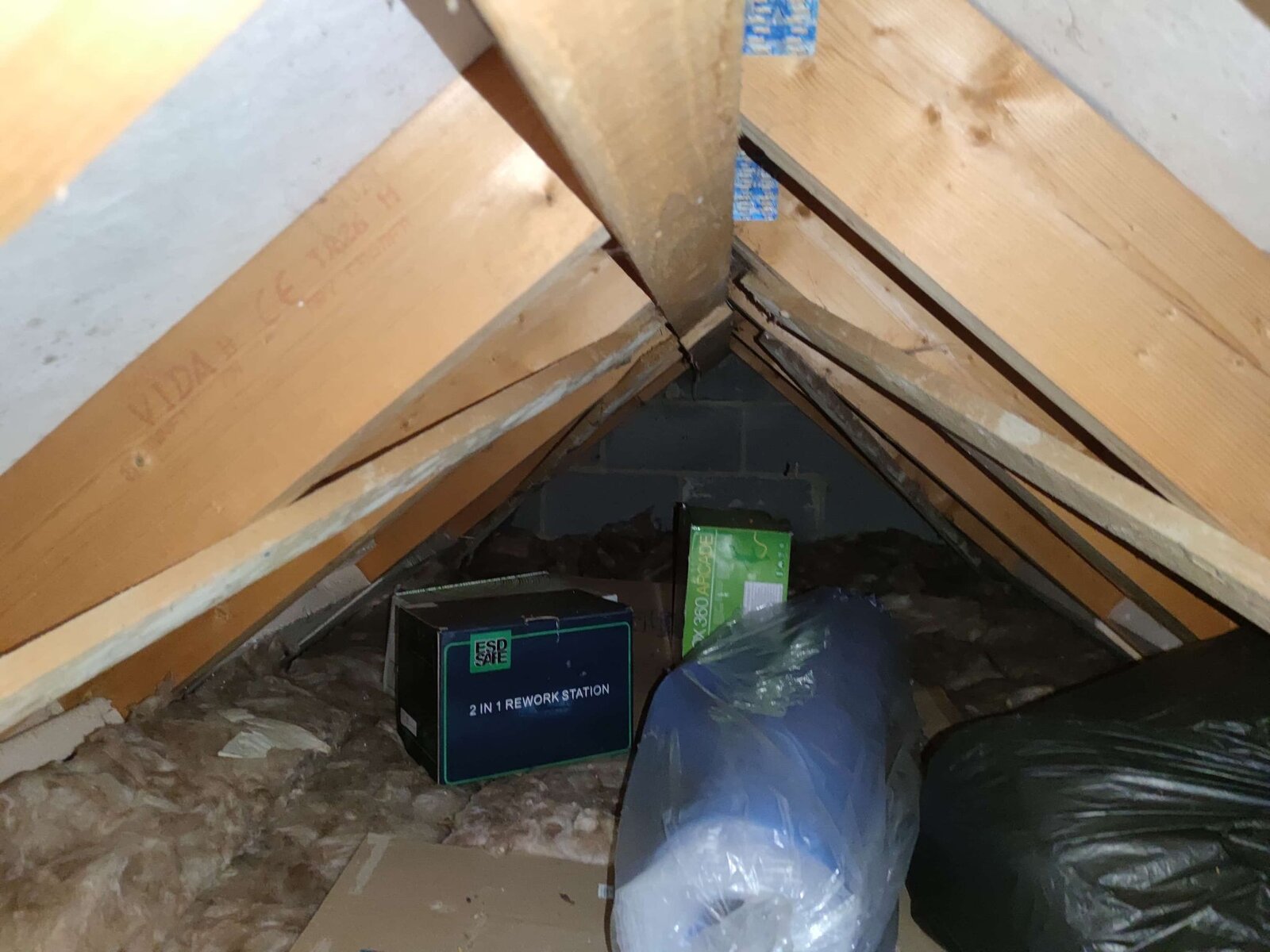

I should add that being a townhouse my loft is only half the roof space - the other half forms the sloping walls in the second floor bedroom so the loft space for that part of the roof is behind those walls.

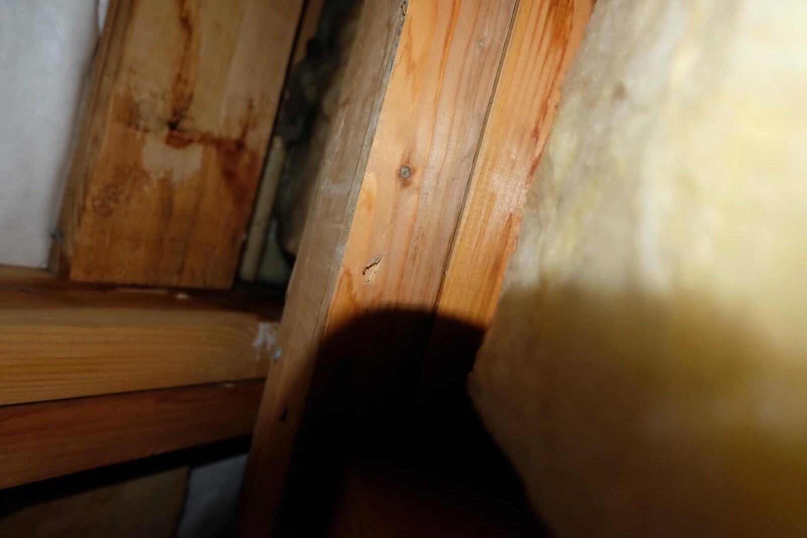

In the box room I had a hole in the ceiling that I made at the time I first noticed the leak so I could check the extent of the leak and today I've enlarged that hole so I could send a camera up there and access the hidden roof space. Turns out there is signs of water ingress on the beams right where I expected them to be - on the side of the dormer window. So removing the mortar has not fixed the leak. You can see this here:

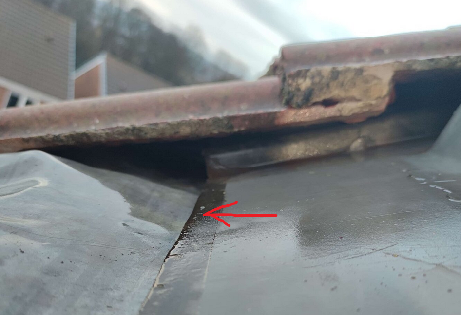

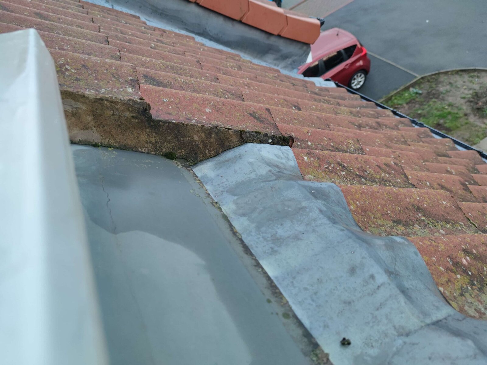

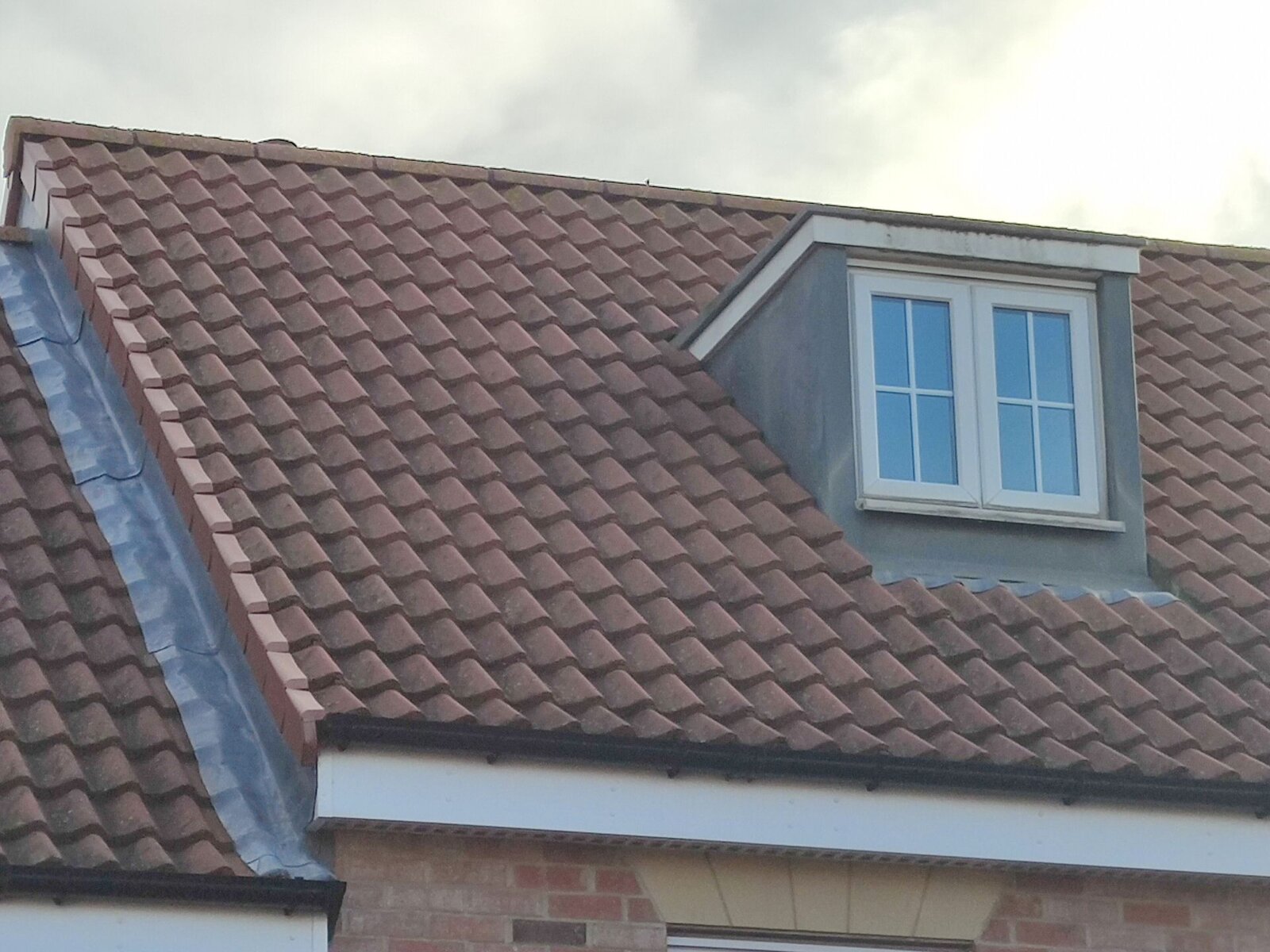

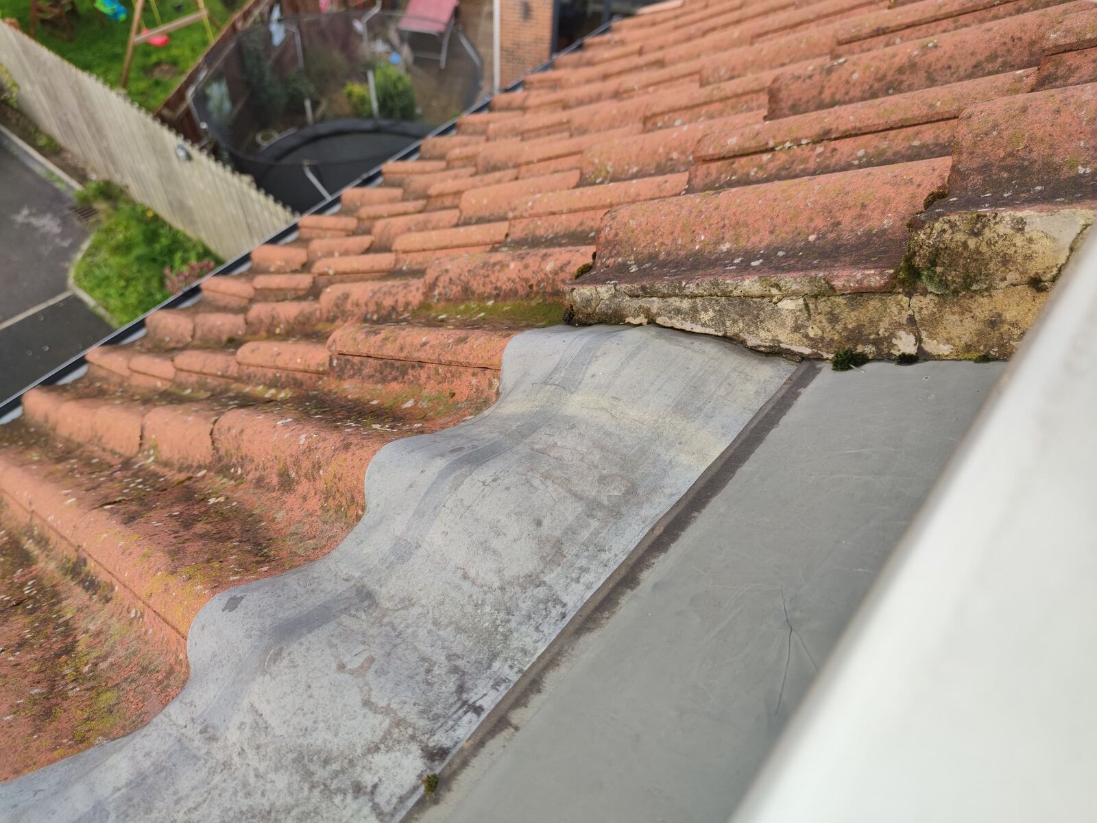

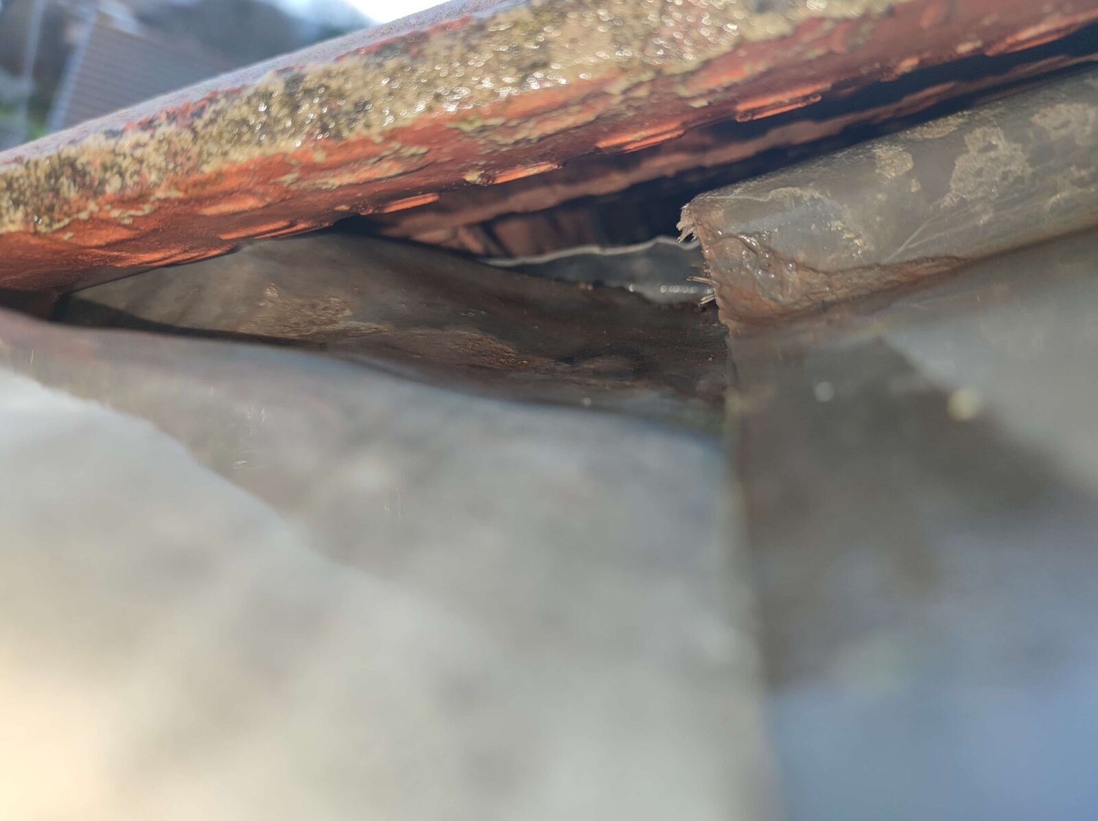

I was originally worried he may have made the issue worse due to a hole I can see. This is how the side of my dormer looked before any work was carried out:
And here it is now:
130190112_403833760664516_9011501775928771590_n.jpg 129658902_365760694725155_3436641352547495957_n.jpg
You can see into the roof void if you look closely enough. Surely any driving rain heading in that direction would be able to get under there and bounce its way into that void. There should be felt under there but I don't know how it copes if it gets too wet.
As I said I had a leak before the mortar was removed as well so the roofer may have been right about the mortar being done wrong and blocking the channel, but it looks like there was more to the problem than that.

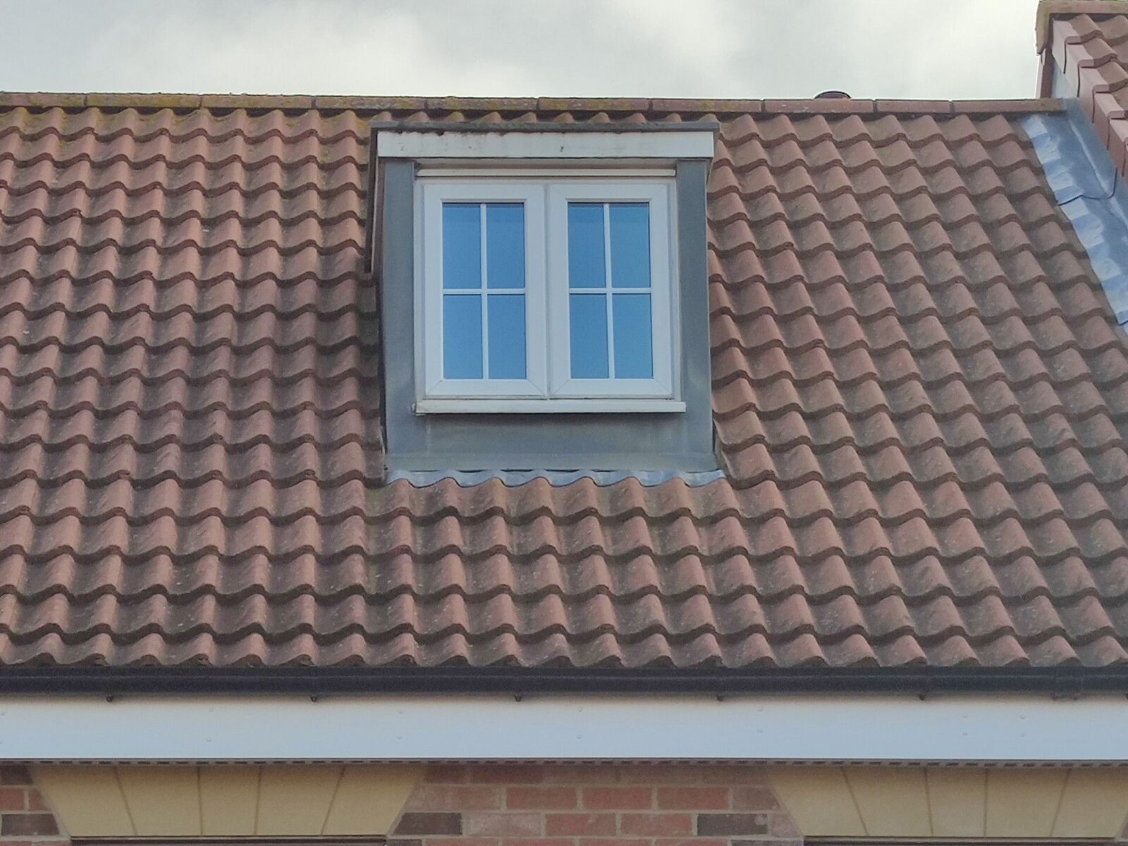

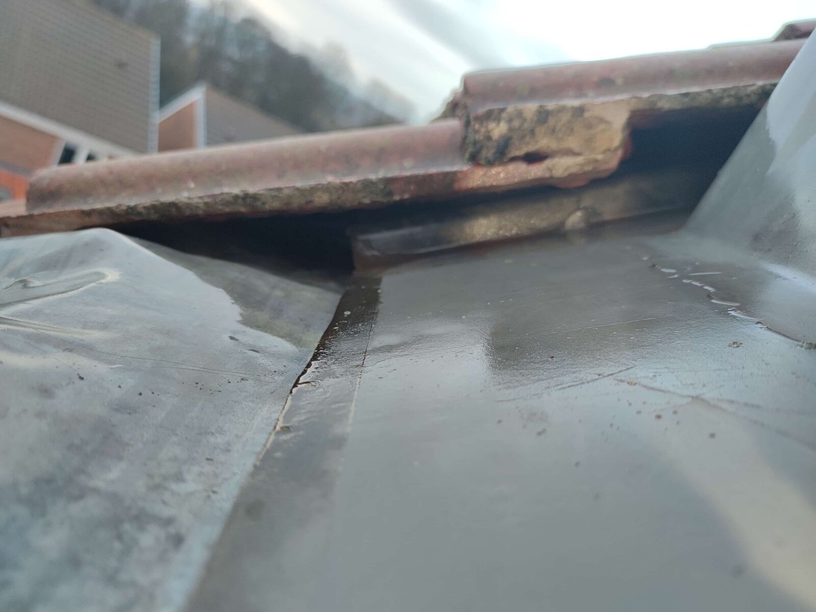

This is how the other side of this window looks:
Every house on my street with the same design as mine has mortar in these corners so it seems odd to just remove it - unless they were all done wrong.

The roofer has tried to fix poor detailing.. doubt he made it worse.
firstly i see a grp structure I have never seen one with properly thought out weathering design .
The lead flashing in the picture has a back fall so rain will not run off well.
Probably the water is backing up and running over the top or side edge
the course of tiles below the flashing need their tops trimmed to allow the flashing to sit crrectly and to drain.
the edges of the flashing need a more robust turn up.
fwiw its nothing to do with no counter battens, they are not essential in this case.

Grp dormers often come with pre installed front aprons and site roofers tend to just cover the tile without regard for issues down the line.
Obviously cutting X amount of tiles was too much hassle whilst on a tight price
Gauge adjustment probably out of the question being close to eaves and size of tile
These are hideous details and everyone knows it.
The same can be said for grp chimneys.
That said it shouldn't take a genius to rectify the problem and it doesn't require stripping the whole roof...without looking at any other pictures.
Thanks @datarebal and @Barthy. Some very good information there. I'm glad the removal of the mortar hasn't made the problem worse but it does seem odd that I can see into the roof void through there now.
I think the lead flashing may be an issue as well looking at it as it is sloping back towards the roof due to the tiles not being cut. That is concerning though as no doubt it's an issue on both dormers, but no signs of leaks on the other one.

i could be wrong but doesn't photo 5 show the skirt having come unstuck from the fibreglass?
I'm a bit confused by what you mean by "skirt having come unstuck from the fibreglass"? Is the skirt the lead flashing? The fibreglass bit that sits on top of it isn't stuck. Not sure if it's supposed to be. It's the same on both dormer windows.
I'm still lost as to where exactly the rain gets in. When it was raining yesterday I stuck an endoscope into the void in photo 6 and didn't see any signs of wetness. But rain was dripping into the room below. About one drip every 10 seconds so it's a very small leak.
This is the bit I thought looked "unstuck"...
Yeah that is certainly not stuck down. I can get my finger under it in the middle without too much effort. Same on the other side of the house on the opposite dormer. I could imagine water getting under there but won't the lead flashing curve upwards and prevent it getting in there? I honestly don't know.

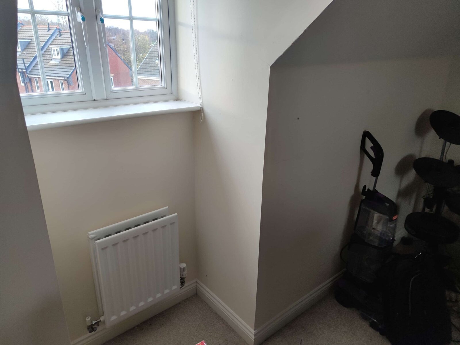

To be honest I'm thinking about cutting into the wall in the second floor bedroom so I can access behind the dormer and have a better look. Then afterwards building a cupboard/storage space there. There is so much wasted space behind the walls. You can see what I mean in this photo:
It does not need sticking down it needs correct fall to run off and plenty of head lap
Sorry I'm confused. Where do you see the leak in that last photo? Is your dormer the same as those in the background? Can you get a photo of the sides of the dormer where it meets the roof?
In your first post you said the leak was directly below the dormer window, yet you also said you made a hole in the ceiling to see the damp timbers.
Apologies for confusing you. By directly below I meant the room underneath the dormer. The room you can see in my new photo is the upper bedroom. Look to the right side of the window, past the radiator - the wall comes inwards towards the room and then turns again towards that vacuum cleaner. Focus on the side wall that is coming inwards from the window. Behind that at the top is the dormer - where the angle is. Now imagine you went down there to the floor, and down below that floor. That is where the box room is, and the hole I made in its ceiling. That hole looks upwards into the void to the right side of the dormer. (or left if you're standing on the street). The location of the leak pretty much matches up to the side wall of the dormer.

I wonder if there's a possibility water's getting in at the top of the dormer , and running down the felt under the tiles till near the bottom of the dormer side where there could be cuts/overlaps for it to seep through.
