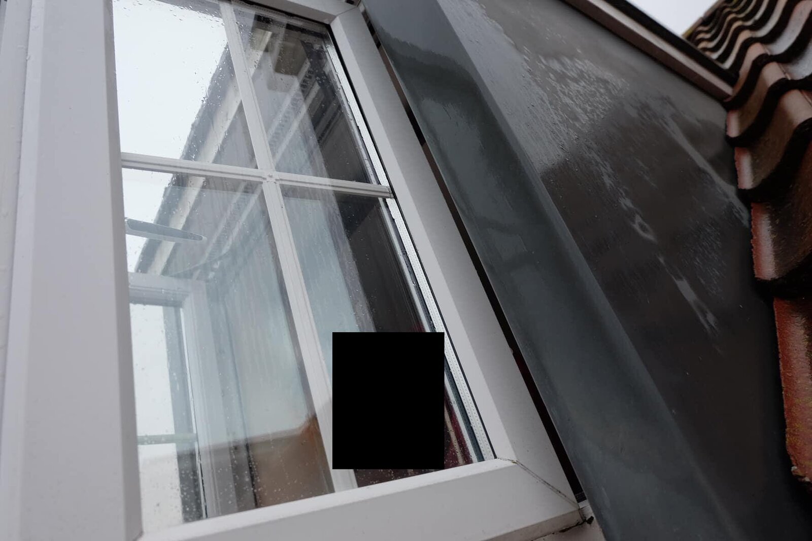

I've taken a few close up pictures using a selfie stick and a camera. Ignore the black squares, I didn't fancy being in the shots.
This is the left side of the dormer when viewed from the outside, and is the side where the water seems to be getting in based on the point it drips into the room below. Below those tiles I can't access because they're hidden behind the wall in the bedroom with the dormer. So the drips go through there, down a floor into the box room.

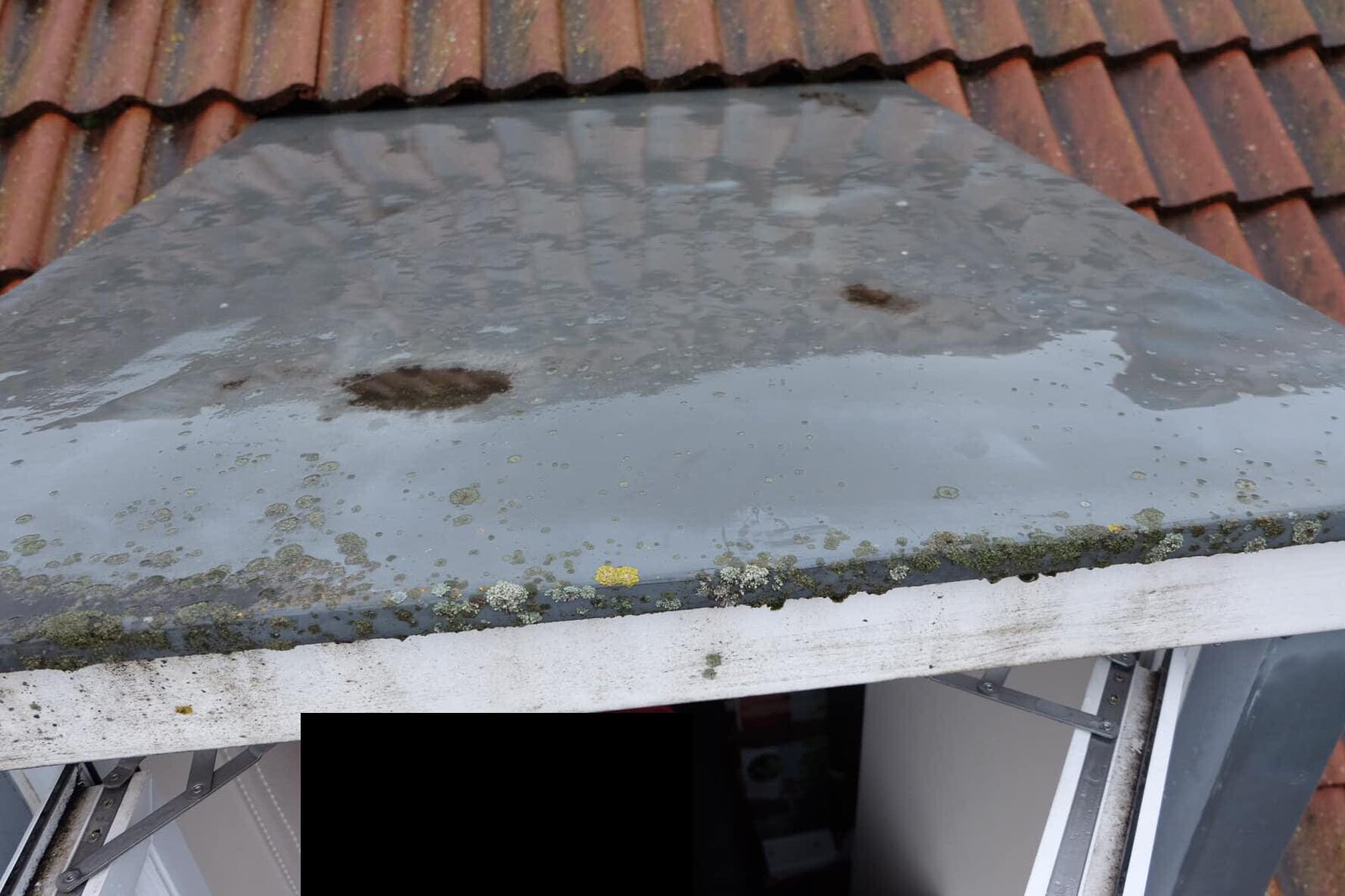

I can't rule out the possibility the issue is at the top of the dormer however - as @regsmyth suggests as a possibility - so here's a close up of that.

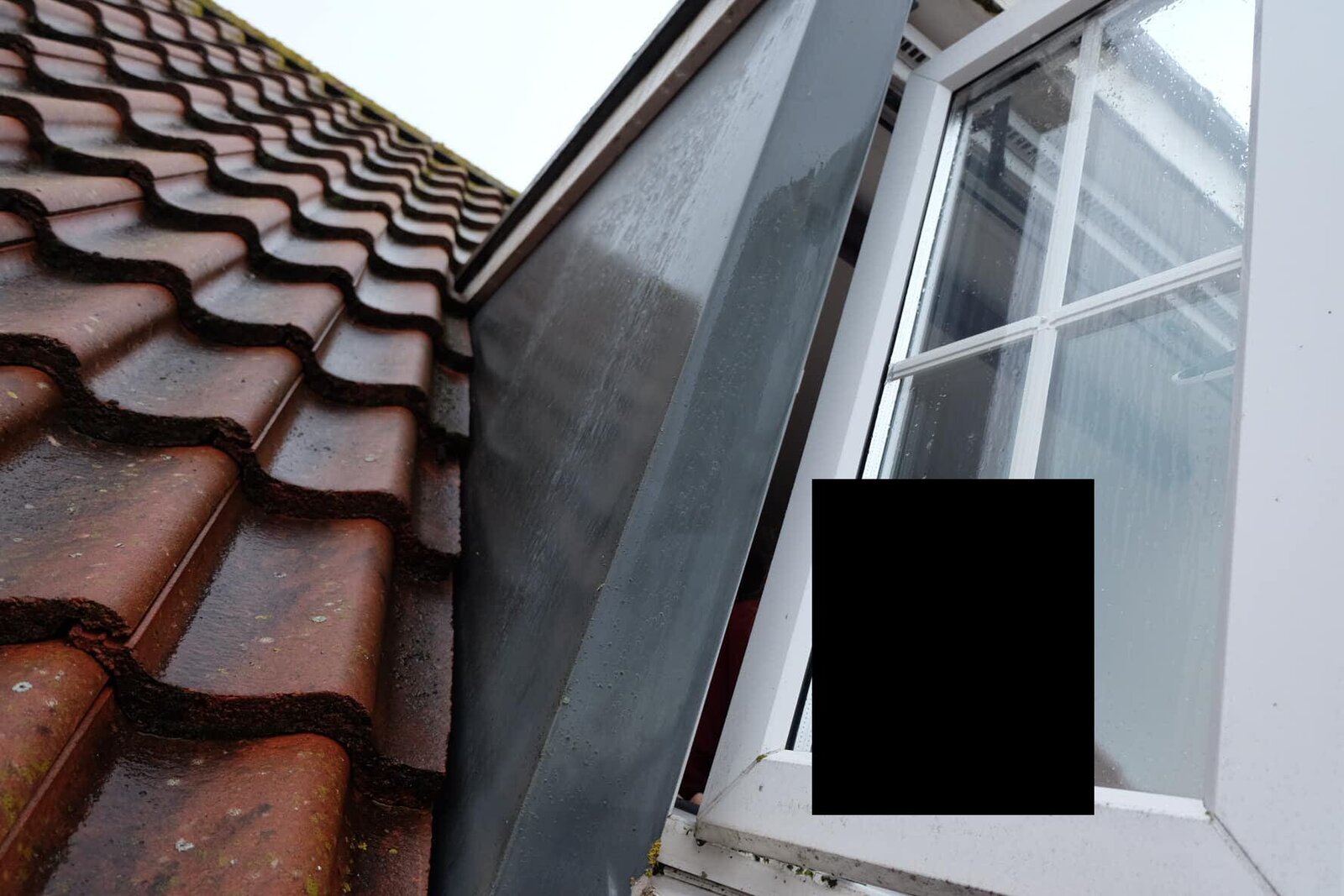

Here is a close up of the right side of the dormer, but I'm almost certain it is not this side otherwise I'd be seeing water dripping down on to the landing rather than the box room.
As already mentioned by others the extended apron is a strong favourite, It is also possible that they have drilled into the grp side channel when fixing the tiles on that side. It shouldn't be difficult to find that leak.
