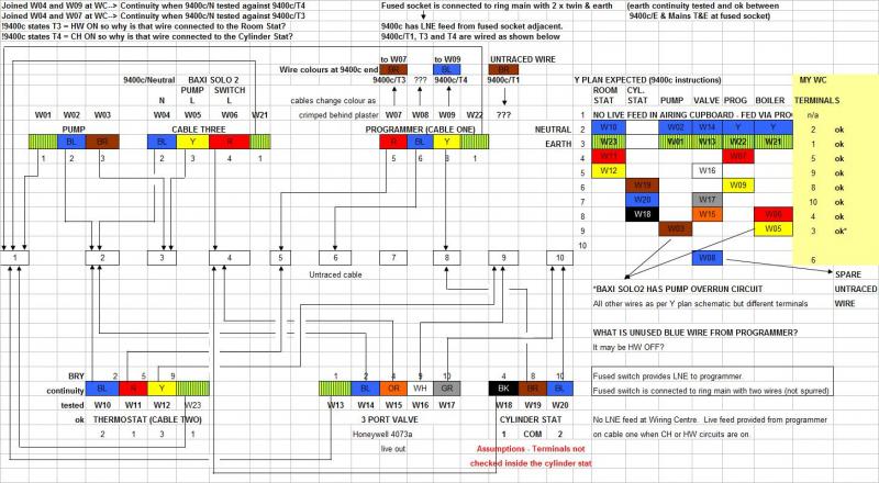

The wiring is basically correct except as follows.
The ST9400C has 6 terminals:
N: should have two wires - the Supply Neutral; and a link to T2 of the wiring centre (WC/T2).
L: the Supply Live
1 - HW OFF: should connect to the WC/T10
2 - CH OFF: not used
3 - HW ON: should connect to WC/T8
4 - CH ON: should connect to WC/T5
Earthing: Pump T1 seems to be the earth terminal. Is the cable from pump to the boiler a full twin and earth? If so, earthing is OK. But if it's only a twin (L and N) cable, the system is not properly earthed.
The pump has a white flex with BNE wiring. Neutral and Earth are wired into the block with all the others (boiler, programmer, valve and room stat).
Just got to trace the other end of that blue wire and see if I have a wire I can use for terminal 1 HW OFF - which will then make it fully independent.

That's OK, so far as it goes- it connects all the local earth terminals together in the the wiring centre. But where is the connection to the earth for the rest of the house wiring?
Where is the supply for the programmer coming from? It may be the boiler or else a socket/fused spur near the wiring centre. The earth should be coming from this.
Be careful. As I said, there should be two wires to the programmer N terminal. It's the HW OFF terminal you need to worry about.
CONTINUITY TESTING - HW OFF SEARCH:
There are three twin & earth cables behind the programmer.
One pair: Providing Live & Neutral for the programmer.
Second pair: The brown wire goes to HW OFF, the blue is on the N terminal for the programmer.
The third pair are providing CH (BLUE) and HW ON (BROWN) - I managed a continuity test on these earlier today - and the circuits are going on/off with the room and cylinder stat as expected.
My view is the blue wire in the wiring centre could be connected to the N terminal of the programmer - After isolating the programmer I've tried testing for continuity with both of these neutral wires in case the electrician did something weird with the crimps but can't get continuity.

I'm beginning to think there is either no spare wire available to take the HW OFF 240v to the airing cupboard - or that I need to find those cable joins and check the original wiring to see if there used to be.
There is one other possibility that has occured to me. I know there are four wires for the boiler - EARTH, a separate switch live & pump-overun live and also a blue wire that is currently connected to neutral at the wiring centre. I would expect this cable to be routed directly from the boiler to the airing cupboard - but if it was routed via the programmer there is a possibiilty the neutral wire from this cable (cable three) is connected to terminal 1 at the programmer so the 240v would flow to the neutral block at the wiring centre.
I'd be grateful for someone to read the above supposition and let me know if there are any errors in the reasoning - thanks.

You need to find the other end of this cable. The brown wire should connect to WC/T10. The blue should connect to WC/T2.
Your last diagram shows a yellow wire connected to the programmer. What has happened to it?
By N terminal I hope you mean terminal 2. The blue wires connected to other terminals are not neutrals

Terminal 1 of the programmer should connect to terminal 10 of the wiring centre.
I tested brown wire at terminal 1 of the programmer to see if it matched the blue wire at the WC end which was in WC/T6. I'm testing using resistance and I get a figure ~12M ohm. I may be wrong here but I assumed that maybe I've identified that it is the brown wire from programmer/T1 - but perhaps there is some kind of cable fault. Not sure.
I connected the blue wire from WC/T6 to WC/T10 then fired the system up with CH circuit on, HW circuit off at the programmer - demand from the room stat - no demand from cylinder stat. I tested WC/T10 against neutral and got a reading of ~65v.
I repeated the above test but took the blue wire away from WC/T10 and isolated it back at WC/T6.
Readings
WC/T10 against neutral ~65v
WC/T6 against neutral ~20v - if identified correctly and no cable faults I would expect 240v here - fed from programmer T1 for HW OFF.

The main picture block shows the wiring I have identified at the wiring centre. The bottom right hand corner shows the wiring numbers & colours at the programmer end. As mentioned earlier I believe I am correct to say:
Programmer T3 CH ON = BLUE WIRE -> RED wire at WC end (W07) from cable one connected to WC/T5 providing 240v for switching through the room stat.
Programmer T4 HW ON = BROWN WIRE -> YELLOW wire at WC end (W09) from cable one connected to WC/T8 and providing 240v for switching through the cylinder stat.
I believe these two wires are correctly identified as I can fire the HW / CH independently - or together by switching the room / cylinder stat demands on/off. Note HW circuit must be on in order to get the CH working as can't get a voltage to the grey wire.
To clarify the N terminal at the programmer end (as in ENL1234) - I am not confusing this with the programmer terminals 1234.
There is an earth with the RYB wires from the programmer - this is connected into the wiring block.
Which terminal does it connect to in the wiring centre?
All earth wires arriving at the wiring centre are connected to WC/T1. I have added the wires - and I show that they are connected to WC/T1 in the schematic top right - but I have not drawn the lines in on the circuit diagram. I have not tested the earth wires for continuity at the WC.
There are two boxes at the bottom of the diagram - one refers to the "existing programmer", the other to the ST1250. Is the existing programmer the ST1250 or the ST9400C?
Both boxes refer to the wiring as it was setup for the ST1250.
So why are they different?

You asked why the two diagrams for the ST1250 at the bottom right of the picture were different - the left diagram is a sticker that is on the back of the ST1250 programmer which I presume shows the way it uses the outputs, the other one is a diagram showing the way the wiring was connected to the back of the ST1250 (via the backplate).

I updated the diagram to show the current wiring, added the earth connections to WC/T1 and also made some notes about the continuity testing (I included a retest of all three thermostat cores).
Note there remain assumptions as to which terminal of the cylinder stat is which because I've not taken it apart in case it won't go back together again!
