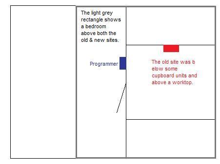

I have reasonable confidence that because two of the three cores at the airing cupboard are crimped through to the programmer that the missing core MUST be buried in the wall; either crimped or made safe.
I know when the work was done the electricians had the carpet up in the room above to fit some wiring for cupboard lights at the same time, so depending on how the old cables were routed in the utility room. As I understand the regs they would have to run close and parallel to the ceiling or floor, or pulled up into the rafter space, crimped and run down the kitchen wall side. If they took the wires back up to ceiling level they may have then run them close and parallel down the wall and then through into the kitchen wall - but I doubt this. Also last option would be they crimped the wires at the old programmer site and ran horizontally through to the kitchen wall but this seems out of regs.
Here's the layout:
Have I understood the regs?
More to the point do they seem the likely routes an electrician would consider/take for the rewire? The work was done several years ago so won't be able to confirm the details with anyone.
Regarding the cost of re-decoration etc it will be minimal cost if not in fact £0 additional spend as the work will be behind the fridge freezer. I might need to get some more filler depending on how easily I find the right wires but I'm not going for wholesale destruction! I also have some of the paint left over for that wall so can cover my tracks.
Option 4 - Move the programmer to the airing cupboard.
I hadn't considered this - probably because it's straight forward to do and VERY sensible! :D I think I'll take this option up IF option 7 doesn't bear fruit. Not ideal as we want the programmer where it is, but won't cost more than a short length each of 3C&E and ring-main T&E.
Colin
Assuming your electrician followed the regulations (which, unfortunately, many seem to ignore!) then the cable will run within the prescribed safe zones. To summarise, a cable is allowed to run vertically or horizontally in the wall to or from a visible accessory, such as a switch or socket. Cables may also be run horizontally within 150mm of ceiling level, or an internal corner formed by two walls, even without their being any electrical accessories to indicate the cable's presence.
The wiring at the old programmer will hopefully have been pulled back up into the ceiling space - this is generally the most preferable option.
More information on safe zones here.

Appears the electrician didn't pull the cables up to the ceiling space as the only wires I found were continuous and I think I know what they were for.
The cables I could see were for the cooker (next to the programmer) and a lighting loop that I traced to a junction box on top of an adjacent cupboard. One other pair of cables that looked to be the ring main feeding the fused switch and that was it.
There's a chance the electrician cut another access point above the site of the old programmer but I doubt it as they would not have been able to move the carpet further back as my son's bunk bed is in the way.
Will post back next week as we've got visitors this weekend and for some reason my wife doesn't consider it a good move to drag the fridge out at this time! ;)

Well since our visitors left this afternoon I did some exploration in the walls in the utlity room.
I traced the wires back from the programmer end and found the crimped joints.
One wire had red/black which was routed to 9400c/T1 and 9400c/N respectively via the brown/blue of a T&E cable. I don't know what is at the other end of that cable.
The second was the red/yellow/blue/earth cable as expected - and I found the blue cable cut short - so not a faulty crimp - no crimp at all!
I isolated the brown wire from 9400c/T1 and replaced it with a connection to the blue wire and surprise surprise I can get independent CH now! :D
