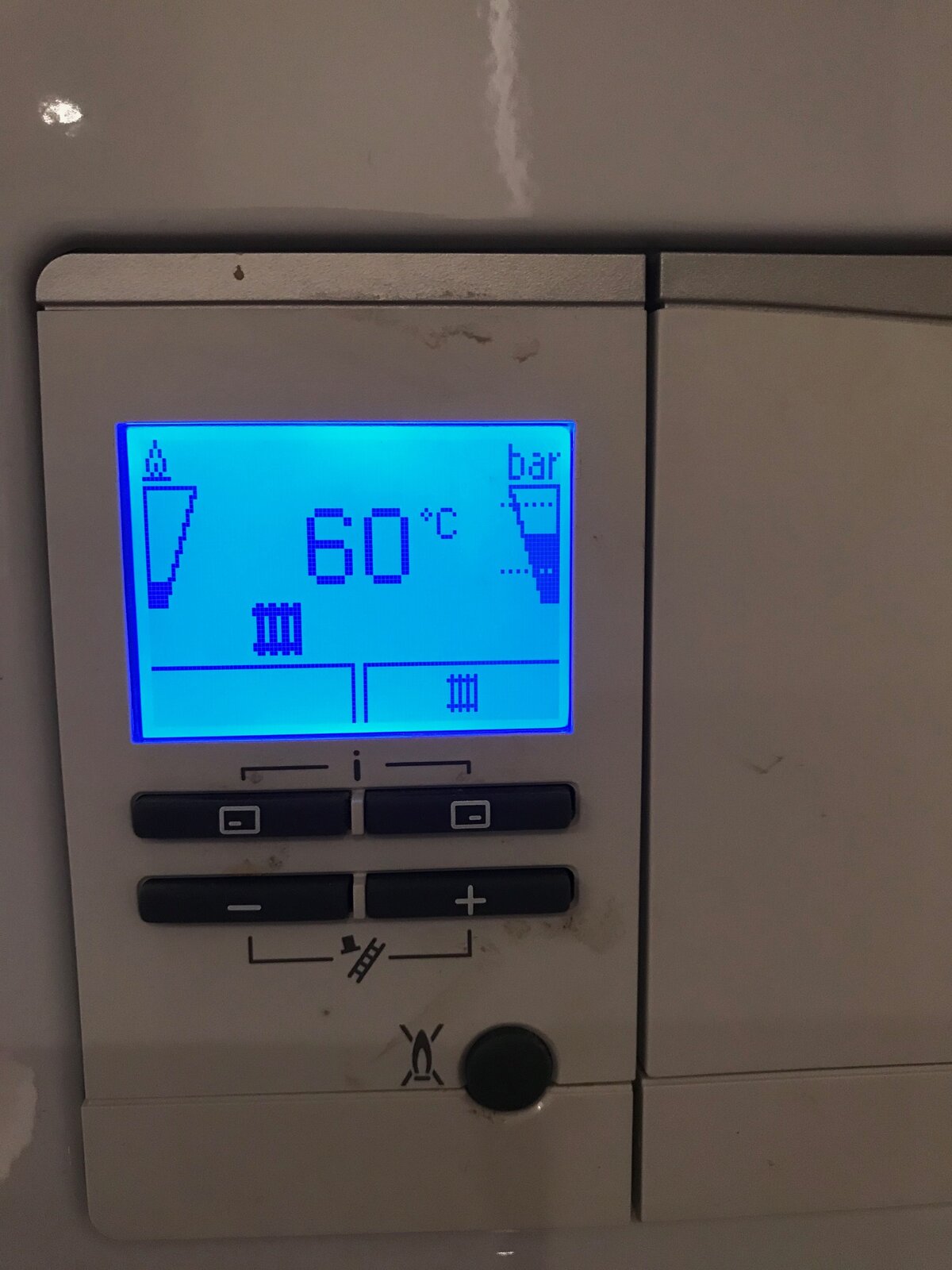

I assume your system is pressurised ,does boiler have a pressure gauge ?

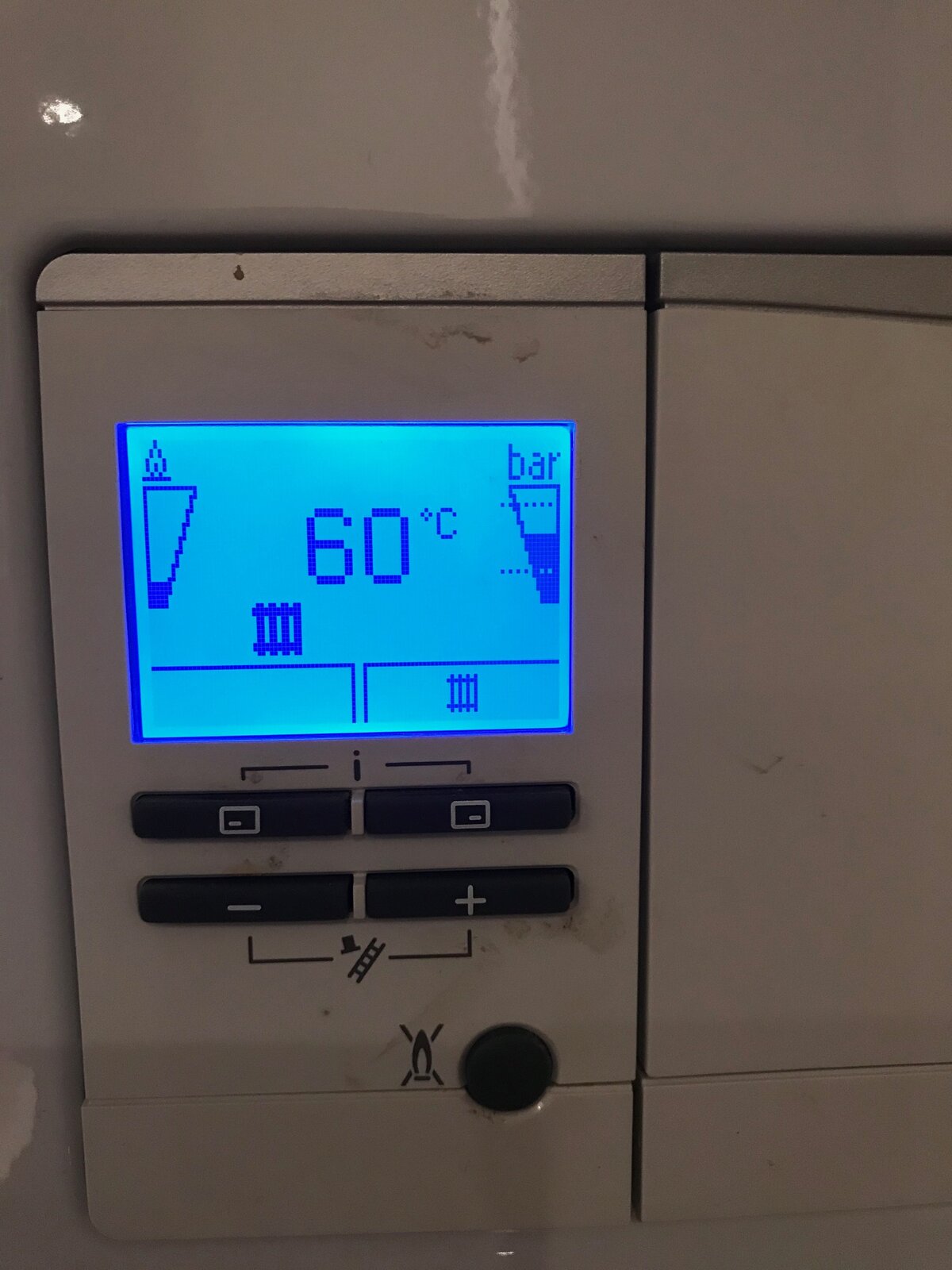

@terryplumb - the boiler has a pressure gauge, i am including a picture. The boiler is a vaillant one

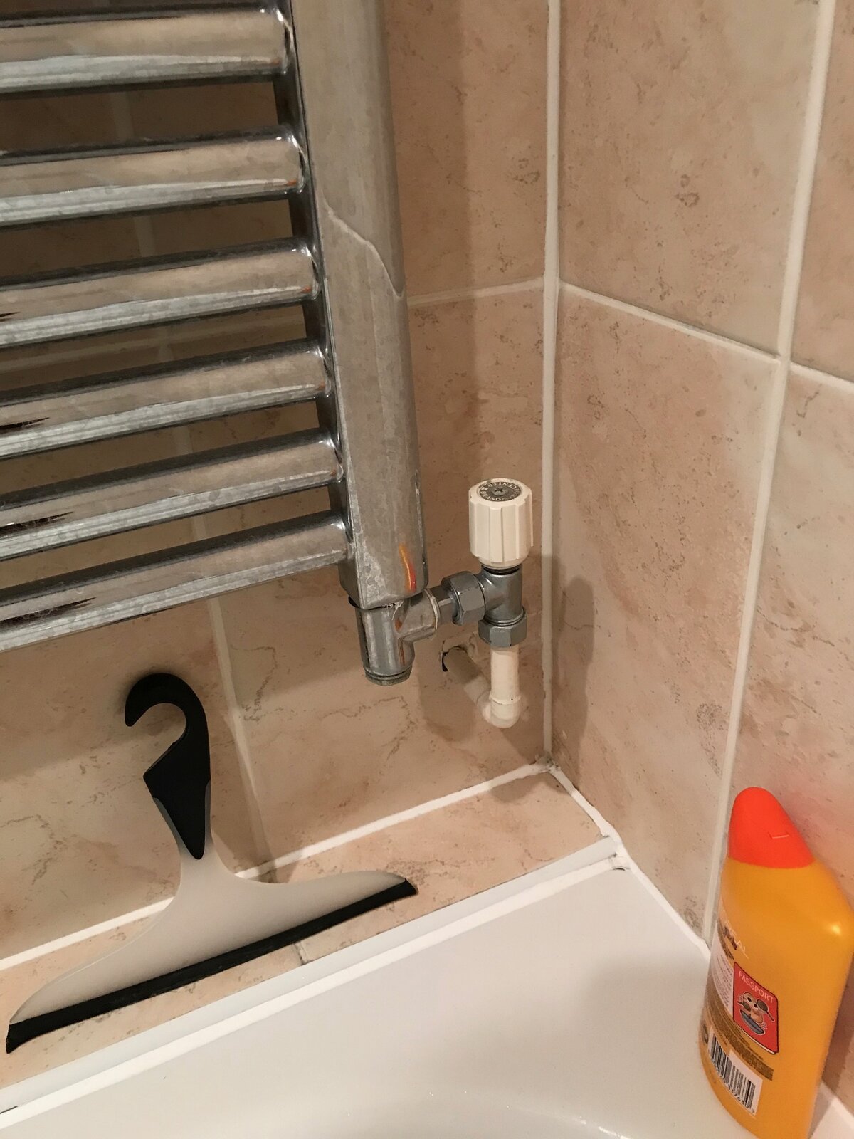

I tried to figure today how to turn towel rails off. there isnt a TRV on the rails. On either side of the towel rail there are two white caps which I can move clockwise and anticlockwise. are these the switches to turn the towel rail off? we have never turned towel rails off as during summers too we like towels to be warm. Because i dont know how to turn towel rails off I was not able to do the troubleshooting you mentioned.

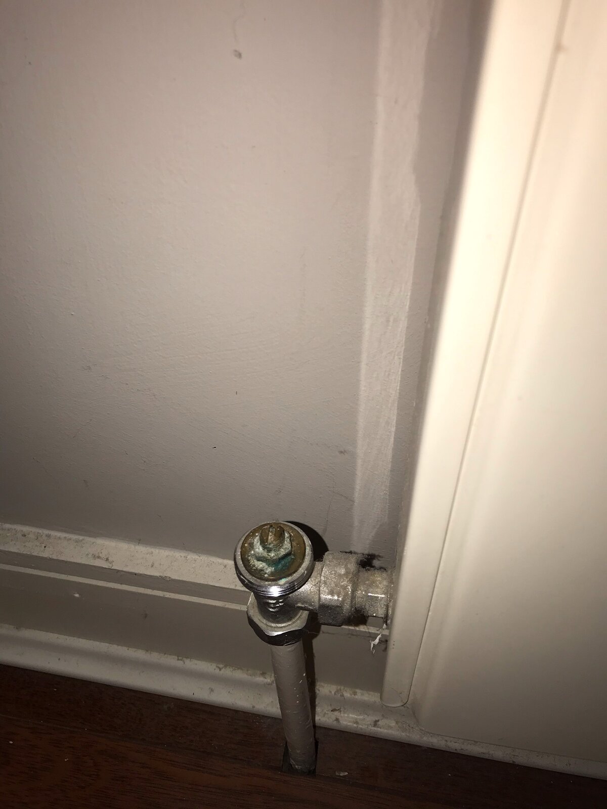

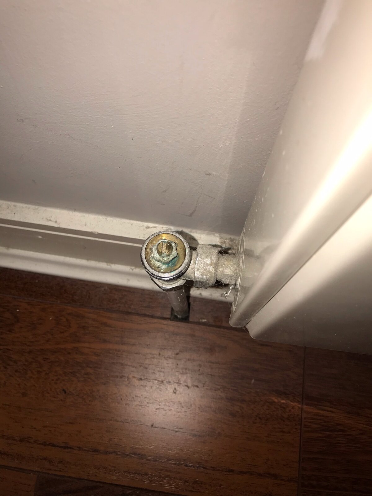

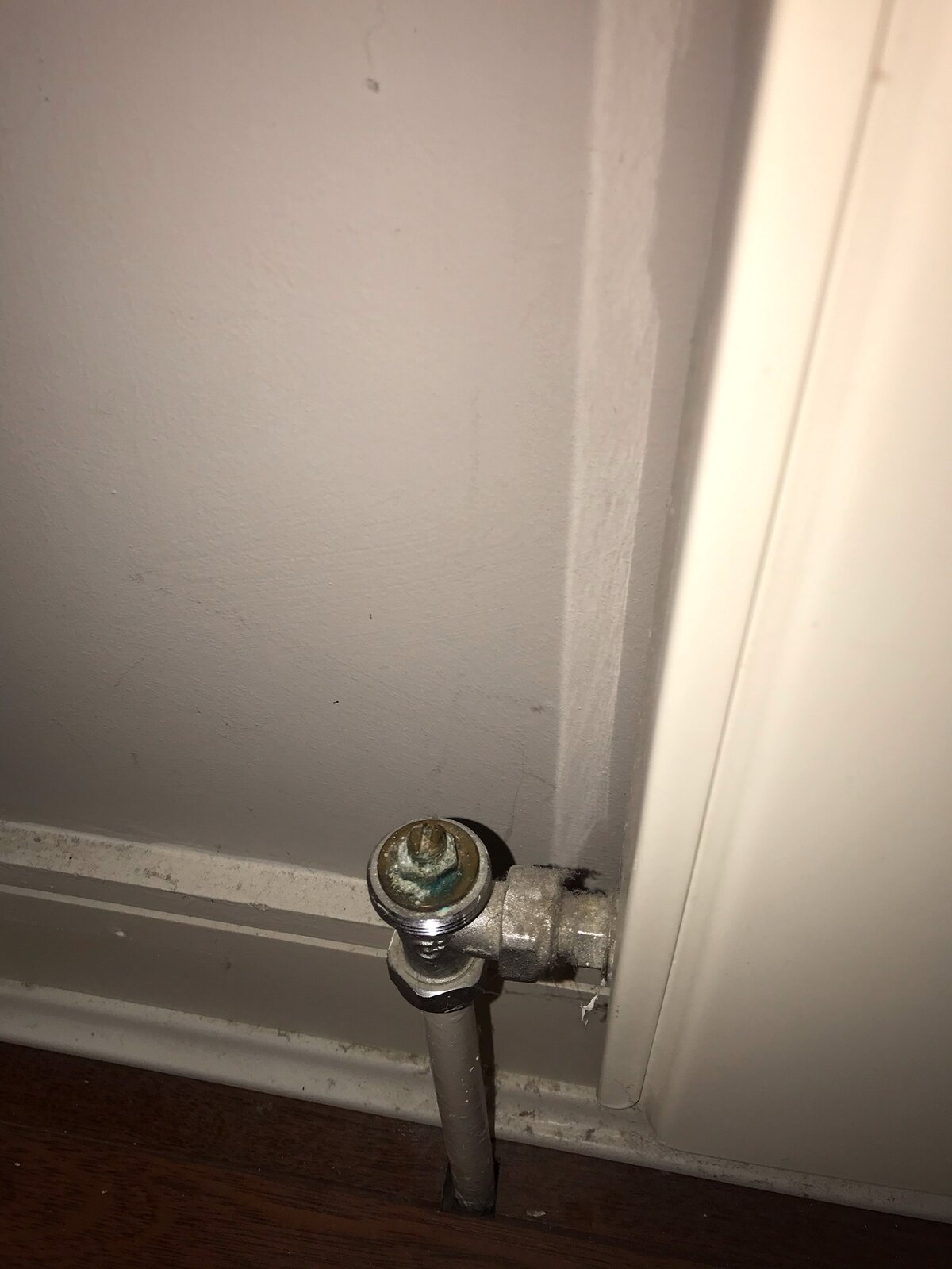

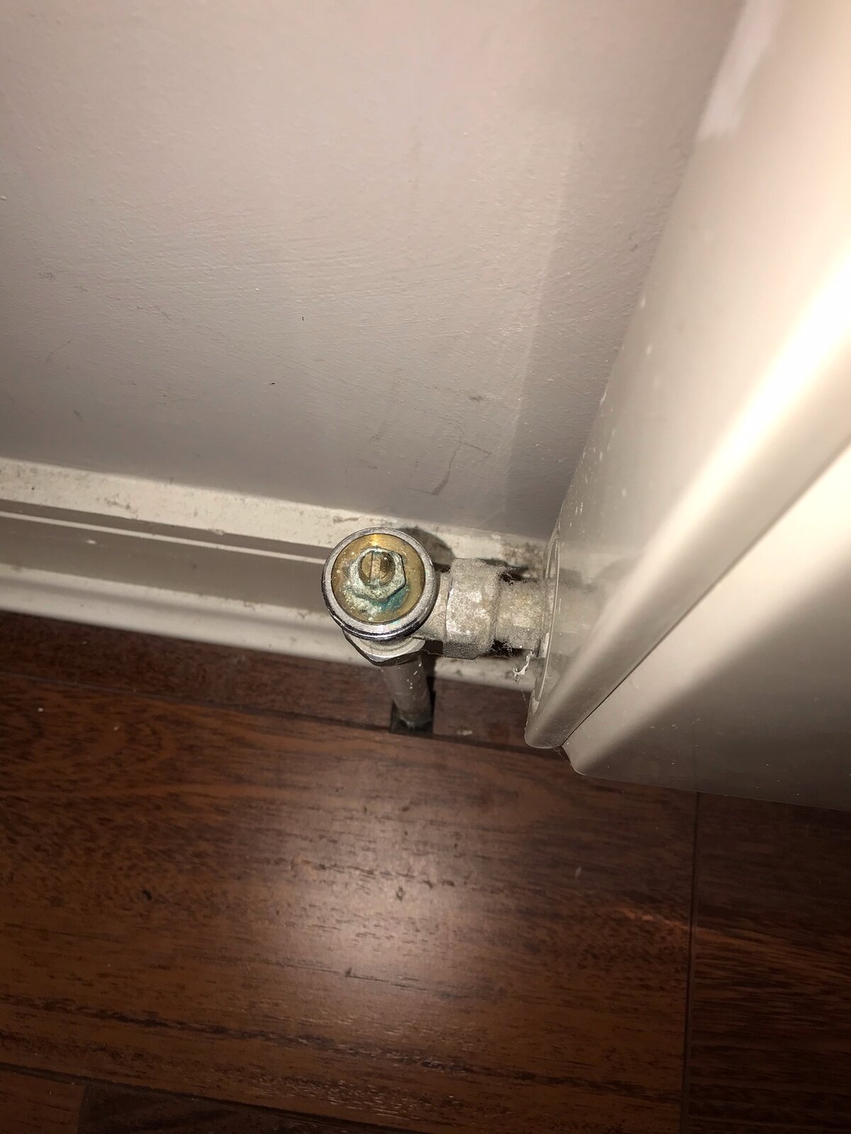

finally on the lockshield - i tried to free the valve its jammed up like hell. Also it is not a hexagon-ish shape that i see on youtube videos. ours has a screwhead and with a screwdriver there is no way i can move it. picture attached. Shall i try to get a Wd 40 style lubricant and try? Also - should i try to move this with a scredriver or pliers?

also given that this valve won't budge, i feel it could well be stuck..If you look at the picture, you will see it hasnt been touched in ages and has this greenish-white tinge to it
To adjust that valve you need to undo the nut using a spanner first and then rotate the screw.
I doubt this is the source of your problem, unless it is block with debris.
The bathroom valves, turn them clockwise to close, and anti clockwise to open.
The flow to the towel Rad should be fully open, and the return should be open around a quarter turn (might be more or less when balancing the system properly), however when experimenting just close the return only.

The two towel rads need one of their valves closing. A pic would be good ,but your description sounds like a wheel head. They close by turning fully clockwise.

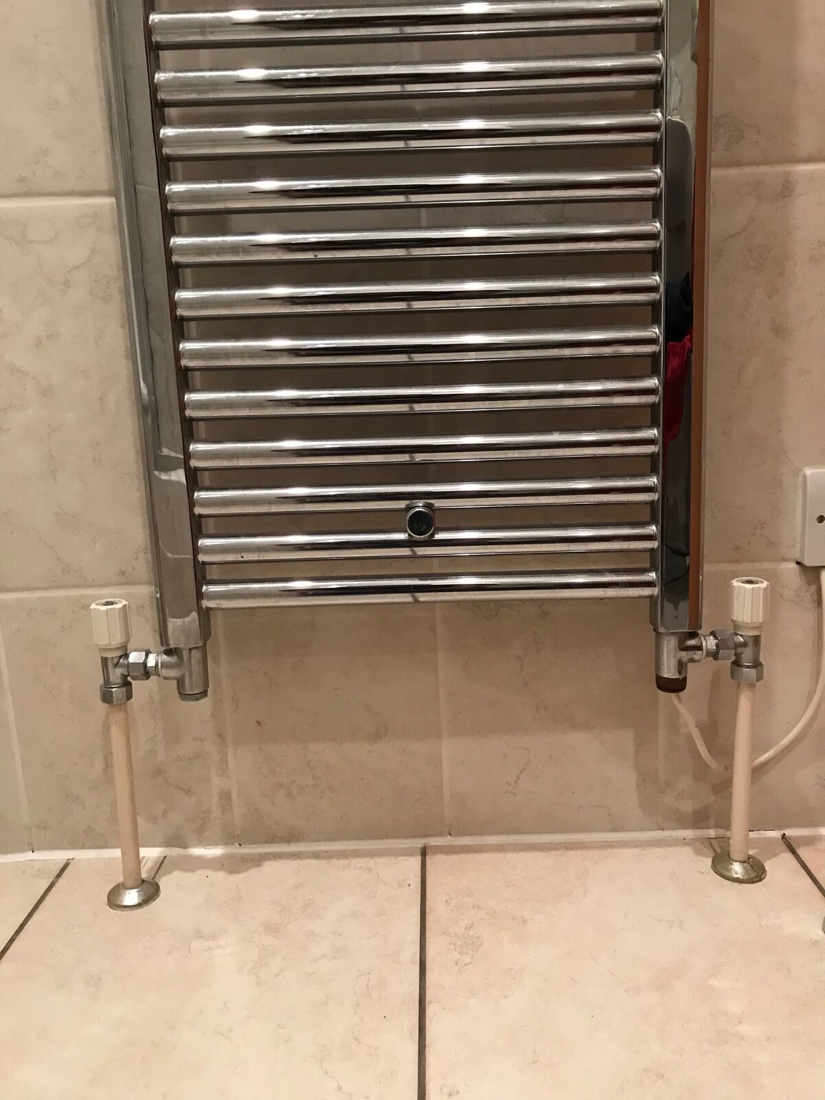

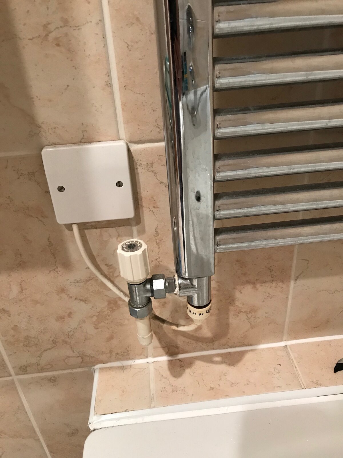

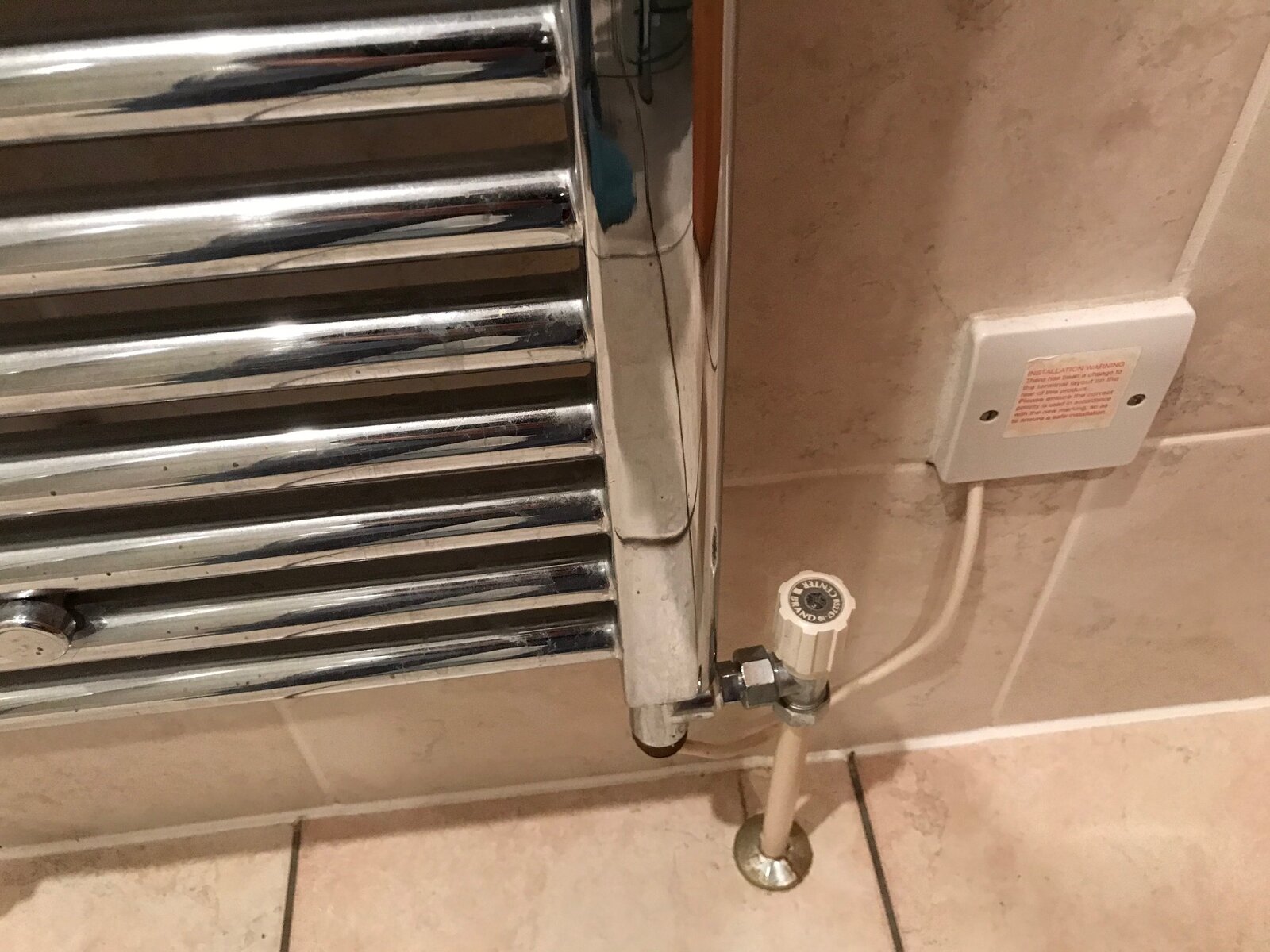

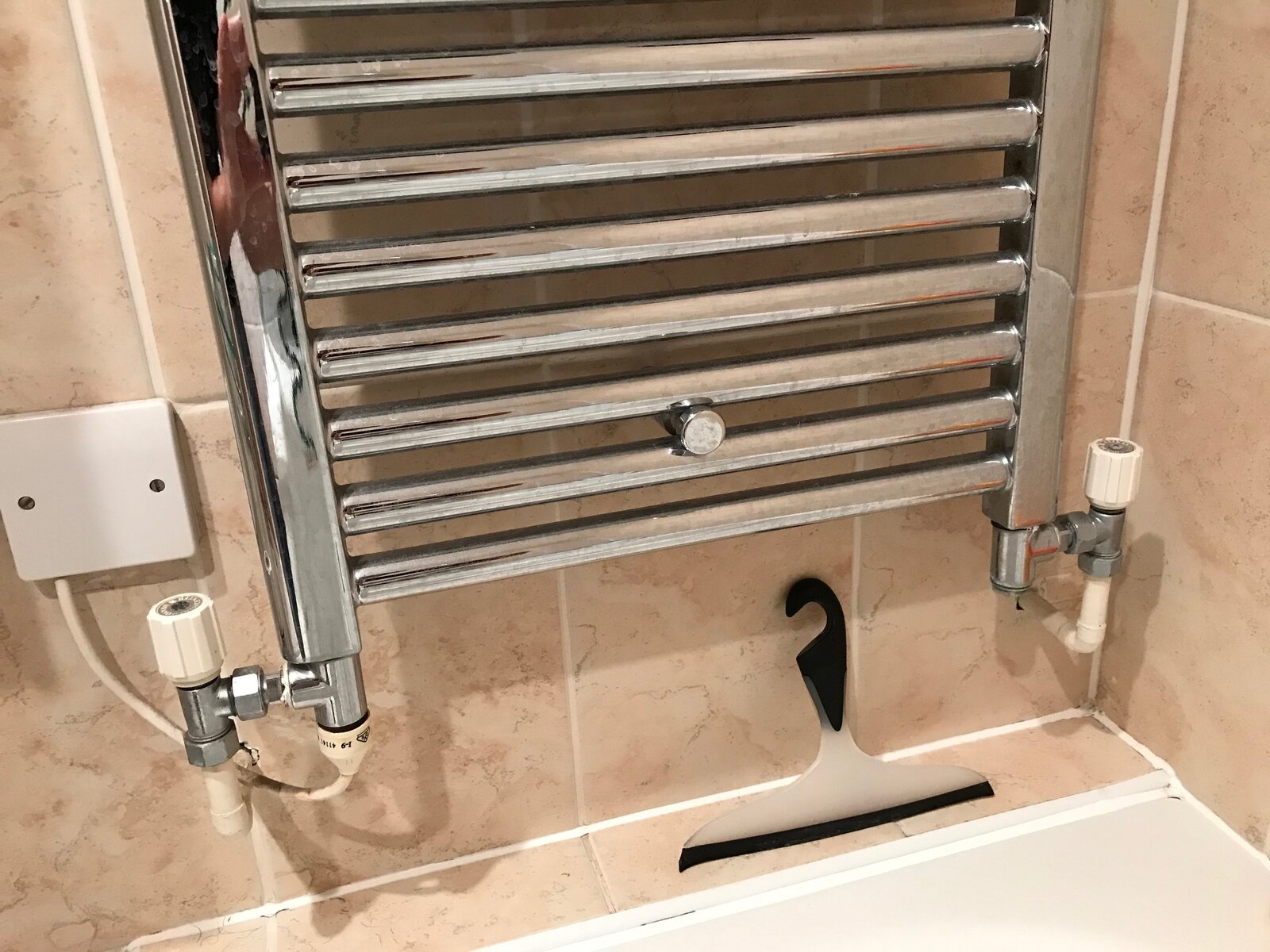

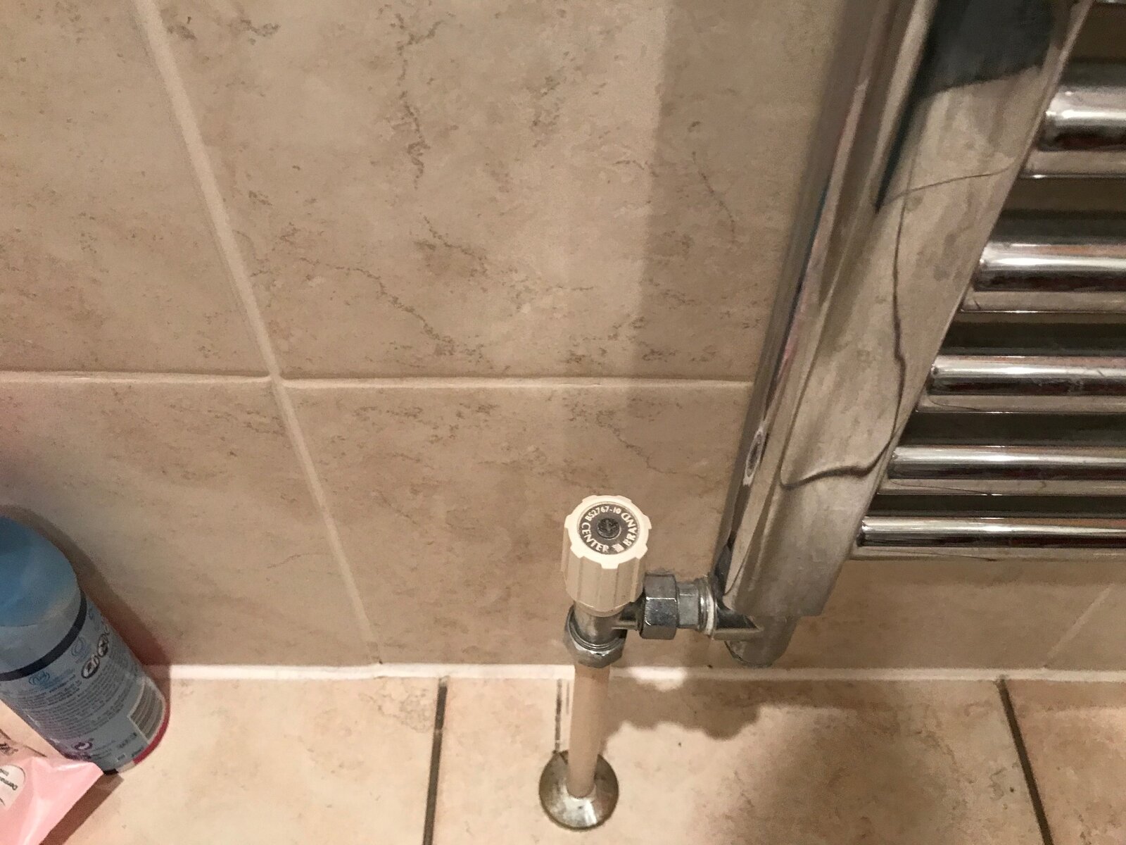

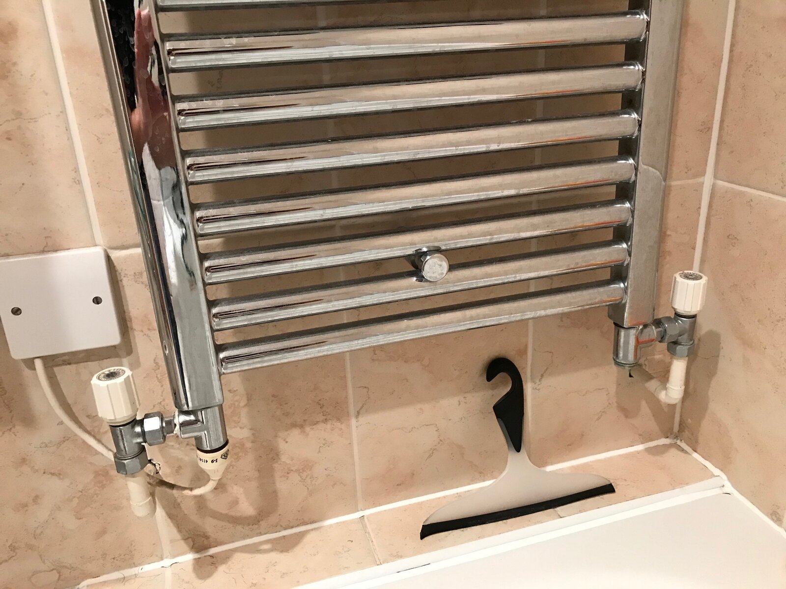

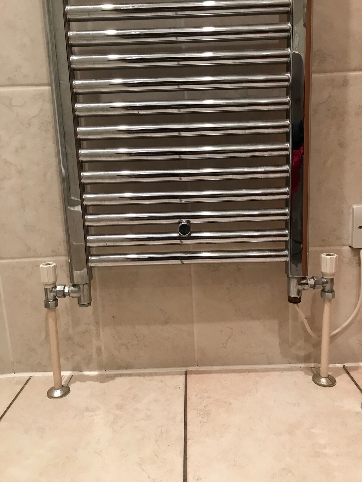

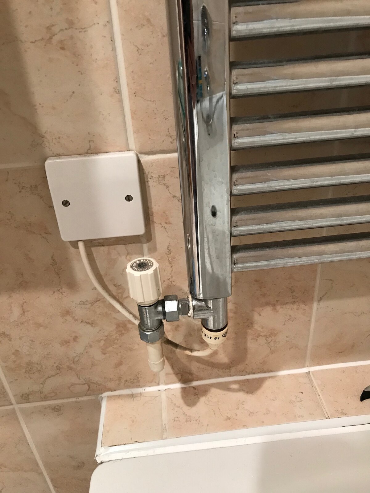

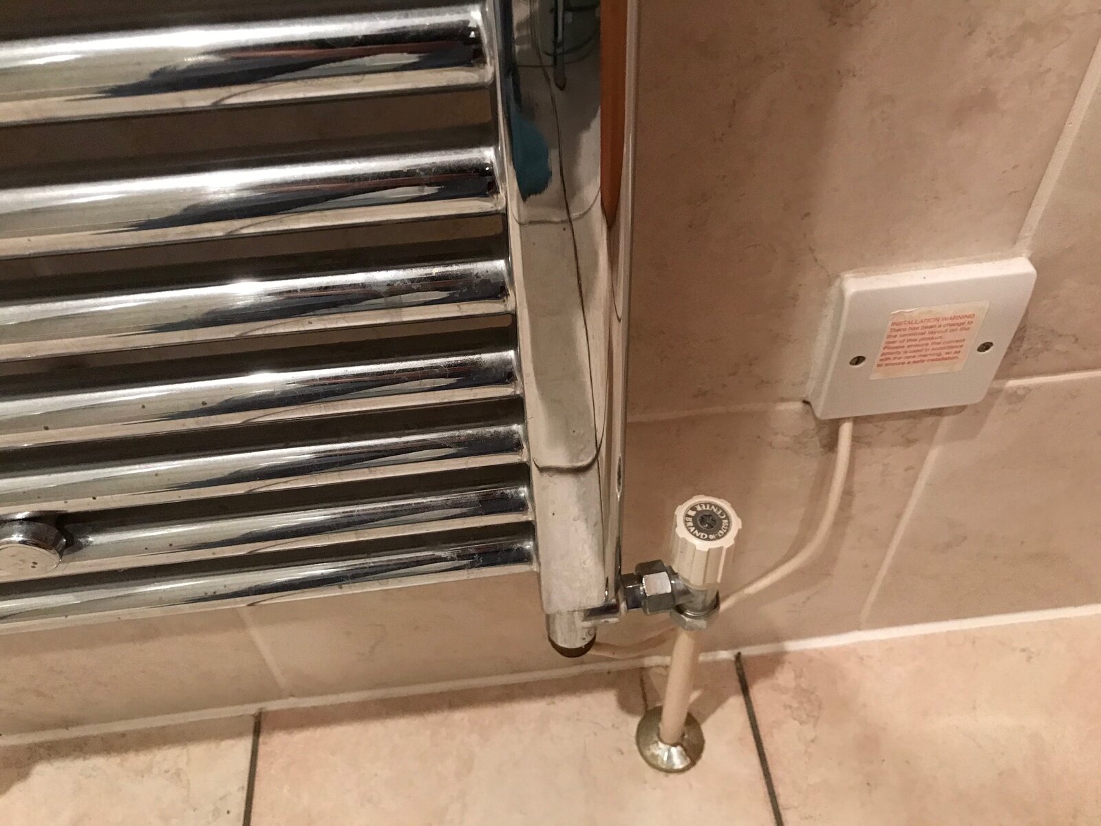

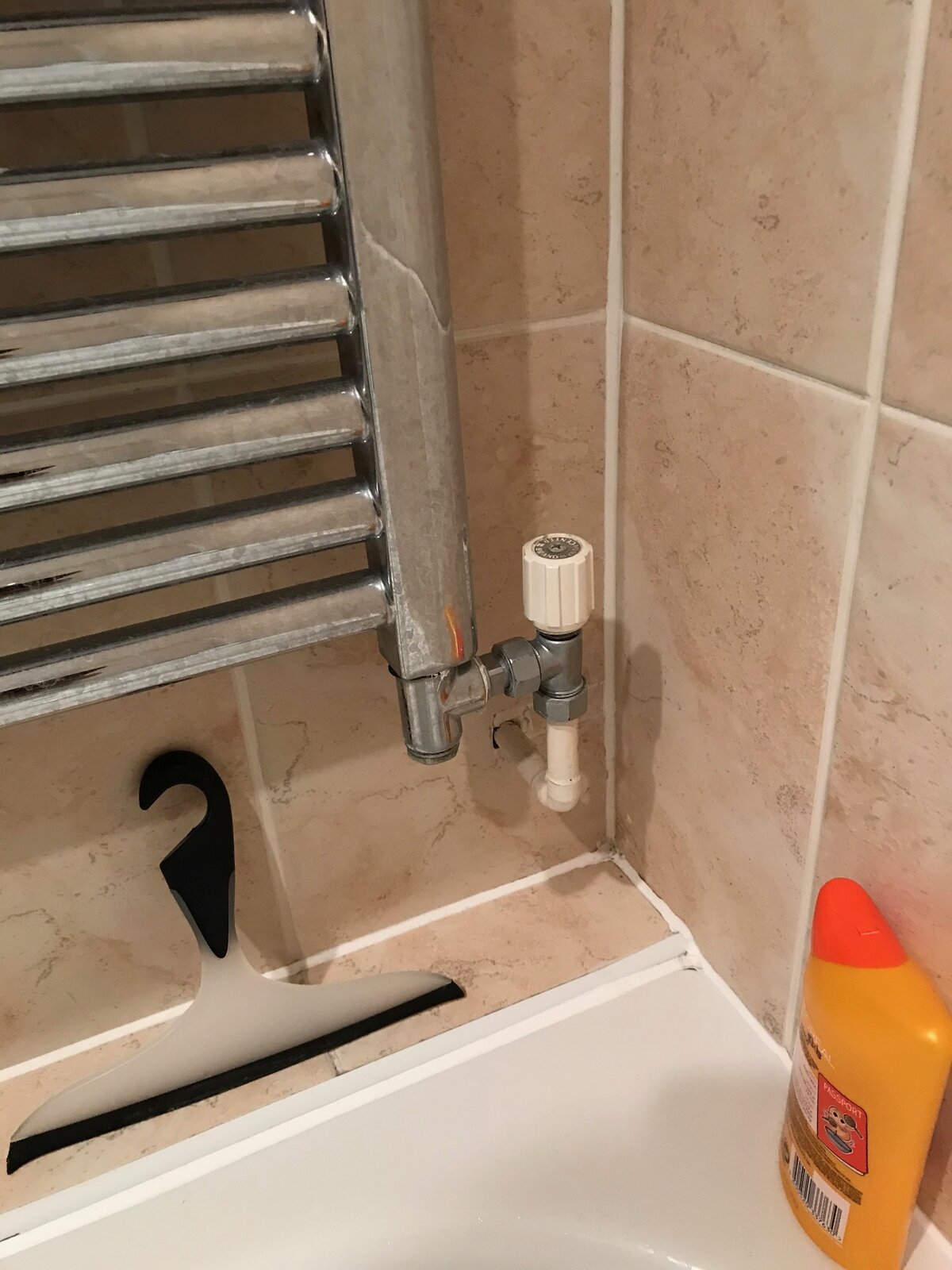

pictures of towel rails attached from both bathrooms, seems identical set up in both bathrooms. On either side of the Towel rail, the white caps ARE moving. Let me know which one I need to turn clockwise.
And you are right sir , we have not touched lockshield or TRV ..I didnt know the word 'lockshield' till last evening when it was mentioned on this thread :) Let's do this experiment. After this TRV should be the only thing left i suppose.

The pipe that gets hot first should be fully open (counter clockwise), the pipe that is cooler, heats up later should be almost fully closed, opened by 1/4 turn

You can close either of the valves on towel rads. Do the left hand valve on each towel rad ,and make a note of how many turns it takes on each . That will enable you to open them,later on , back to their original positions.
