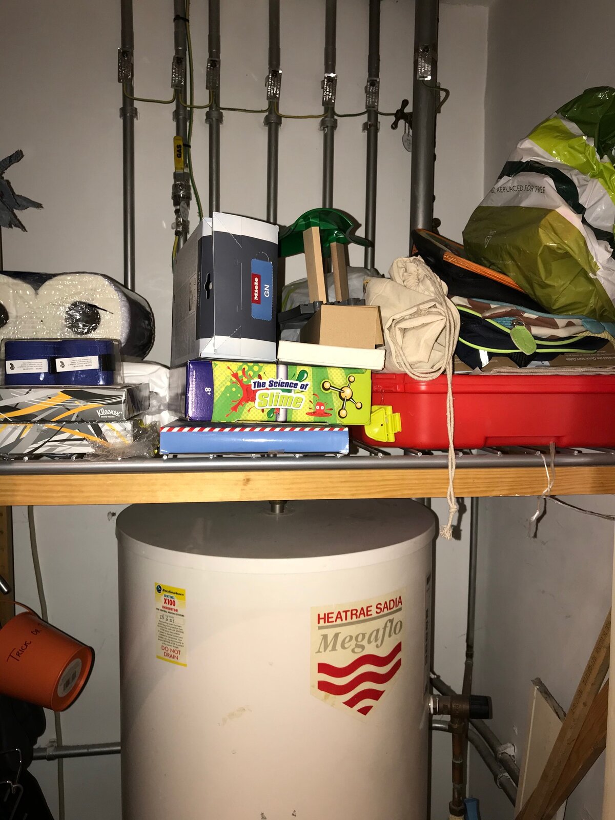

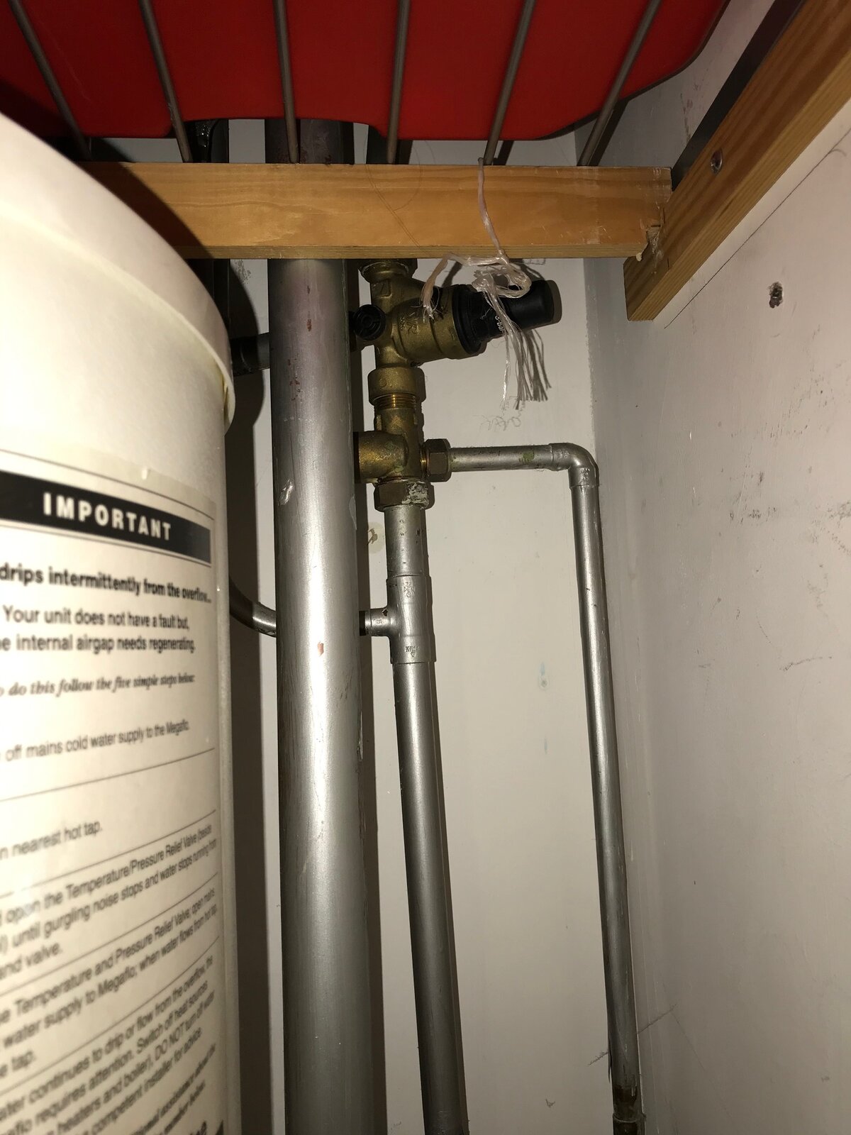

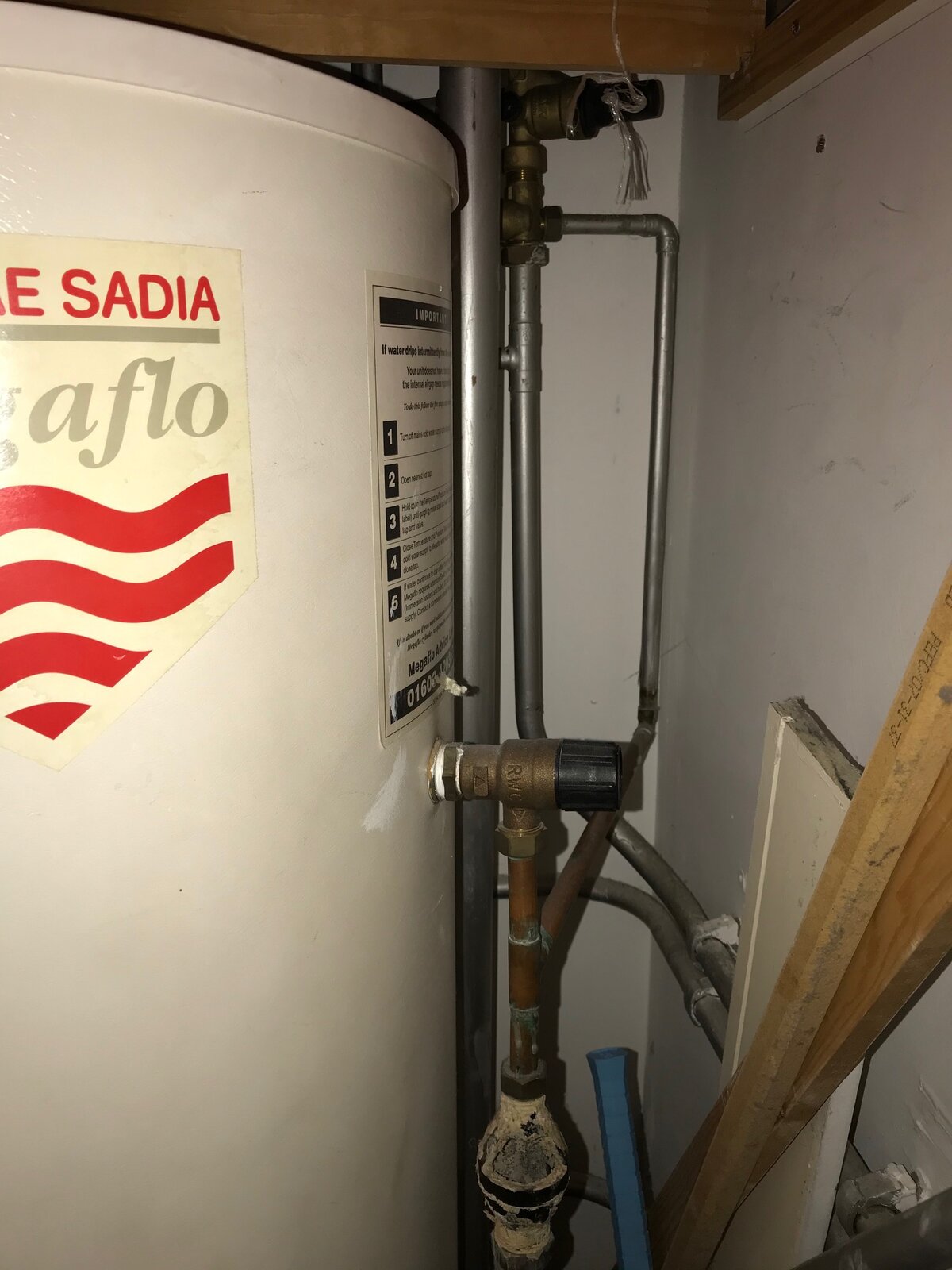

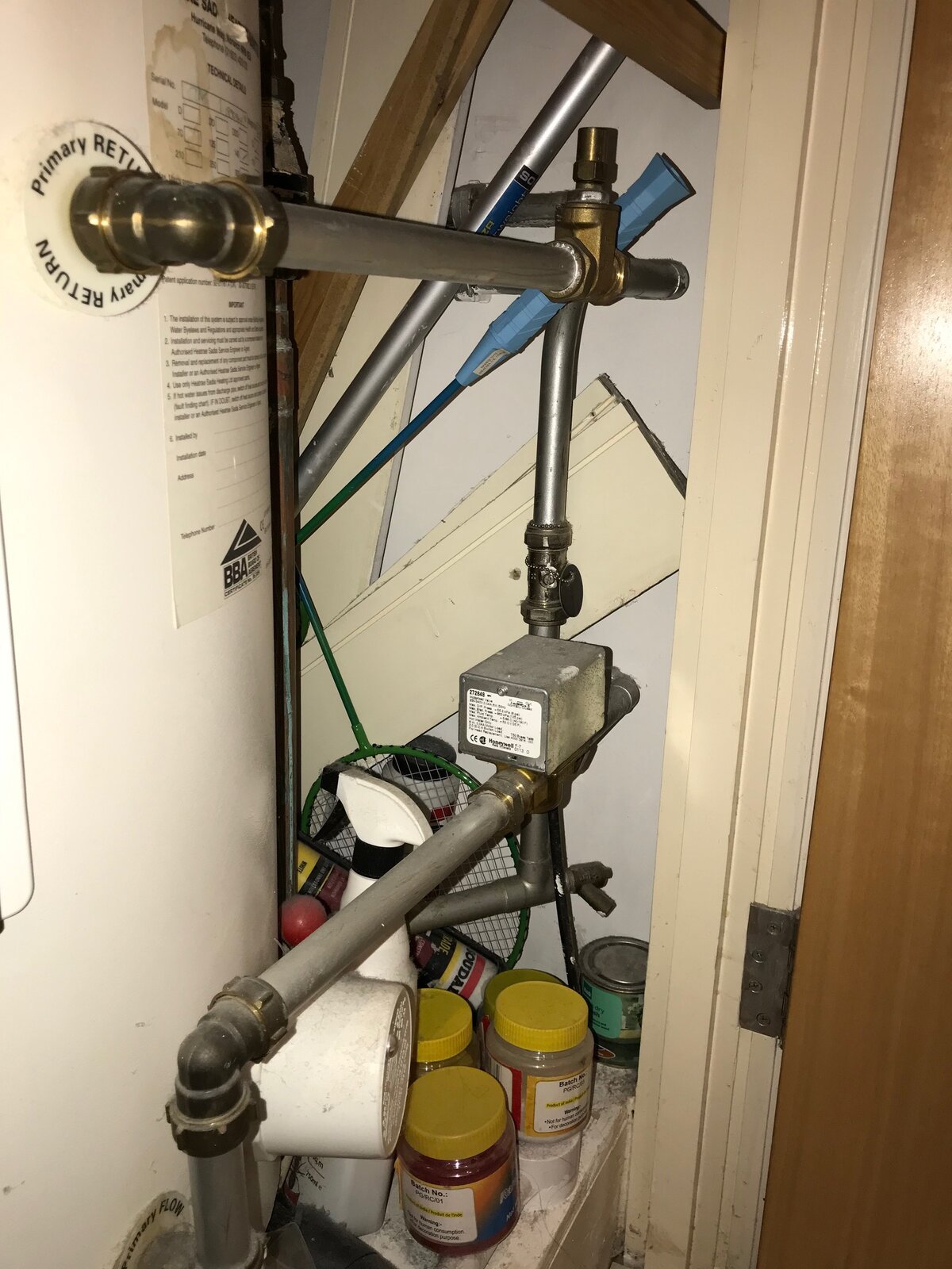

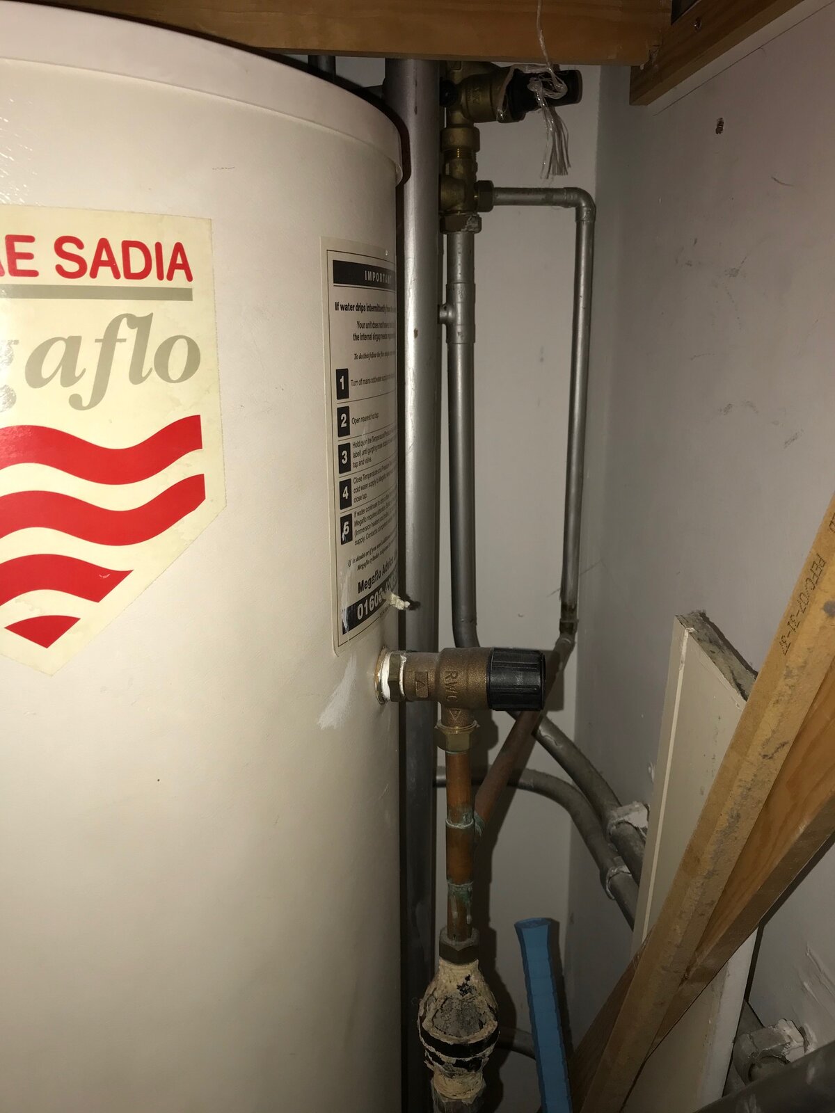

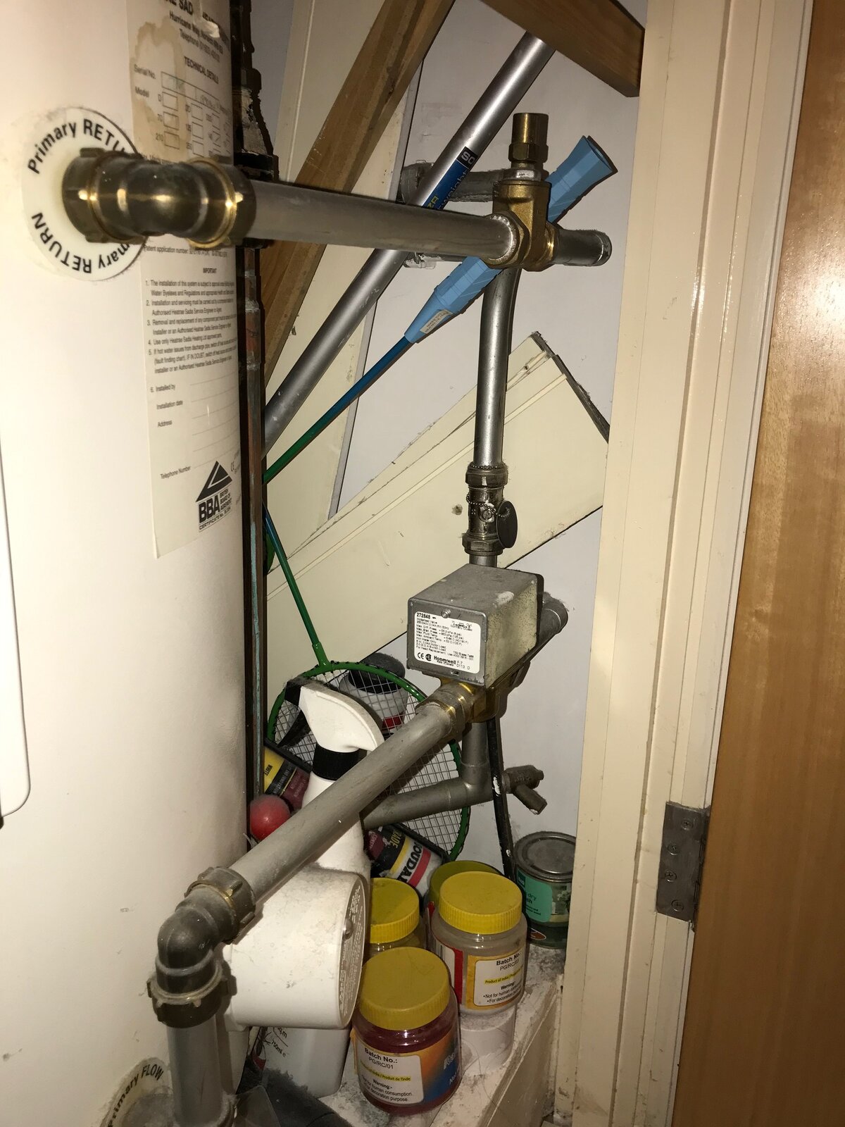

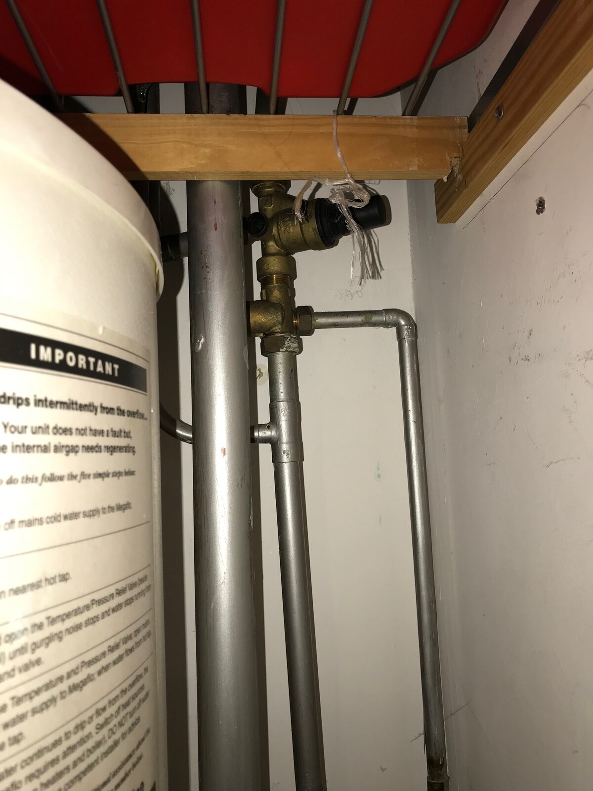

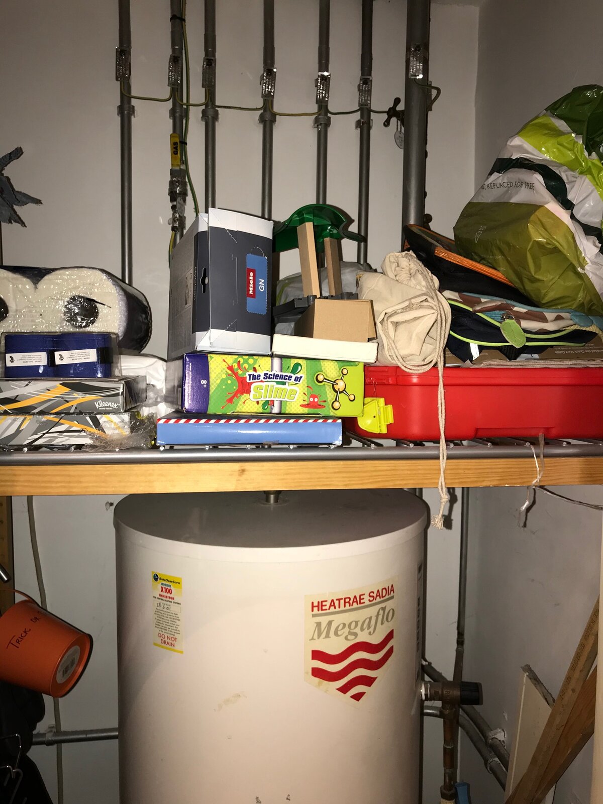

Show us pics of all pipework / valves / plumbing around your hot water cylinder.
If your radiators were all working fine last year ,then something, that your not telling us about ,must have been done to alter the systems balance. Turning off TRV' s and opening them again after a few months wouldn't do it .
Hmm. I went through the thread again to check if i missed any details. There are 2 i feel could help. Last year, relatively speaking, those 2 rads weren't as effective as rest of the flat. They weren't 'cold' like this year but other rooms felt better. In 2019, there was a mains water valve replaced to improve pressure across the property. But that was on water mains coming into the property. besides these 2, I really can't think of anything. Boiler has had the annual service in both 2019 & 2020 and & nothing was flagged in those.
I am enclosing 4 pictures of the pipes around the boiler. Let me know which section you want me to get more detailed pictures for. There are a lot of pipes, i can get the details you need.

You have a 3 way valve, this is faulty and is why your radiators heat up with the hot water in the summer.
Is it only the two towel radiators that heat up when programmer is set to domestic hot water only ,or other rads as well ?
Also, how urgently do i need to get this valve fixed? Can this wait till march or April? I am hoping Covid is spreading less by then.
Also - shall I proceed with the re-balance and for that use the WD 40 thing?
It can wait ,it's been like that for several months so a few more is neither here nor there.
I wouldn't tinker with the balancing until the 3 port valve is changed .

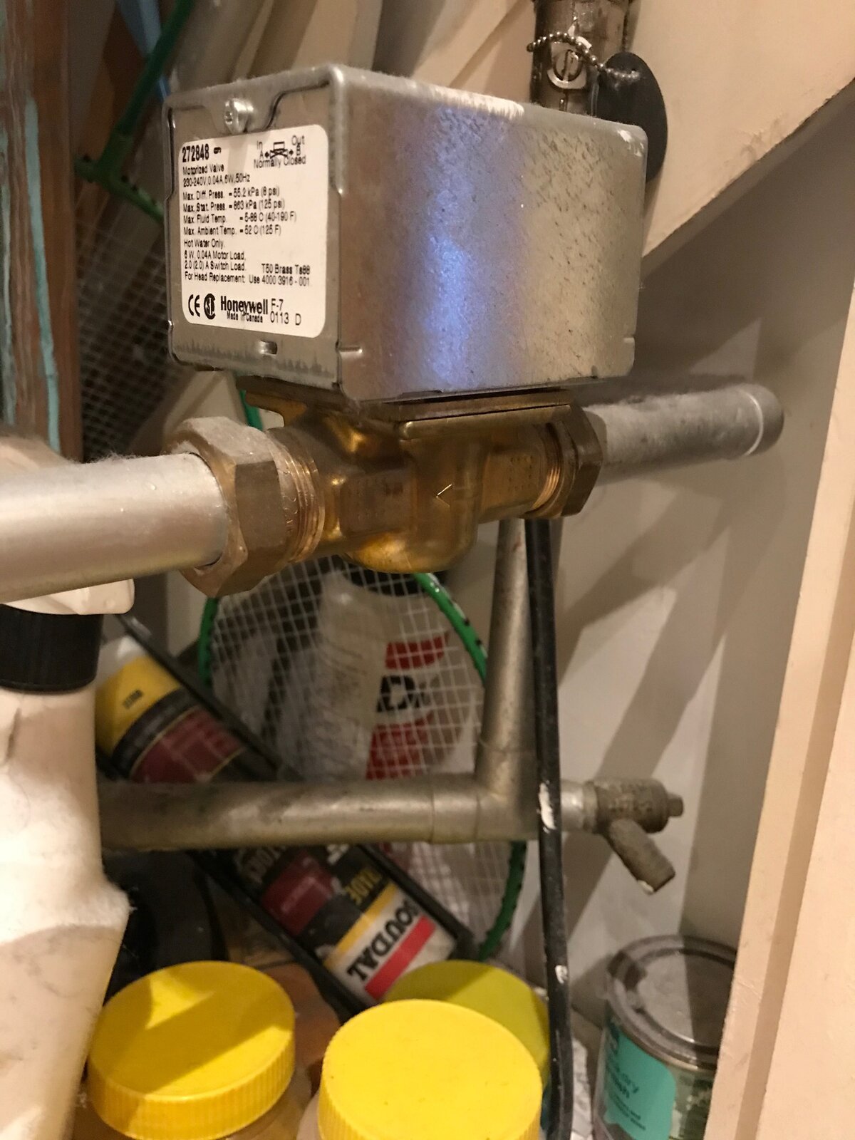

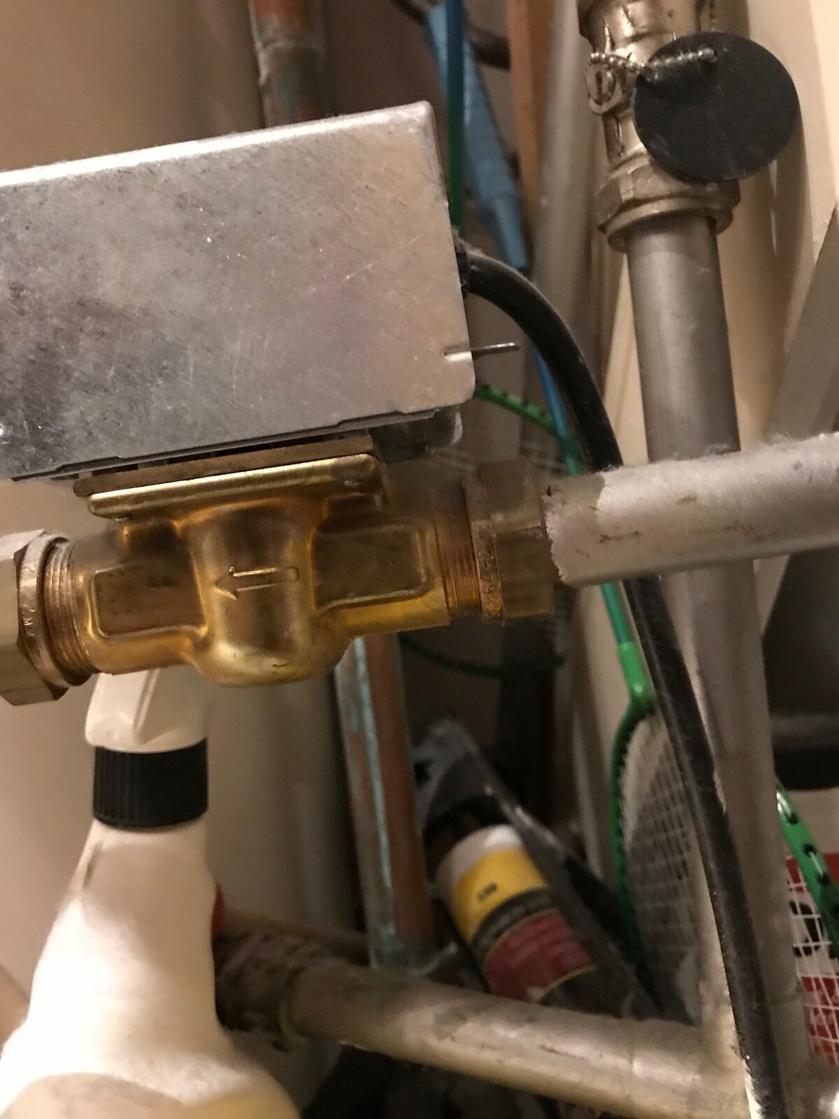

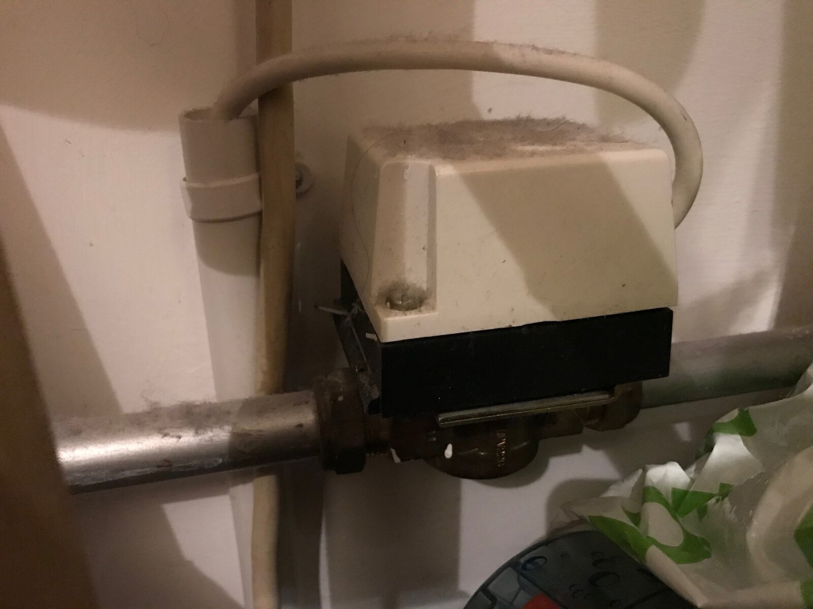

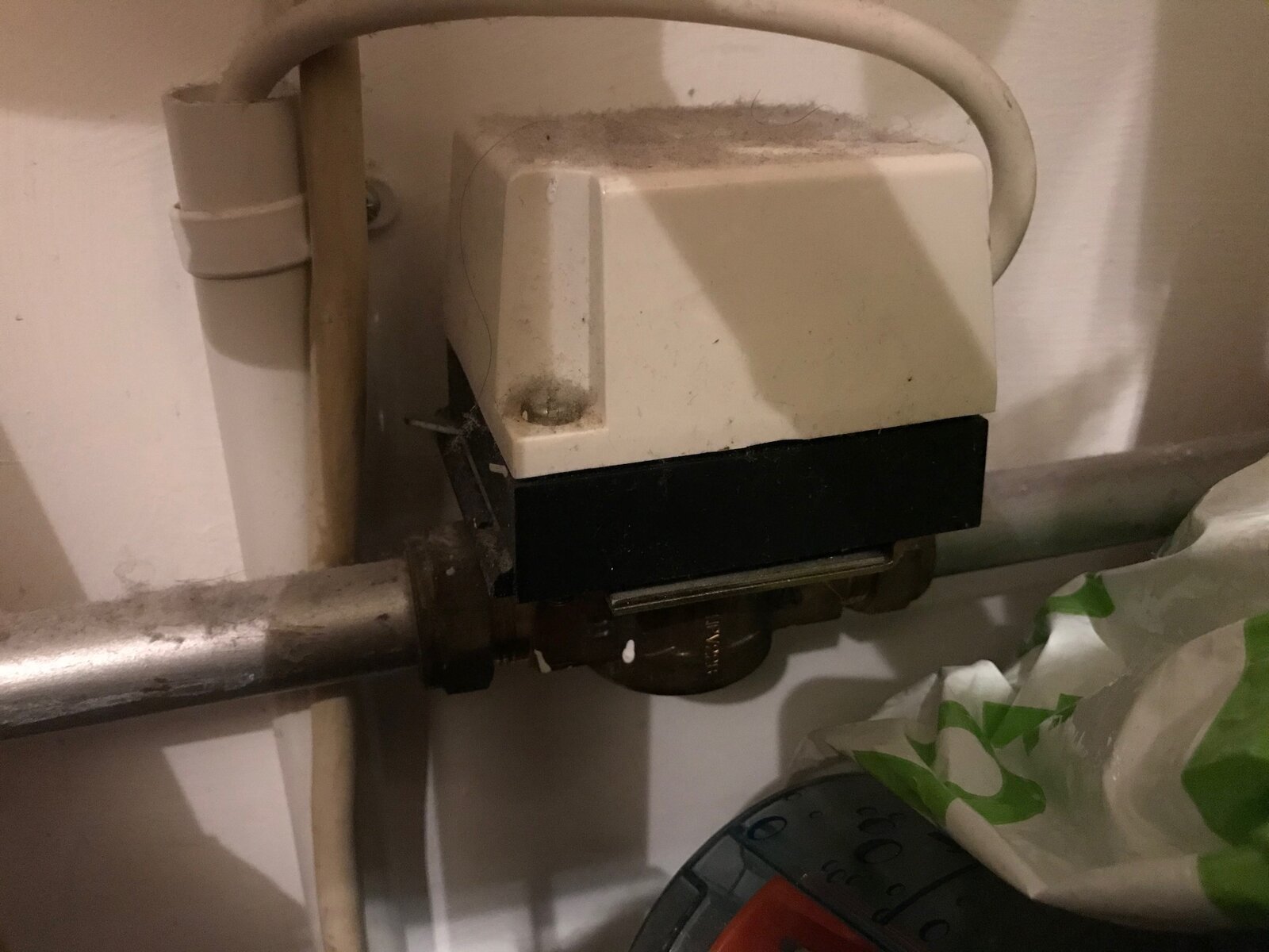

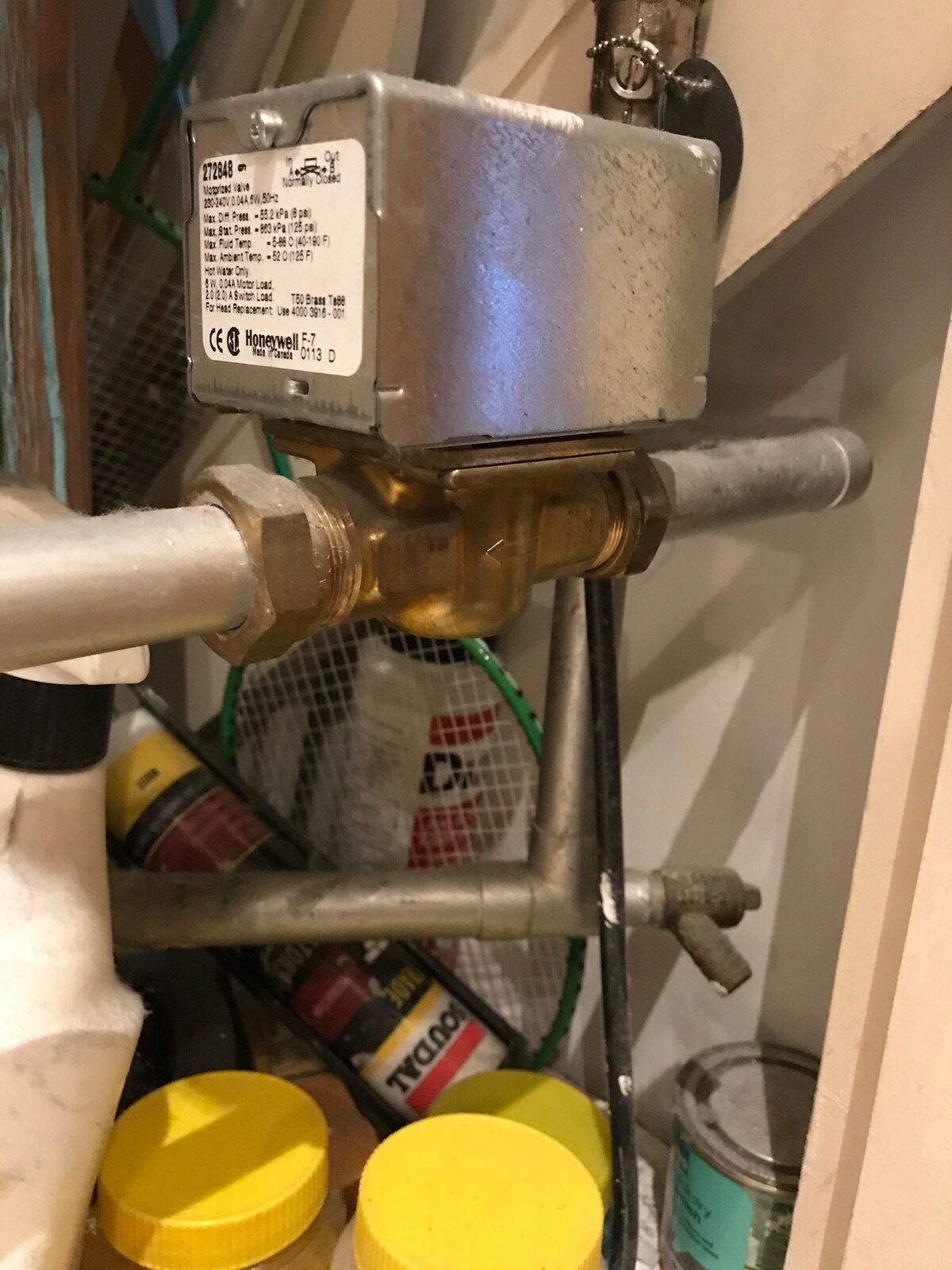

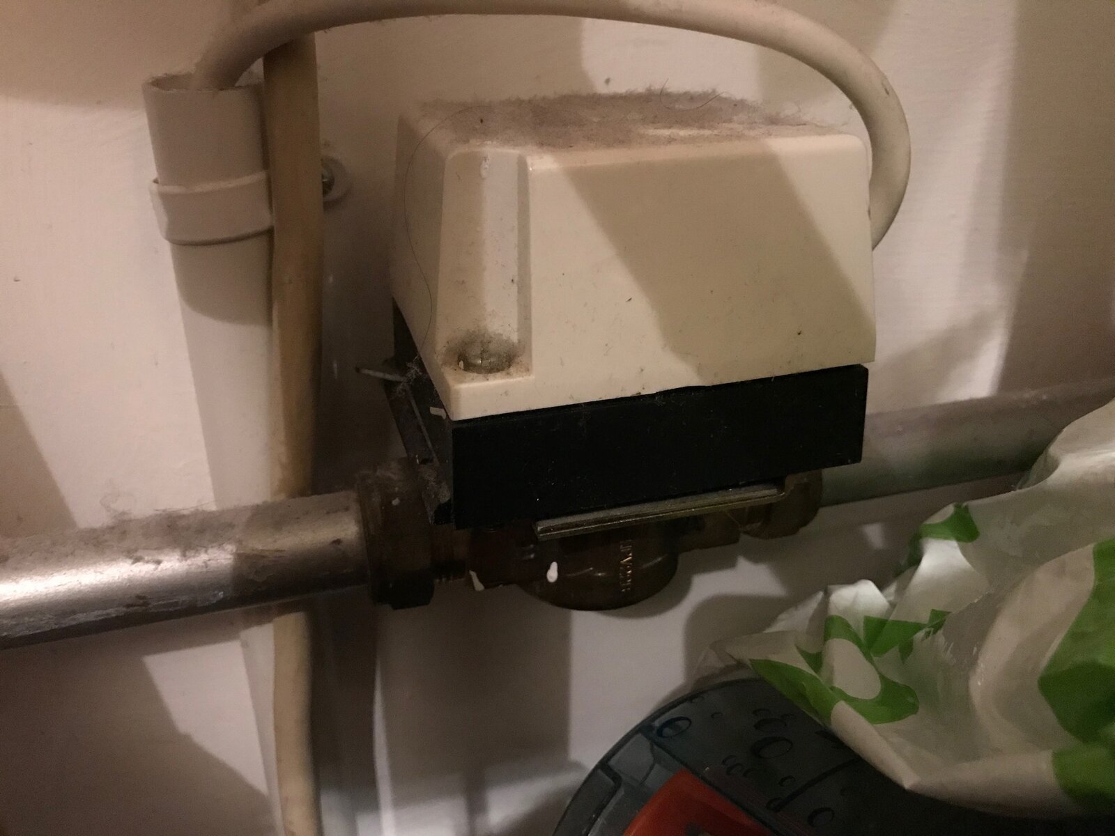

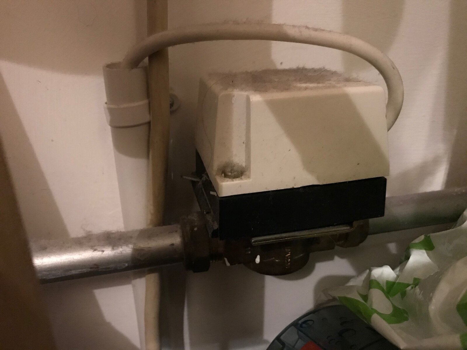

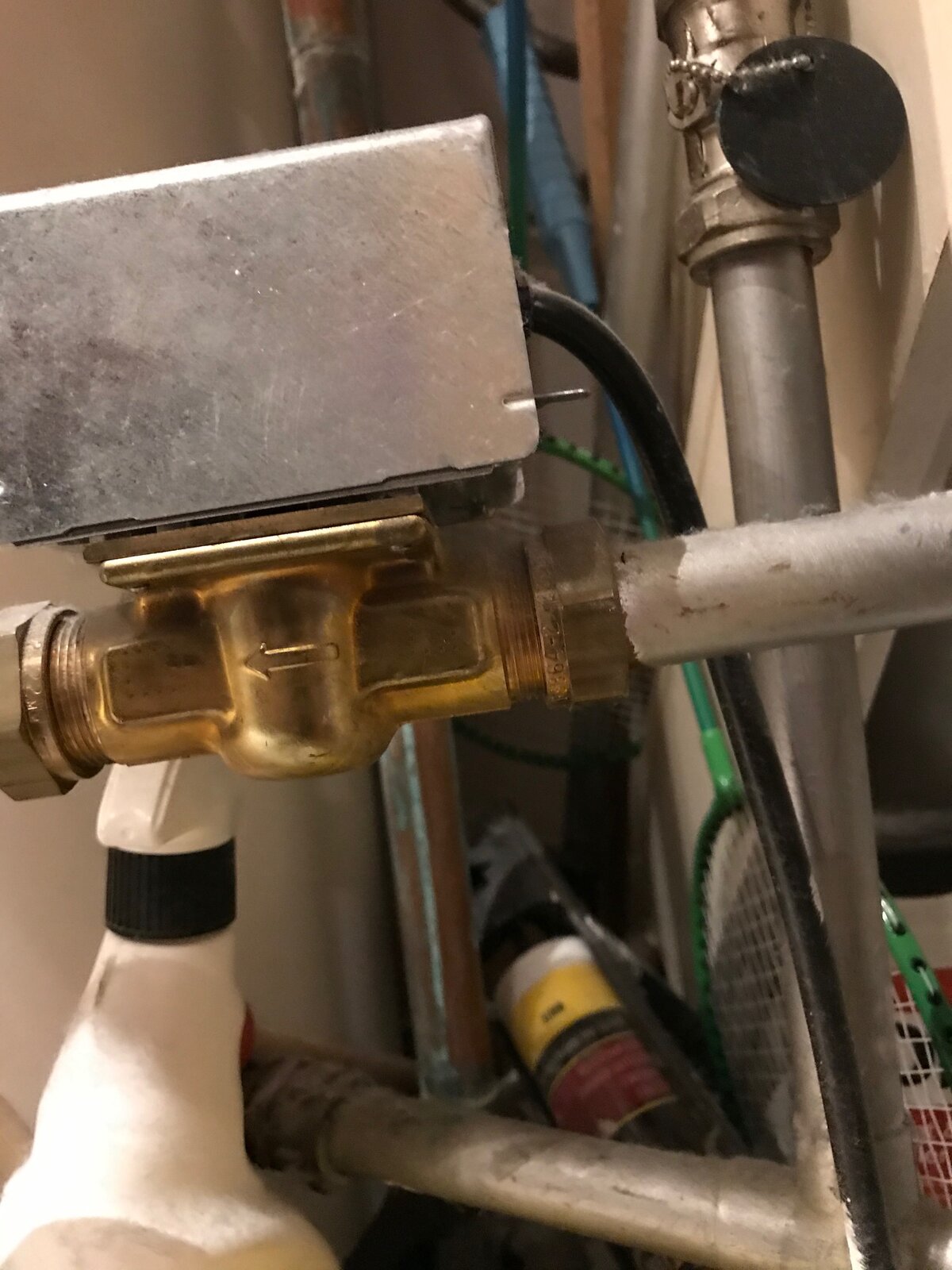

Ok, one more clarification. I am doing the pictures of the pipework near boiler again. It seems that i dont have a 3 way valve and could have seperate 2 way valves for gas & heating respectively. Pictures attached.
Yep ,two zone valves . One for domestic hot water ,silver one ,and one for central heating radiators. Engineer required to do some testing !!
