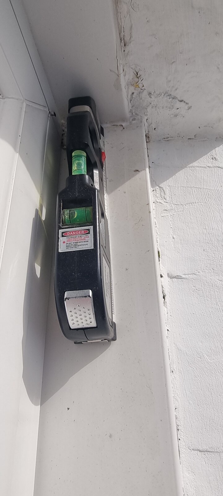

If you have spirit level, perhaps sit it on the cill see if it angles down to your wet patch (sounds wrongo_O).
Wet patches are on both corners of each window that leaks. It's only 3 out of 20 windows with this issue, and the others don't seem and different in terms of placement.

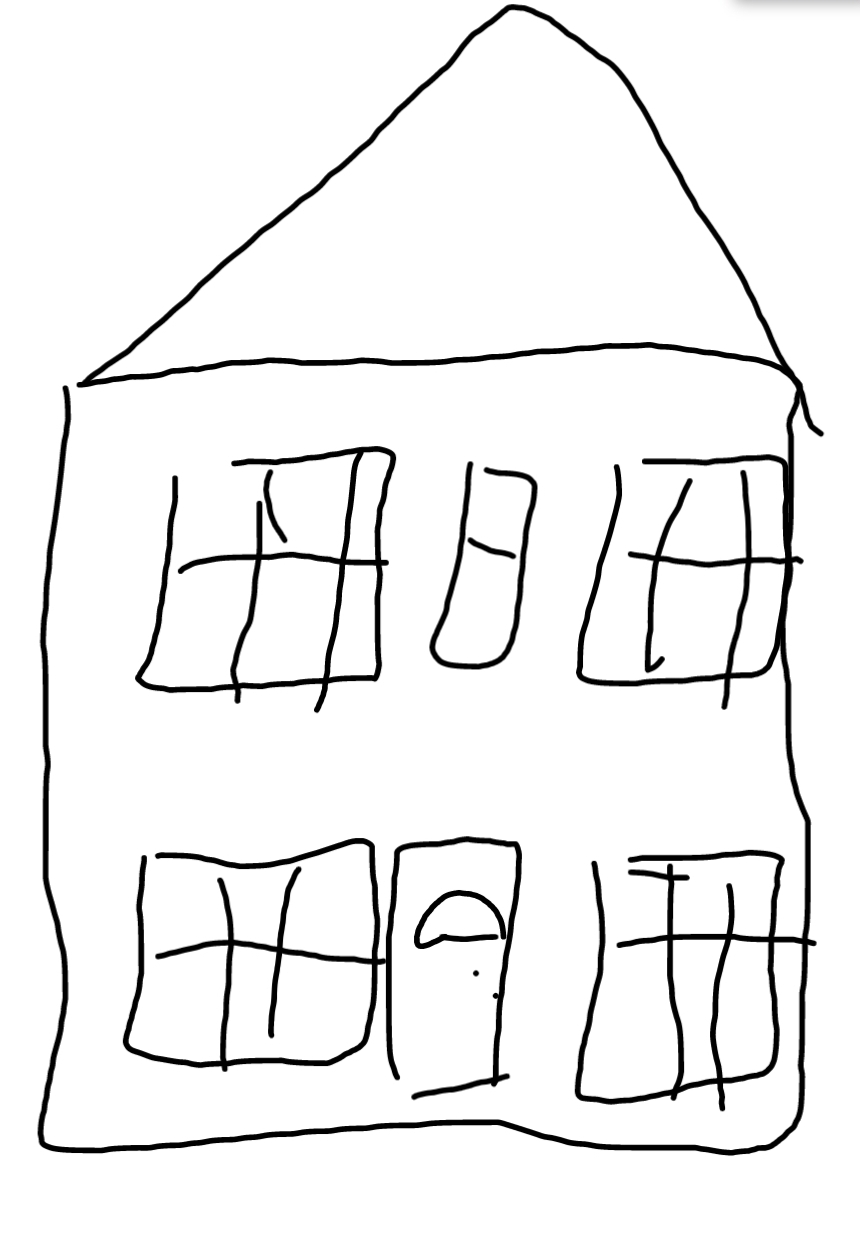

Problem is, if these are moved forward, then every window in the house (are at least on the same side of the house) will need moving forward to suit, or it'll look sh1te.
Front of the house is like a picture a kid would draw. It's a lot of work to move them:

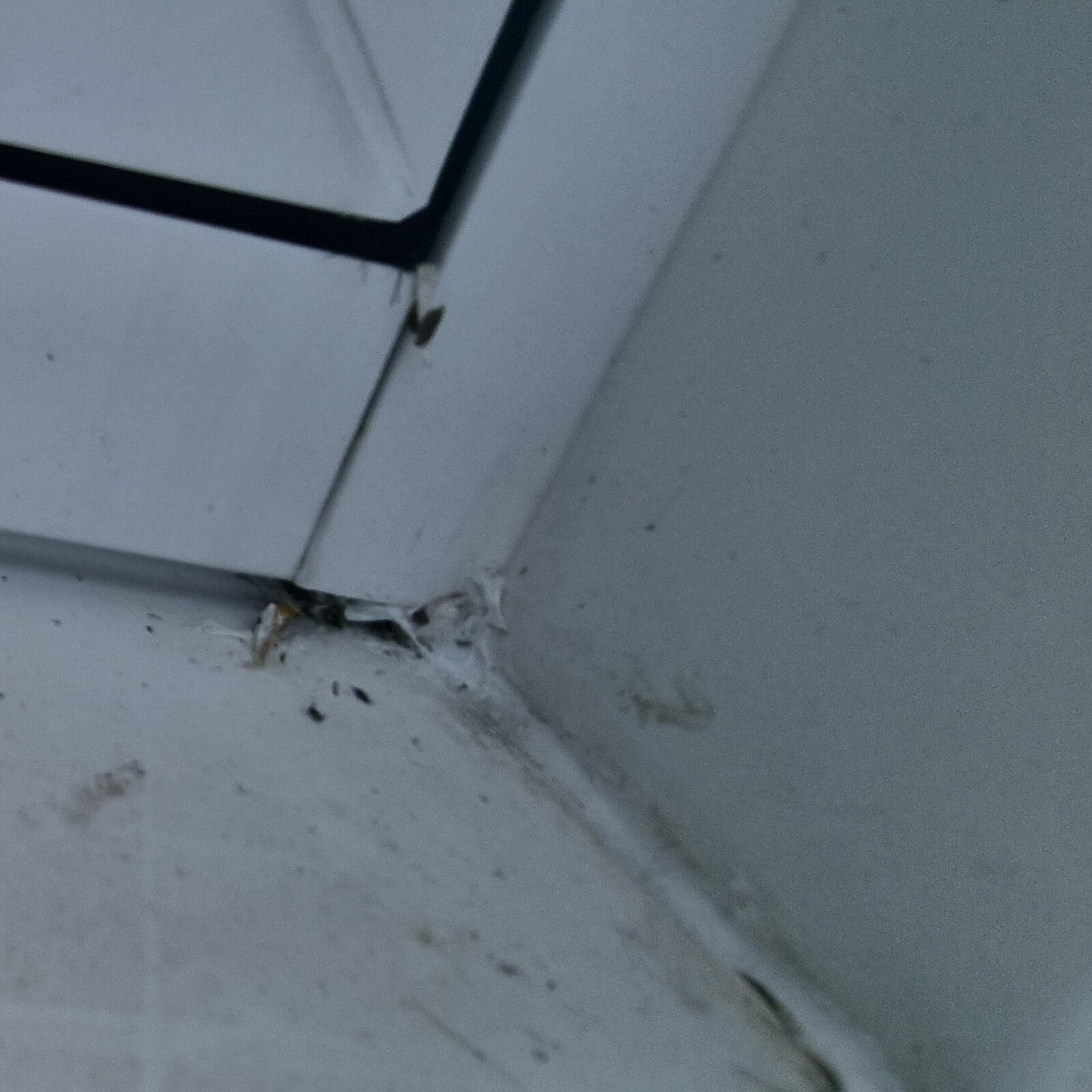

It may be a case that either end of the cill hasn't be sealed before the actual frame is fitted. Fitters are supposed to seal the end of the cill and create an upstand with silicone either end. This stops any driven water from running over either end of the cill below the actual window frame. You clearly have water getting under the frame and to the internal plaster ... I suspect the cill os your issue and only rectification is either remove window or chip wall ( and then still not easy!)

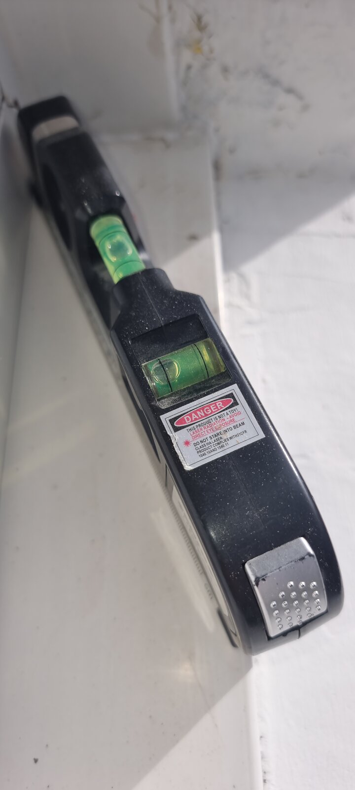

Please see pics. You can see where they've added silicone, I am guessing they suspect wind driven rain in the corner rather than frame drainage issues.
There is a slope, although it's not great.
Windows are mechanical joined, not welded.

That looks ok front to back ( must have been angle of picture earlier ) Should be no slope from left to right, that should be level.

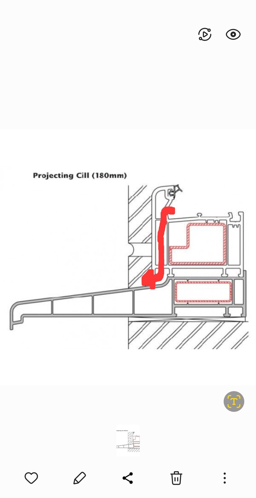

Have a look at the attached picture, it shows how base drainage works ( hole in rebate won' t line directly up with hole in bottom of frame though ). If you have no water following that path then there is an issue with the drainage and I would want to know where that water is going. If the drainage holes are missing I'm concerned the fitters never noticed and as Swwils says why have they not tested where the water is going yet
