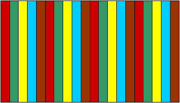

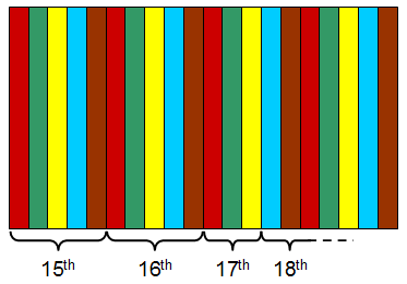

That sequence is still being followed, the difference is that both the 15th and 16th had the original (red) and four reprints to use all 5 colours, the 17th also started with red but has only two reprints (green, yellow) making the next one blue even though that is a different edition entirely.
That's not logical, captain!
I can just about see a bit of logic in it.
Each new 'complete printing' of BS7671 (i.e. excluding things like Amd2 of 17th, which did not result in the printing of a whole new book) represents the set of regulations with which one must currently comply, so it doesn't really make any difference whether it is a 'new edition' or an Amendment of an existing edition.
By doing what they appear to be doing (per flameport - cycling through 5 colours, regardless of 'editions'), one can tell from the colour 'how out of date' a version is by its colour, but that would not necessarily be true if they always started a new edition with red. If they did that then, for example, in the very unlikely scenario of an edition having no Amendments, the next version of 'current regs' (the first version of the next edition) would also be red.
Kind Regards, John
Yes it is.
From 1981 onwards when you look at your collection on the shelf you will always see this pattern repeating¹:
Sometimes a new edition will occur at the brown to red transition, sometimes it will not.
¹ Or at least, you will if you discard the first of the two brown 15ths and the first two of the three red 16ths :mrgreen:
Surely it won't, unless every edition has the full range of colours?
Your "unless" and BAS's "sometimes" surely mean the same thing?
A new edition will only be red if the previous edition had four Amendments - whether one calls that 'sometimes', 'occasionally' or whatever.
Kind Regards, John
