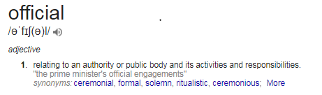

Depends what you mean by official.
https://www.gov.uk/building-regulations-competent-person-schemes
It is. However, perhaps ironically, people who do not self-certify are, at least in theory, free to use methods other than compliance with BS7671 to demonstrate satisfaction of the requirements of Part P.
They, then, have to abide by the Local Authority.
As you say, one condition of being able to self-certify is to fully comply with BS7671. It seems that another condition is that one must have an up-to-date copy of the OSG. Since you believe that such organisations are only able to impose 'legally reasonable' requirements, you presumably must think that it is 'legally reasonable' for them to require that members have such a book - but how 'reasonable' is it to require members to have the book if there is not also some requirement that they look at it and in some way 'acts upon' whatever it says?
No. I think it is unreasonable to insist on the OSG.
Indeed, as I implied, it is 'official' in (and only in) the context of self-certification. However, the official stuff (and, I presume, legislation) about CPSs only talks about the minimum standards to be imposed on members by Competent Person Schemes, the implication being that providers can impose more stringent/extensive requirements if they so wish. Unfortunately, the link to "electrical minimum technical competencies" (from www.gov.uk) is to a non-available page on the IET website, so we don't know what those 'minimum requirements' are (it might just be an attempt at a link to BS7671)!
Oh, sorry, I misunderstood. Presumably others must disagree with you, if, as you suggest, "legally unreasonable requirements" are 'not allowed'?
Don't get me wrong - as you know, I'm no supporter of the OSG - particularly in relation to the bits which seem to have crept into it which appear to have no basis in BS7671 itself.

1) NICEIC is not an official body.
NICEIC was/is just a trade organisation but surely that part of it which is now a competent person scheme authorised by a Government department is sort of official.
