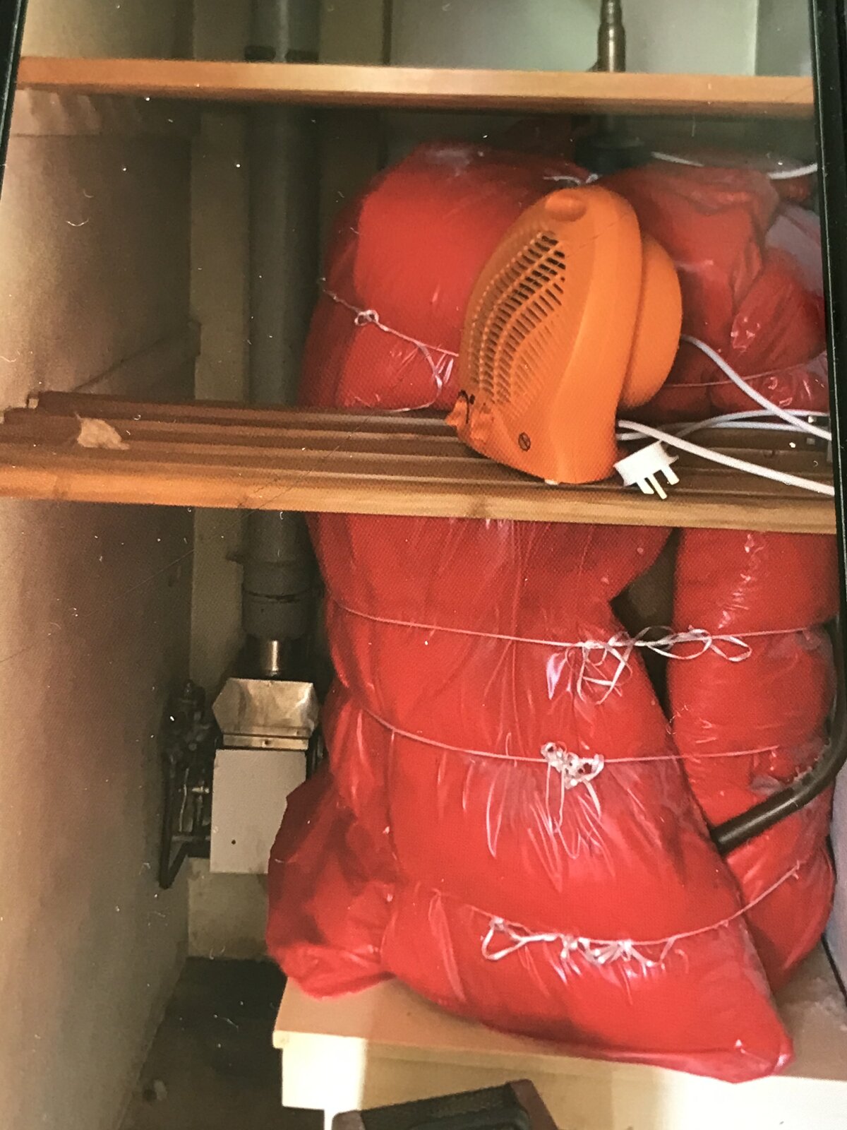

There is currently a hot water cyclinder fitted in one of the upstairs cupboards but the mrs wants to do away with this and extend the bathroom , we are looking at fitting the combi in the garage . We are awaiting the keys so need to have a good look around the systems currently fitted when we get them , out of curiosity any ideas what that box is in the corner , it looks to have a flue on it and it’s gas I think possibly to do with the hot water . .?
If I did go down the cylinder route etc what would you recommend for the heating system ? I did mention to our lass about a unvented cyclnder for the water pressure but she wants the space for making bathroom bigger

Yes its to give hot water with your hot air system, if your putting the boiler in the garage consider an unvented cylinder (get the pressure and flow checked first) it will give much better hot water delivery.
