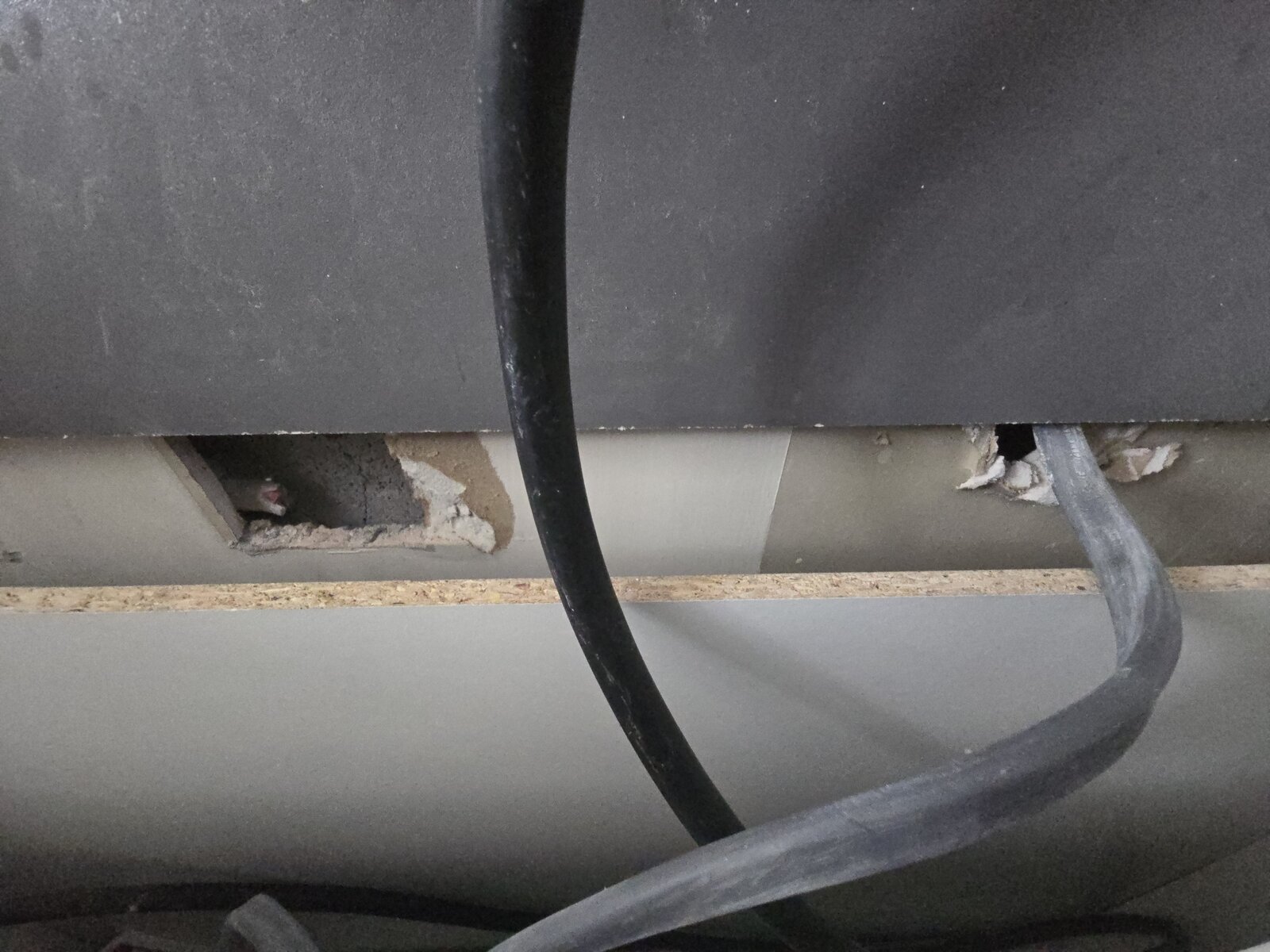

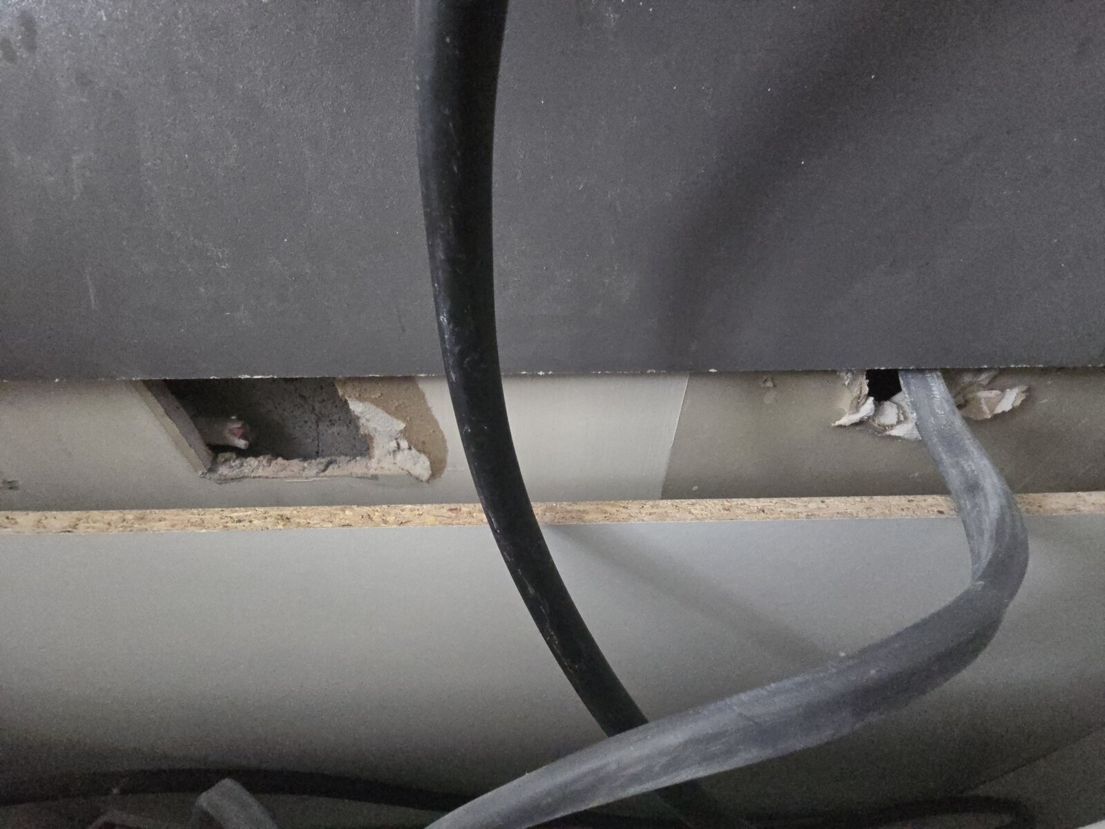

Thank you, I'll have another go. For today, would the mf junction box be acceptable?
Here's a photo to hopefully clarify what I'm describing.
There are draws that slide into this space with a small clearance.
Read the hob installation manual carefully.
I removed the drawer from under my Bosch induction hob as there was insufficient clearance for the hob cooling fans etc.,. to work as designed.
