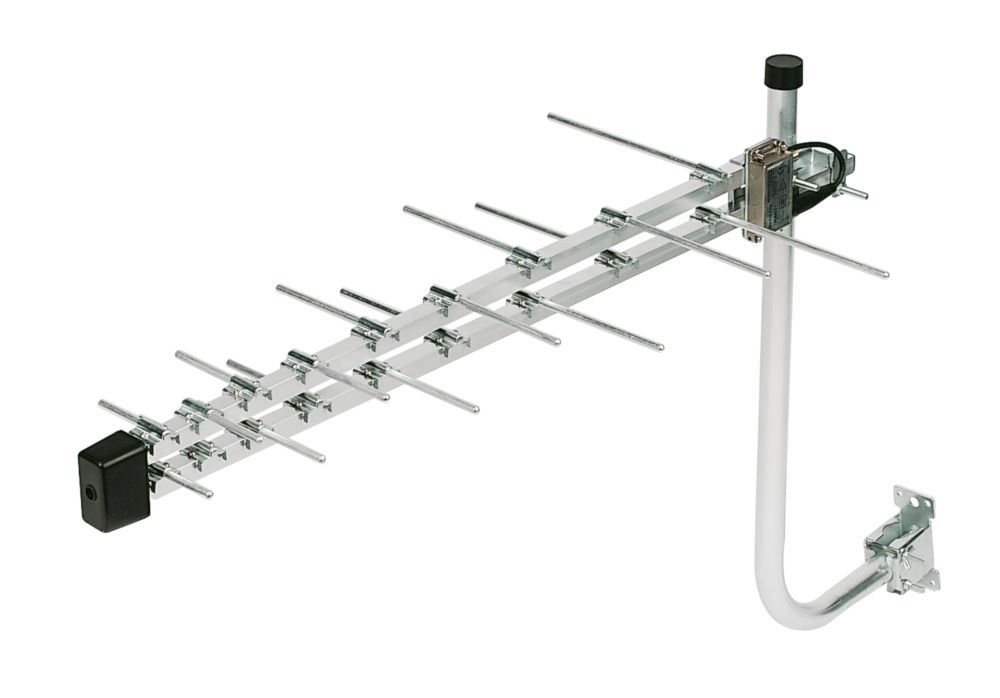

have not seen TV aerials stacked I will assume the wide band width means it is hard to tune but with hams that is a common. This add is typical it gives the weight as 2580 kg hang on that's nearly a ton! QUOTE.
Stacking is done for TV aerials but is rare. It was done to eliminate ghosting which is no longer a problem with digital.
2580Kg is actually two and a half tons!
That is some aerial
ae235
does not look that big on the picture. I must ask at Electrofix how it is delivered so so big!
For my TV aerials I go to http://aerialsandtv.com where you'd find lots and lots and lots of information. If you fancy a laugh, go and browse the rogues gallery :ROFLMAO:
My personal preference given that I've a fairly weak signal from Winter Hill or Lancaster and without complete LoS is a high gain Yagi of the right group. Mum has a gp C/D pointing at Winter Hill that we put up some years ago, at a mates we put up a gp A pointing at Lancaster - both give a good signal.
At home I currently have a Log 36 (instead of a grouped Yagi as I didn't know which tx I'd be pointing it at) and am a bit disappointed. Even allowing for it being in the loft, I only get a "reasonable" signal from Lancaster (vertical) - reception from Winter Hill wasn't adequate. I'll be going with another high gain Yagi when I get round to sorting out the chimney and replacing the aerial on that.
I'd also second Satcure. Well worth supporting both these vendors for selling "proper" products and giving real advice based on field knowledge rather than just what the manufacturer's blurb says !
If all the frequencies to be received are bunched in a tight little knot, and you know for absolutely certain that there no chance of that frequency distribution changing any time in the foreseeable future (let's say 10-15 years) then definitely go for a grouped aerial
UK regulator Ofcom have revealed their aim to clear the 700MHz frequency band in the UK for use by mobile data services no later than the second quarter of 2020. Channels 61 - 68 have already been cleared for 4G use and this proposal means that channels 50 or 51 - 60 will go.
