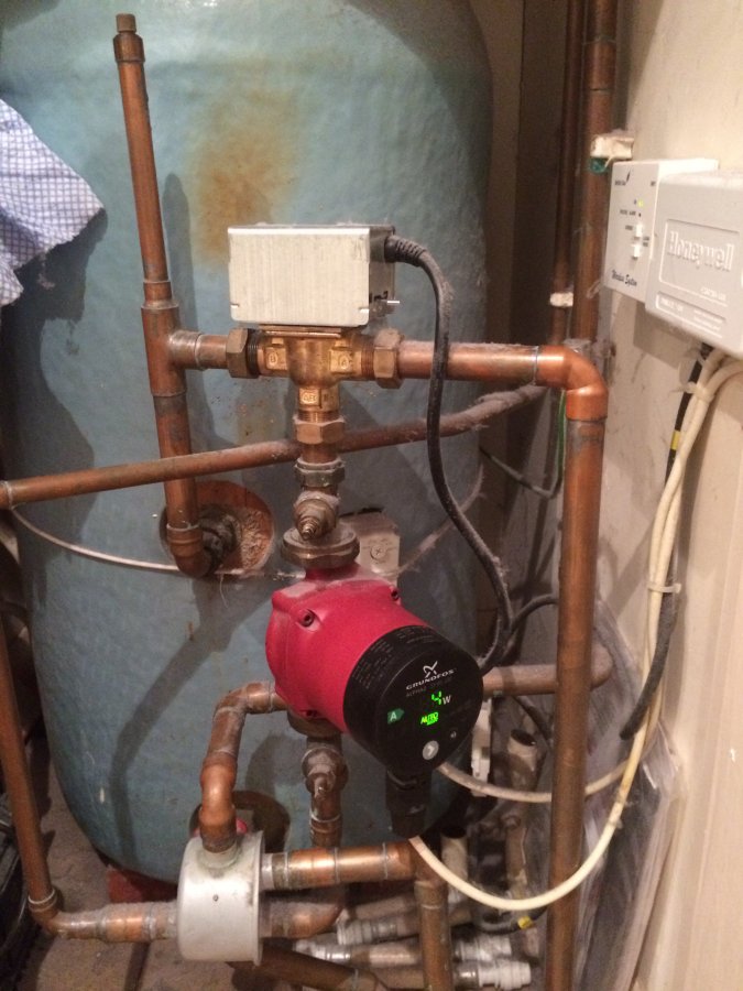

Afternoon all.
I've been looking in this forum for similar problems at it seams the Alpha 2 isn't without its problems.
We've got a Grundfos Alpha 2 15-60 130. Fitted by British Gas 3 years ago, it's been fine but this winter it's be really quite noisy regardless of what setting I switch it to. There's a gurgling sound, so I'm guessing there's air in there but it cannot be bled, and the pump generally is noisy where as before it was almost silent.
We're covered by British Gas for all service and breakdowns. The engineer came out yesterday and serviced our boiler and we mentioned the noises we were getting from the pump. He briefly bled the radiators but said there was nothing he could do with the pump and that it was fine, nothing to be concerned about.
Sounds like he didn't really want to deal with it as he was only in the house for about 25 mins.
Should I be smelling a rat?
Cheers Jon

can you post a pic of the pump and the pipes around it? Interested to see which direction it is pumping, and if the spindle is horizontal
Here you go.
'mmmm
pumping vertically as I suspected
Is it pumping upwards or downwards? Pumps that push downwards may collect air that can't get away.
As I understand it, the feed comes into the bottom of the pump via the aerator (I think that's what it's called). Then up to the diversion valve.
Bleed screw cap at the top of the feed to the HW tank.
well that should be right, but it's not unknown for heating engineers to pump systems backwards by mistake.
There may be an arrow cast into the iron body of the pump. Or if you can photograph the other end of it, the shape may show.
If you can lay your hands on a strong magnet, see if it is attracted to that grey thing, or to the small pipe leading to the air vent at the side of the cylinder.

Can confirm the arrow on the casting points upwards and therefore in the correct orientation to the pipework.
The highest radiator in the house is in the bathroom, the first radiator after the pump. Water flows well when bleed screw opened.
