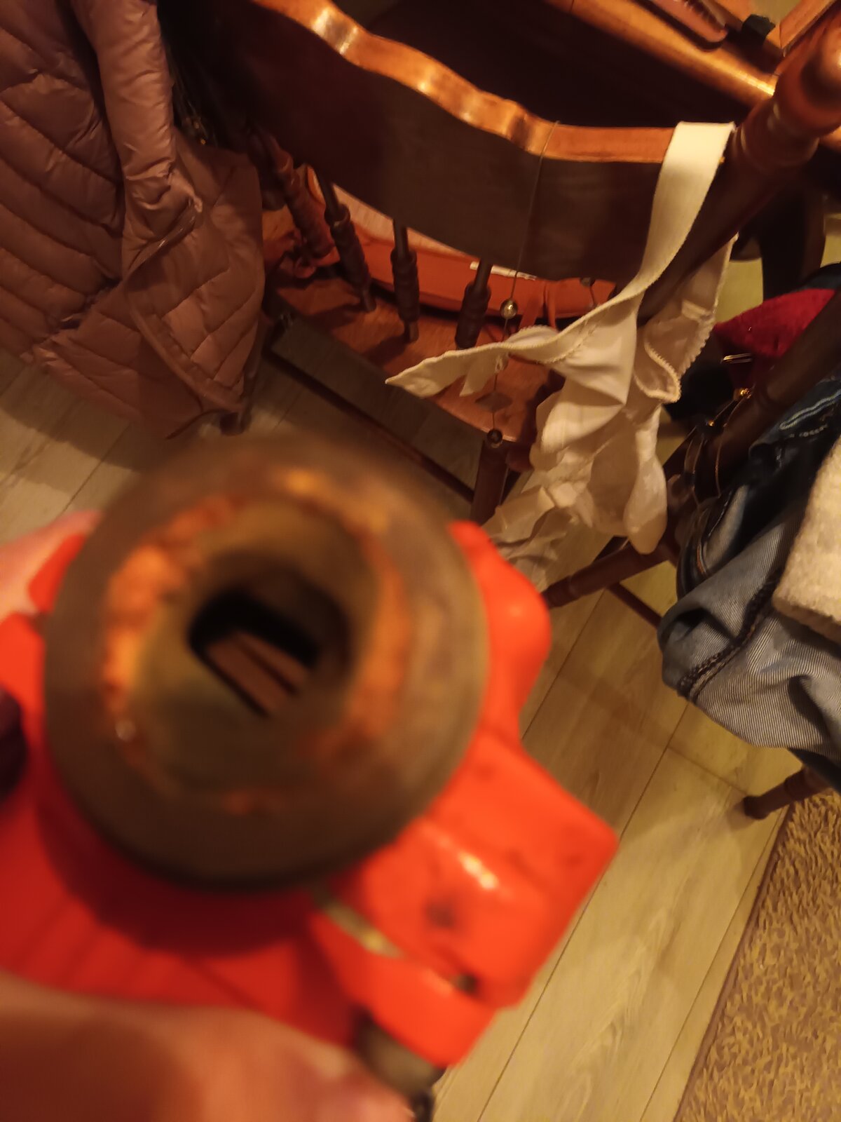

Took the 4 allen screws off the pump and pulled it apart but its sealed behind so didn't get to look at the impeller, wasn't sure if it was a good idea to prise it apart so put it back together.

I have only ever split one of the older 3 speed only pumps, there was a SS diaphragm on these I think which i carefully prised up and was able tp pull the head off. Again. on the older type, with the pump removed, you can see the impeller at the discharge port and on the old one I have here its possible to push a narrow tie wrap through the impeller vanes to prove them clear which may be enough?.
If the Hx was choked wouldn't I be getting a lot of noise and kettling from the boiler, when HW is on the boiler sounds smooth and quiet, with these Drayton valves open a bit wider and just the CH on the boiler runs quiet and smooth as well.

Yes, you could, of course, but not a big deal to remove the old one first and at least look into the ports?, or buy the new pump locally with the option of returning it if the old one has some obvious crap in it when you revove it and can clean it out. If you don't buy another Apha 2, ensure that whatever you purchase displays the power.
