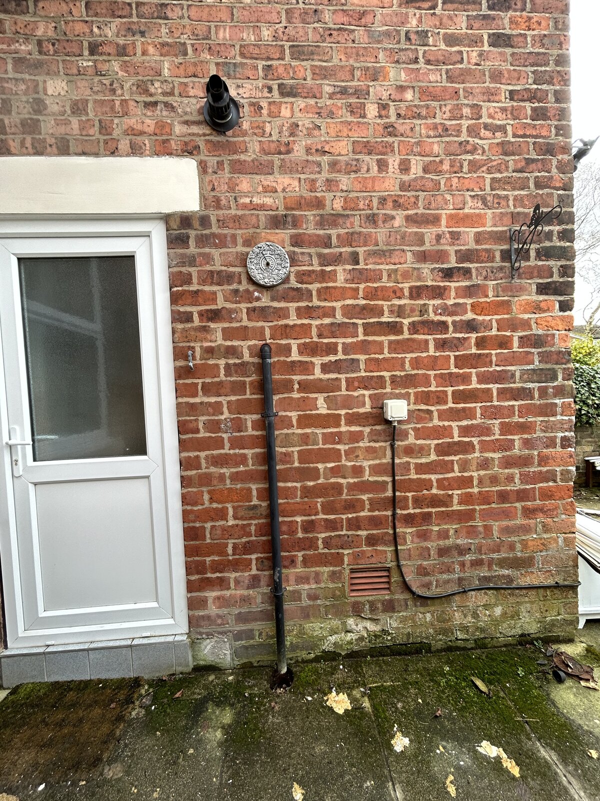

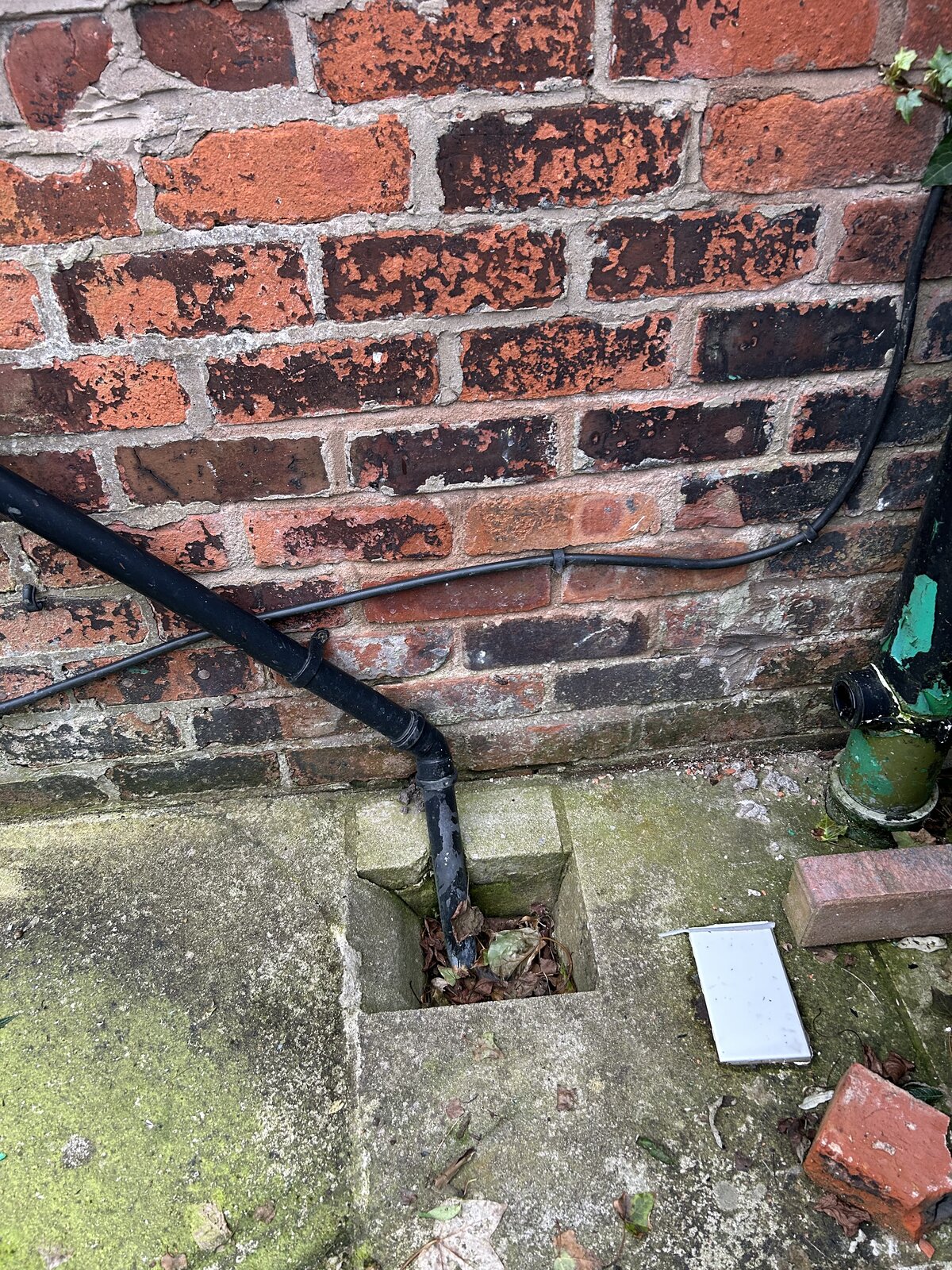

Airbrick and damp, 1890s house

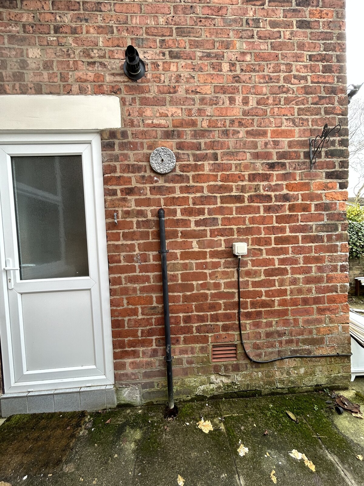

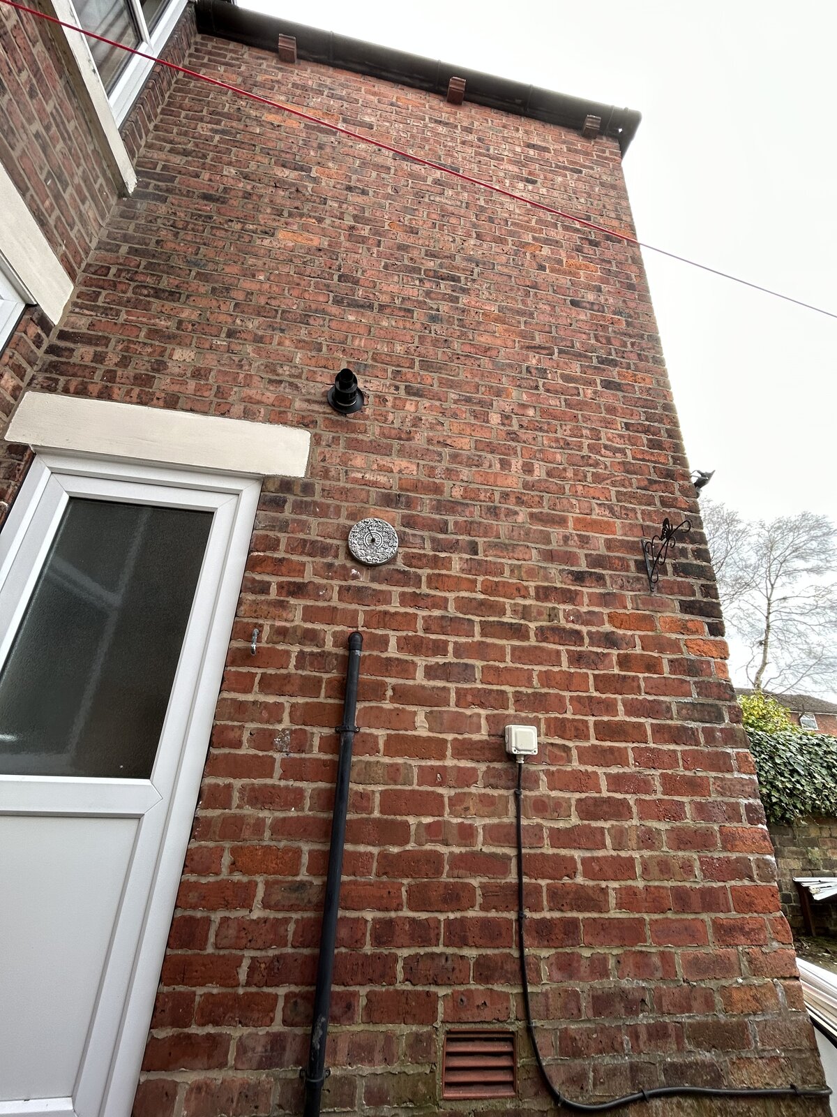

Water coming from your boiler, or plumbing pipes? The apex of the wet patch is 4-5 o'clock from the boiler exhaust.
I'd agree with that.

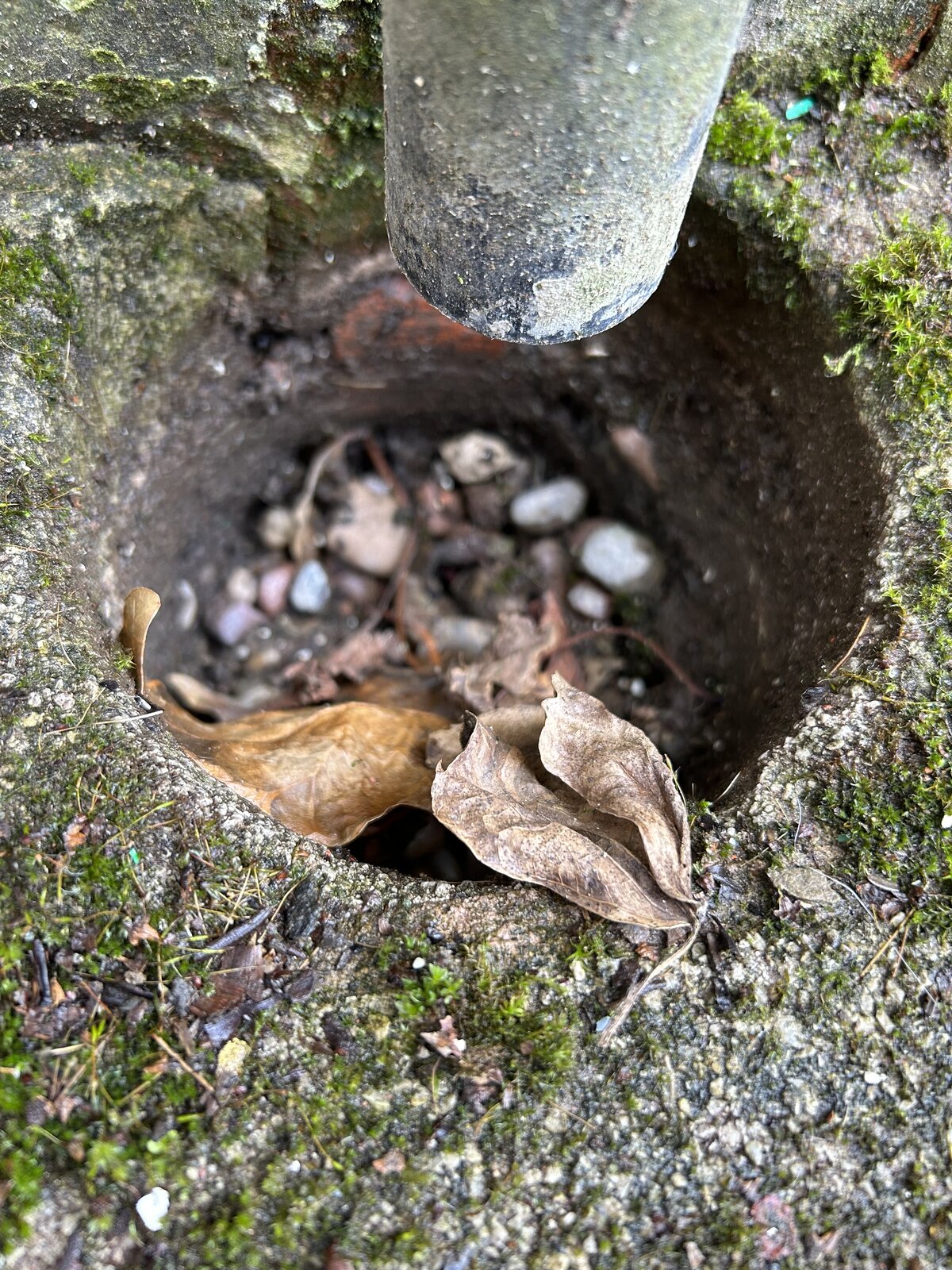

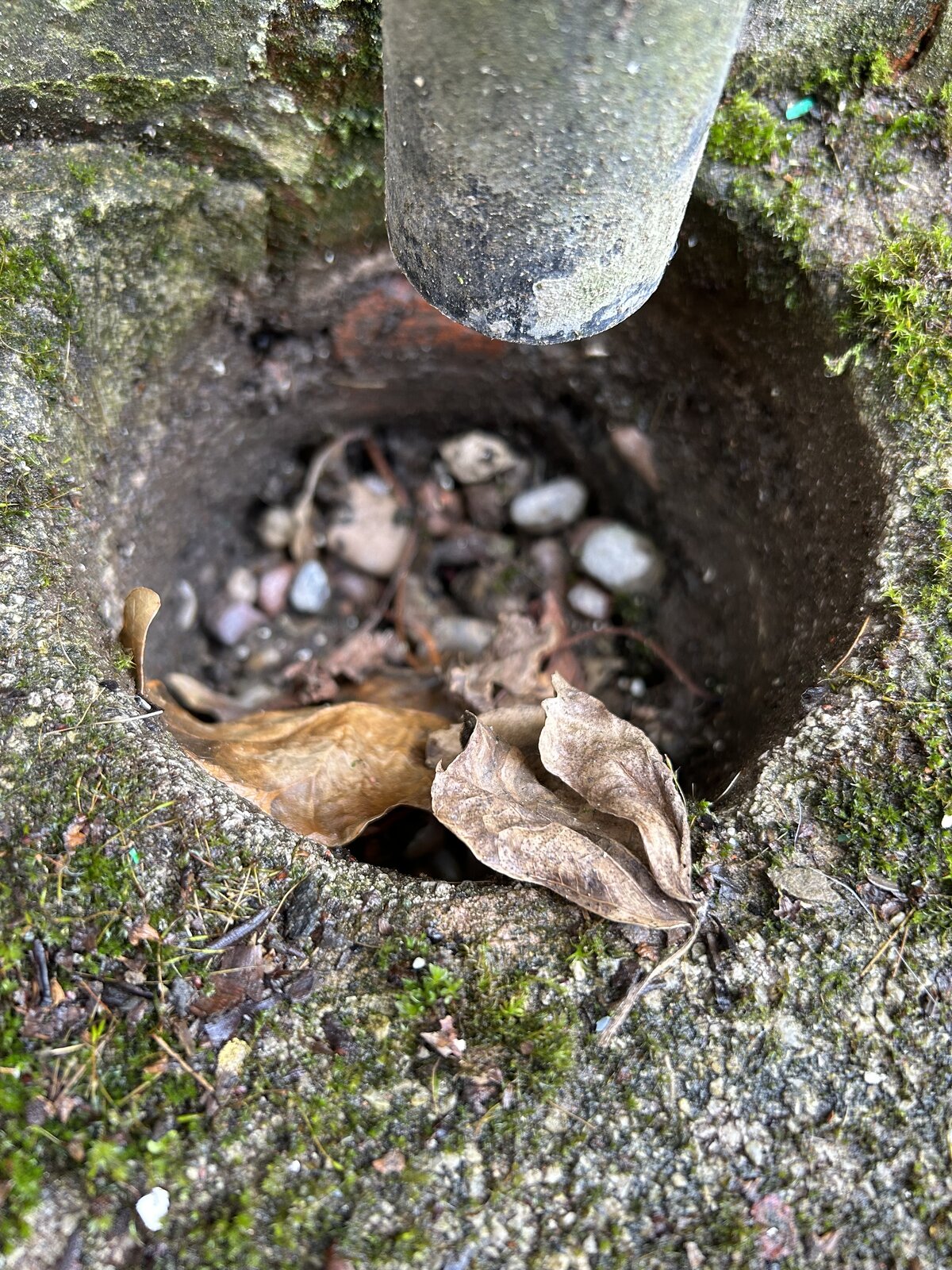

Lift the slabs as I reckon you'll find some lashed up soakaway has failed.

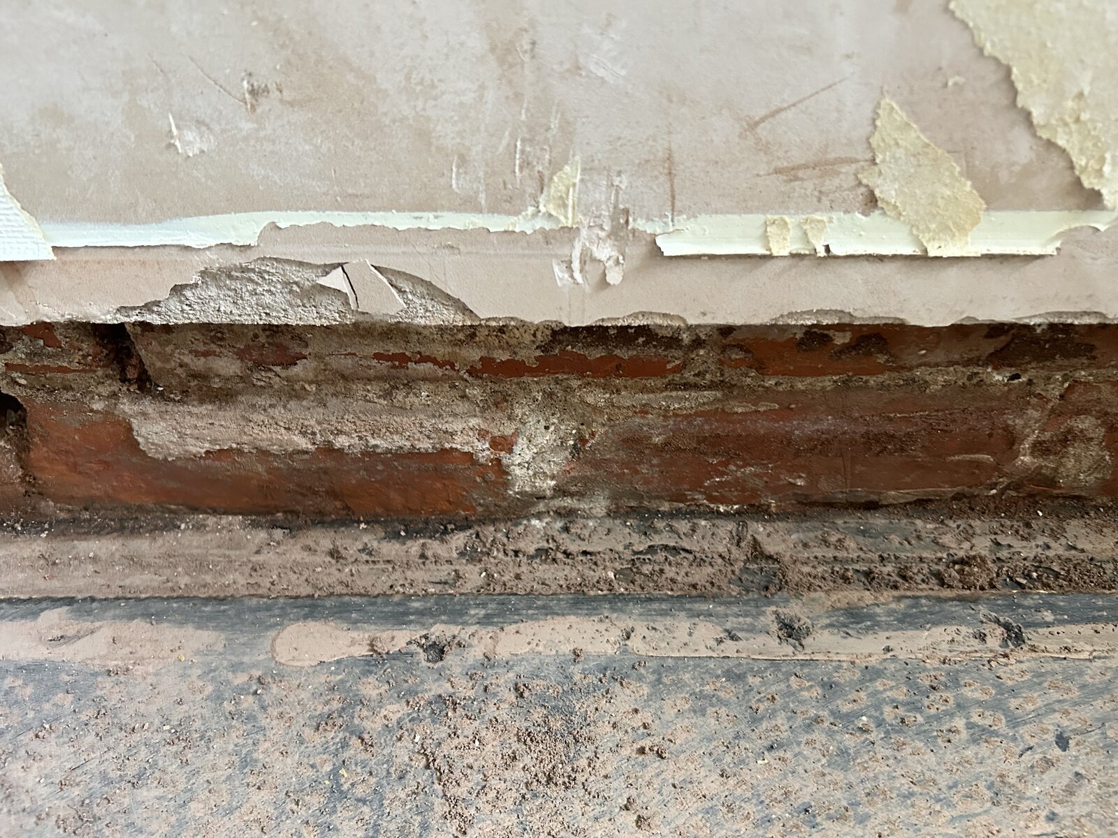

I also have some damp on an internal wall between the living room and the hall. It looks like it’s had this issue before as it has an injection dpc, I believe the floor has been filled in with concrete, there are some original airbricks at the front, they are right at the external ground level. Could this be causing damp? I wasn’t sure as if it’s been concreted there is no need for them?

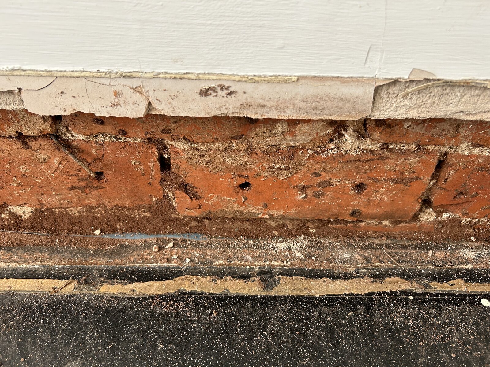

There might be some bridging of the dpc (or lack of it) because the grey/blue membrane in the second pic of the original post is not lapped into the wall. The gulley/soakaway may not have failed but got blocked with leaves moss etc over time and the surface water has spread across the slabs and into the wall, so that is the first thing to address.

Thanks Blup. Is there anyway I can fix that issue on the internal wall. Should I be removing the bricks one by one for example, and taping and lapping?
Silicone injections are rubbish. They do not repair leaking pipes or broken drains. As you have seen, they do not cure damp. Filling in a damp gap with concrete provides a path for water to soak into, and prevents it escaping. Unlike a ventilated void, it prevents water evaporating away and drying out. A house of that age may also have a leaking water pipe on the route between the outside stopcock and where the kitchen sink used to be.
The ground level has been raised since the house was built.
Sadly your house has all the ineffective bodges, without a repair to the broken drain that has the source of the problem for generations.
Even more sadly, this is quite common.
If you repair the cause, the house will start to dry out. Don't waste time and money on anything else until you have done that.

I think the broken drain will be the cause of the severe damp next to it.

Identify the cause of the broken/blocked gully, check/install install a physical dpc and lap the damp proof membrane over it.

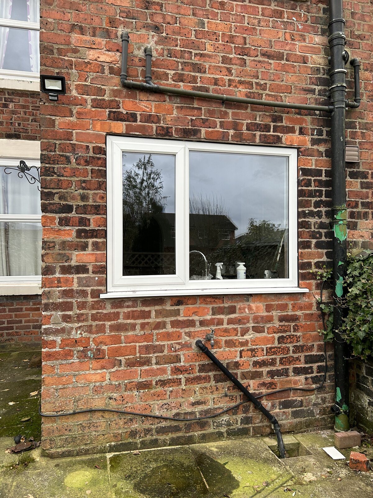

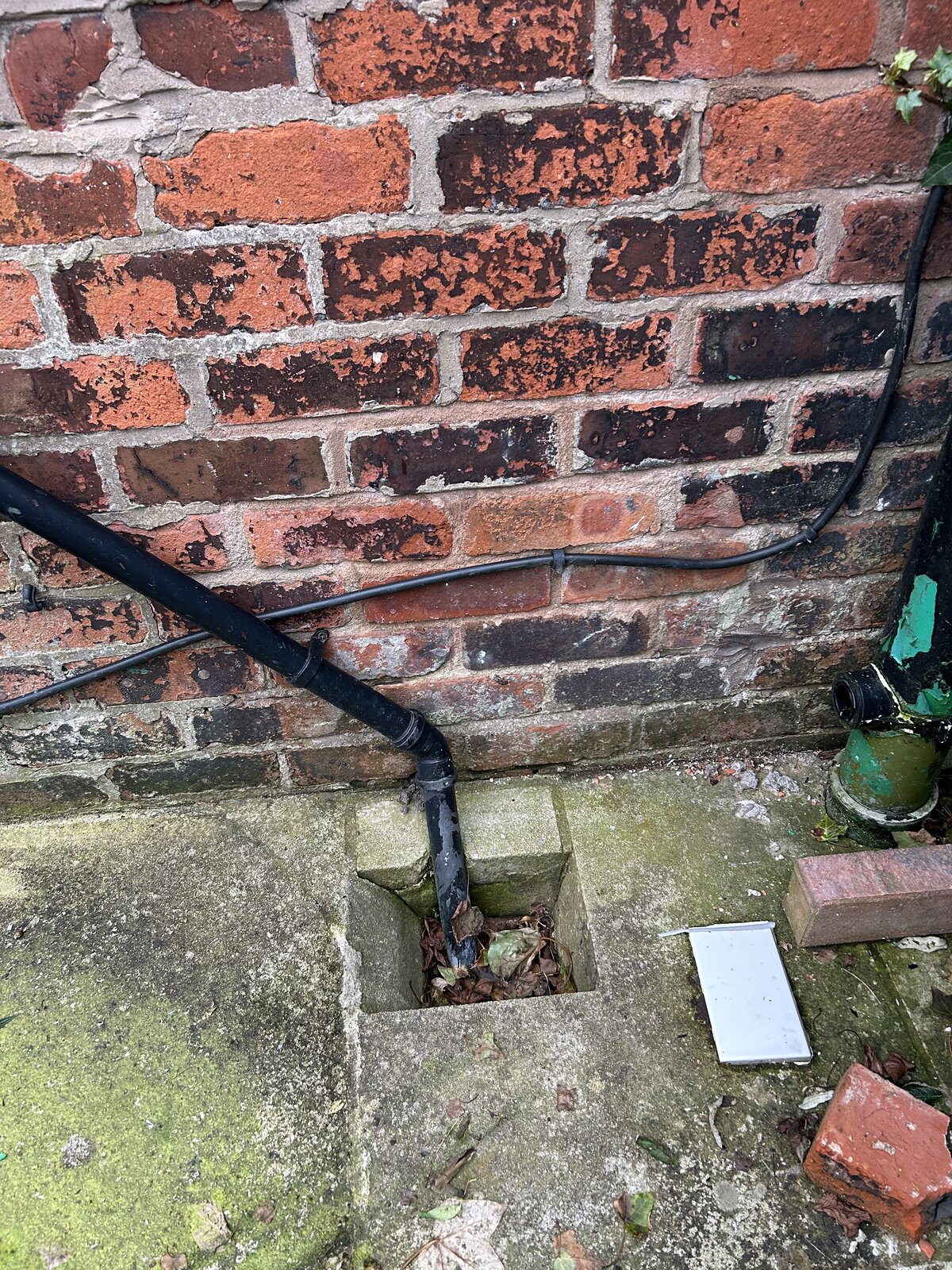

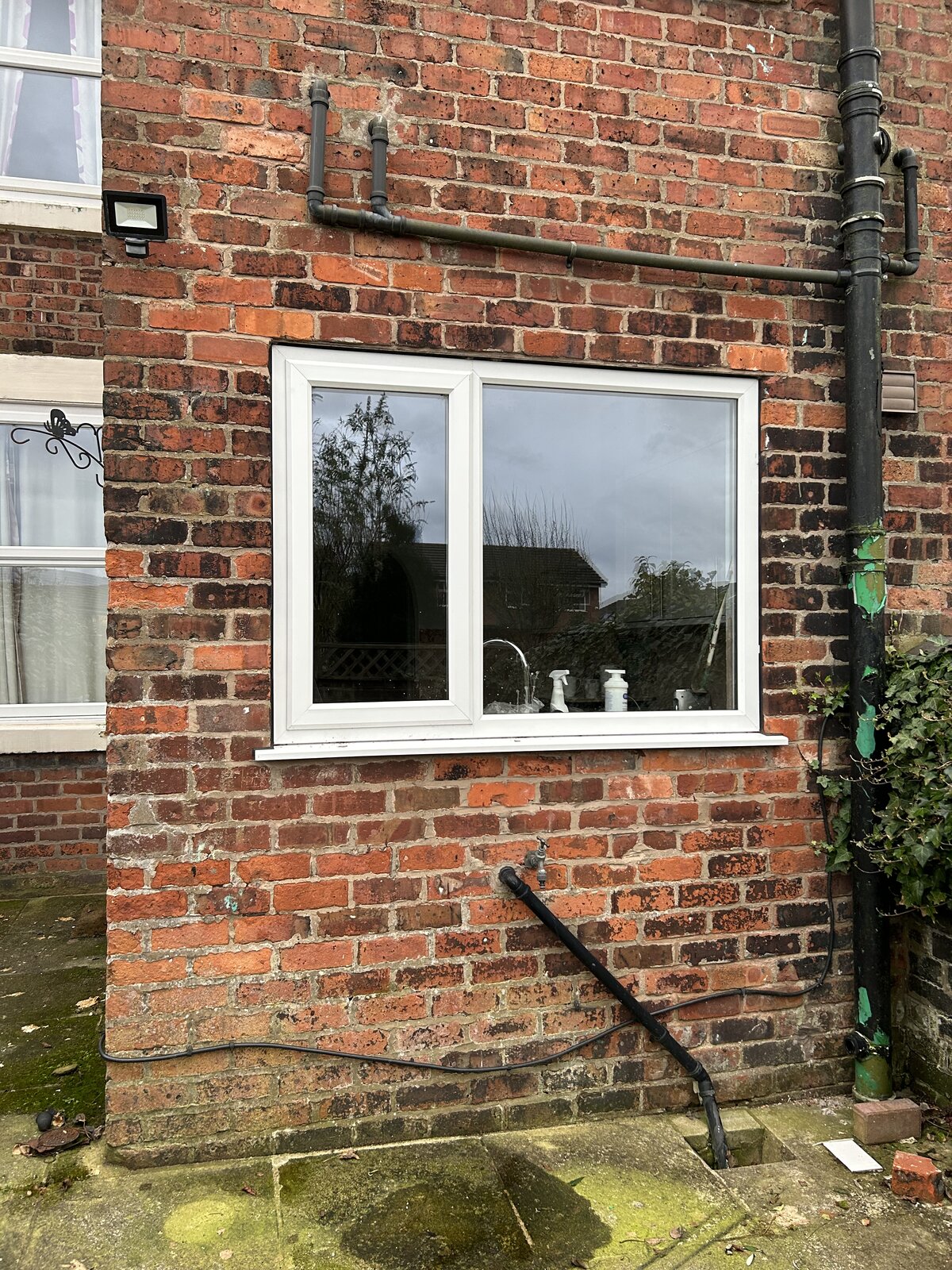

I’ve not noticed them spilling but I’ve only had the house a few The bathroom and kitchen drains are round the corner. Once I’ve lifted and investigated the drain / soak away, i’ll look to put the condensate pipe round the corner and into same drain.

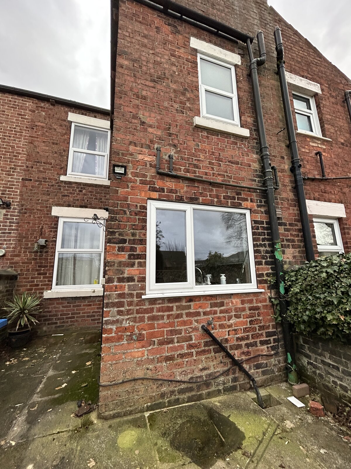

The garden wall and the house wall at the back both look dark and damp. The gully at the back is also a long way below the current paving level. So either the gully has sunk (this happens when they leak, because they are very heavy so they sink into the soft wet mud) or the level has been raised above the DPC.
Or very likely both.
Plenty more digging for you!
That paving has all got to come up. You can just about make out the top of an air brick by the gully, it’s way too high
