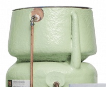

i sawed in half a vented direct immersion boiler (which supplies hot water in property with eco7) and elevated the feeder tank into the loft. Both the tanks are intact (no new openings). I reconnected the severed pipework, the only difference is the header tank sits 25cm higher than it used to relative to the heater tank. Both tanks are 70cm higher relative to the taps. I didnt opt to move entire system to minimise heat loss in cold attic.
There is better pressure to shower now but far less hot water capacity. I gauged this with a full bath, a volume of which im familiar.
What happened? My only theory is that the feeder tank has a stainless steel braided flex hose for the water feed in and that’s perhaps creating bottleneck. Maybe the new higher hot water pressure empties tank faster than it fills? and somehow this traps air inside - I don’t know the mechanics of inside the boiler.

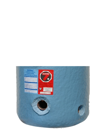

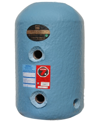

Are you seriously saying you took a hot water cylinder and cut it in half?
So from this >>>>>>> To Like something like this?
the tanks were not compromised. The unit was factory constructed with a header tank soldered to the bottom portion (shown) with copper standoffs. I just cut the standoffs and the vent pipe and cold feed pipe. The cold/header feed pipe (from header tank directly above) is seen in the attachment. The vent pipe is behind also leading to header tank above.

Is your vent pipe hanging over your cold water tank well above the level?
No, the pipe extends not any higher than as it was manufactured (in the pic attached, the pipe thats lagged is the vent, to illustrate )

Well that's probably about half a bath so wouldn't be any great surprise if you can't fill it. It's possible you're emptying faster than the cold replaces it but it should just suck air through the vent pipe. It's possible with you moving the cwt higher the vent pipe is now too low and it's trying to suck water and created an air lock. Take the lid off the tank and either raise the vent or lower the float and see if that makes a difference. Try to ensure the new vent pipework between the tanks is constantly rising.

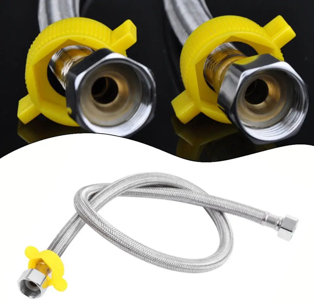

I might replace the mains pressurised braided hose (which feeds header) with 15mm pipework to see if that changes anything. The design of it is shown attachment (see small opening). I’ll fill bath with tap half open to see if i get more hot water ….
Theres no bends in the vent pipework its straight up vertical.

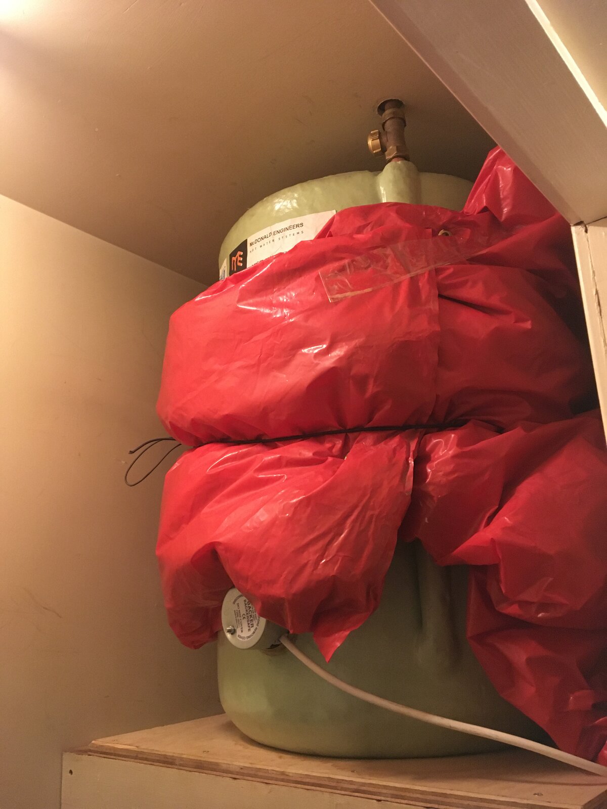

I have found my immersion heater only heats top of tank, where the boiler seems to heat all of the tank, I have looked at the combined cylinder and header tank, wonder what insulation is between cylinder and header tank, is the header tank water pre-heated?
I look at the picture
and wonder if worth getting a tank with two immersion heaters, or is the Willis system
with an exterior immersion heater a better option? Rarely have a bath so don't really need a lot of hot water, immersion only used in summer, to use excess solar, so not enough hot water on a good day, to bridge the gap on poor days, the immersion heater controller is designed for two immersion heaters, (iboost+) but the Willis is likely to heat more of the tank.
