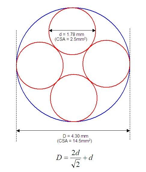

No (unless you are prepared to seriously distort and reshape the solid 2.5mm² conductors). As I said it's all to do with the geometry. See this illustration of the smallest-sized circular hole into which you can get four undistorted 2.5mm² (~1.78mm diameter) conductors:
It only takes abit of geometry/trigonometry to show that the minimum diameter (D) of a circular hole which will accept four circular conductors of diameter d is given by:
D = (2d/√2) + d
For d= 1.78mm, D = 4.30mm, which gives a CSA of the minimum sized circular hole as about 14.3mm². You therefore need a circular hole with a capacity of at least 14.3mm² (not 10mm²) to accommodate four undistorted 2.5mm² conductors. In contrast, because they are stranded, you can 'rearrange the shape' of 4mm² or 6mm² conductors, and therefore get three of the former or two of the latter into a hole not much larger than the total combined CSA of 12mm². To get four 2.5mm² solid conductors into a circular hole of 12mm² CSA would require considerable distortion of the conductors. To get them to fit into a circular hole of 10mm² CSA would require them to be totally reshaped into 'quadrant' (not circular) cross-sectional shape.
Does that make sense?
Kind Regards, John

I know we have (even though it appears to be non-compliant with the MIs, hence also presumably the regs) - but that must mean that they have quite generous holes. As I've illustrated, you could not get four of them into a 12mm² (let alone 10mm²) circular hole without hammering at least some of them first!

I am not sure what we are discussing.
You have just worked out the absolute minimum diameter for four 2.5mm² conductors.
The fact that it is possible to insert two 2.5mm² with folded ends, albeit pinched tightly, or three 4mm² conductors into the terminal easily without force means that the terminals are larger than this.

I have an MK socket here which has terminals which have a diameter of a good 5mm, i.e csa of approximately 20mm² - 6 is 28.

Well, primarily I was trying to illustrate the flaw in your assertion (complete with dictionary definitions :) ) that if a terminal has the capacity to take 3x4mm² conductors or 2x6mm² conductors then it necessarily must have the capacity to accommodate four (or maybe even five) 2.5mm² conductors. As I hope I've illustrated, if the terminal hole is circular, and if the (stranded) 3x4mm² conductors or 2x6mm² conductors can be made to 'just fit', the four 2.5mm² ones almost certainly would not fit. As I said, the crucial difference is that the 2.5mm² conductor is solid, whereas the others are stranded (hence their 'shape' can be changed).
However, as a secondary motive, I was also trying to see if I could find a way in which the MK MIs made sense, in saying that the maximum capacity was only 3x2.5mm², whereas it had the capacity for 3x4mm² conductors or 2x6mm² conductors. Qualitatively, I've certainly found a possible type of explanation. As below, maybe they feel that, because they are solid, four 2.5mm² conductors would be 'too tight' in their terminal.
I have an MK socket here which has terminals which have a diameter of a good 5mm ...
That is theoretically enough, if the conductors are dead straight. As I illustrated, you need a minimum diameter of about 4.3mm to be able to just squeeze 4x2.5mm² conductors in. However, in practice, one is going to need a bit more than 4.3mm if it is going to be anything like an easy task to get them in (particularly if the conductors are not perfectly straight), so maybe MK feel that even ~5mm diameter is not quite enough? Who knows?!!
Anyway, regardless of their reasoning, it is clear that putting four 2.5mm² conductors (and I assume that includes 'two doubled') into one of those terminals is non-compliant with the word of the MIs :)
