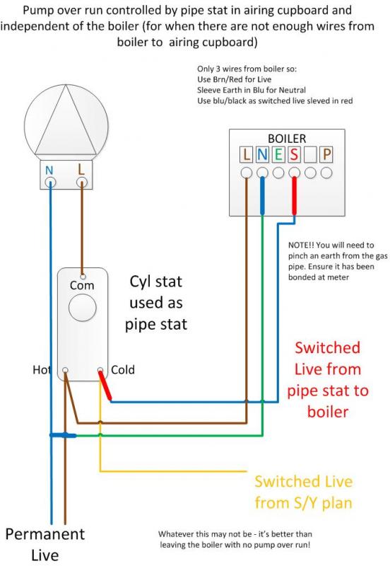

We got it in writing that the manufacturer would except a pump over run timer as along as it was noted on paperwork, boiler and set to run longer than their own time.
(Listed building that physically couldn't be altered internally to amend wiring, customer supplied boiler and we do like to cover our aris)
So I'll repeat what was put pages ago, pump over run timer and it's cheap and simple.

Does that sort out the permanent live problem, frost protection etc?
No, although it is a workable solution, it does not sort it out completely as it does not provide any frost protection.
What is needed is to have a mains supply available close enough to connect it directly to the boiler as the permanent live.
The cable between the controls and the boiler is then used to enable the boiler to directly supply and thus control the pump.
All that is then required is a wireless connection from the controls to the boiler to provide the switched live switching signal to call for heat.

If you have a 3 core flex (ie all 3 conductors are insulated) then this is a very simple cheap & easy to fit remedy. Its not perfect to the letter of the law but it defo works. In an ideal situation the boiler would have a earth from a local spot downstairs
As to its operation it will do all a pump over run needs to do - oveverun? This will resolve the F22 fault and we can all sleep easy! Not as 'proper' as Lees suggestion but as all things hinge around money ( unless someone else is paying) then this could save the day.

Could use RF Solutions mainsllink system.
Less than £100 and take 30mins max.
