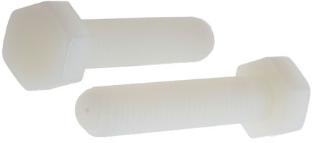

Next question, any ideas how to fill the holes in the 'Henley' block, it's one where the holes need to be knocked out so we can't just lift the blocks out and replace the enclosure without disconnecting.

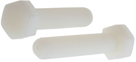

Nylon M8 machine screws. Use the Henley screw to hold it in place.
https://uk.rs-online.com/mobile/p/grub-screws-set-screws/0292675/
good idea, things like that if you need smaller quantities worth looking on ebay and postage is free
