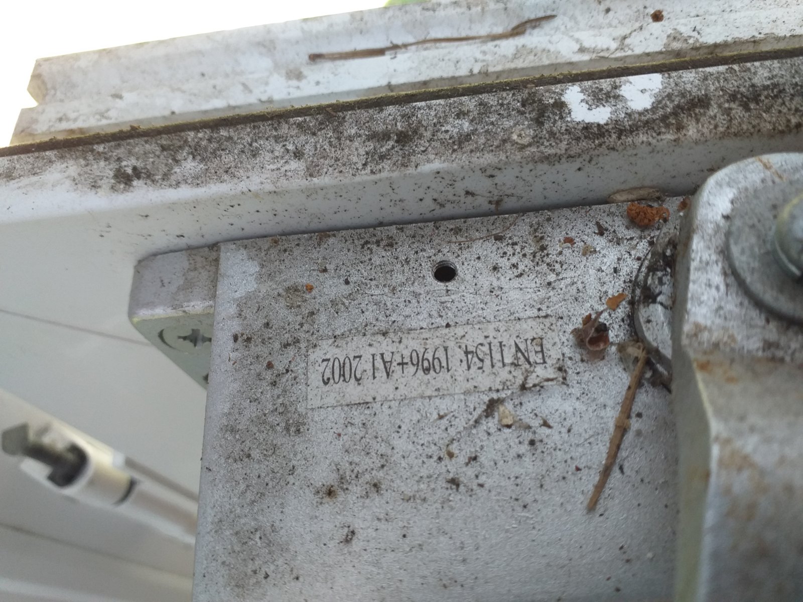

Anyway to make this door shut slowly?
Can I knock the pin which is sticking up down ? I couldn't push it with my fingers.
You may need to use a hammer, with a piece of wood on top of the pin to avoid damaging it. It will just be tension on the door hinge, preventing it being pushed back into place. The pins creeping out in use, is a common problem.

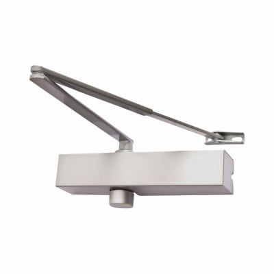

The right angle solution looks like this:
Note that the arm extends out from the body of the closer at right angles (that's the bit of the joists tied arm at the left in the photo) and that the other end of the arm forms a "V". In order to understand how these are installed I suggest that you look up and download the instructions for the particular door closer fitted to your door instead of trying to guess your way out of this (you probably won't succeed). If you can't find the model, try looking around for alternatives as many models work (and are installed) in a similar way with most having two adjusters (for closer speed and latching speed respectively) either on the face, at the ends or on the top or bottom of the body. Typically they are adjustable by screwdriver or metric hex bit). If you can't find the brand and model you want you may find a similar model by looking for the brands commonly used by the trade including Arrone, Briton and Ryobi/Dorma

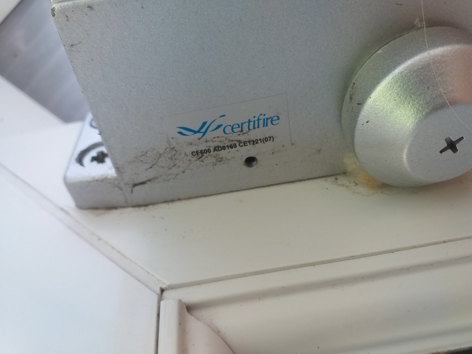

I’ve no idea if it’s the model or not, however several came up when I typed in certifire. I’ve just also found this video which may assist you and save you some money:

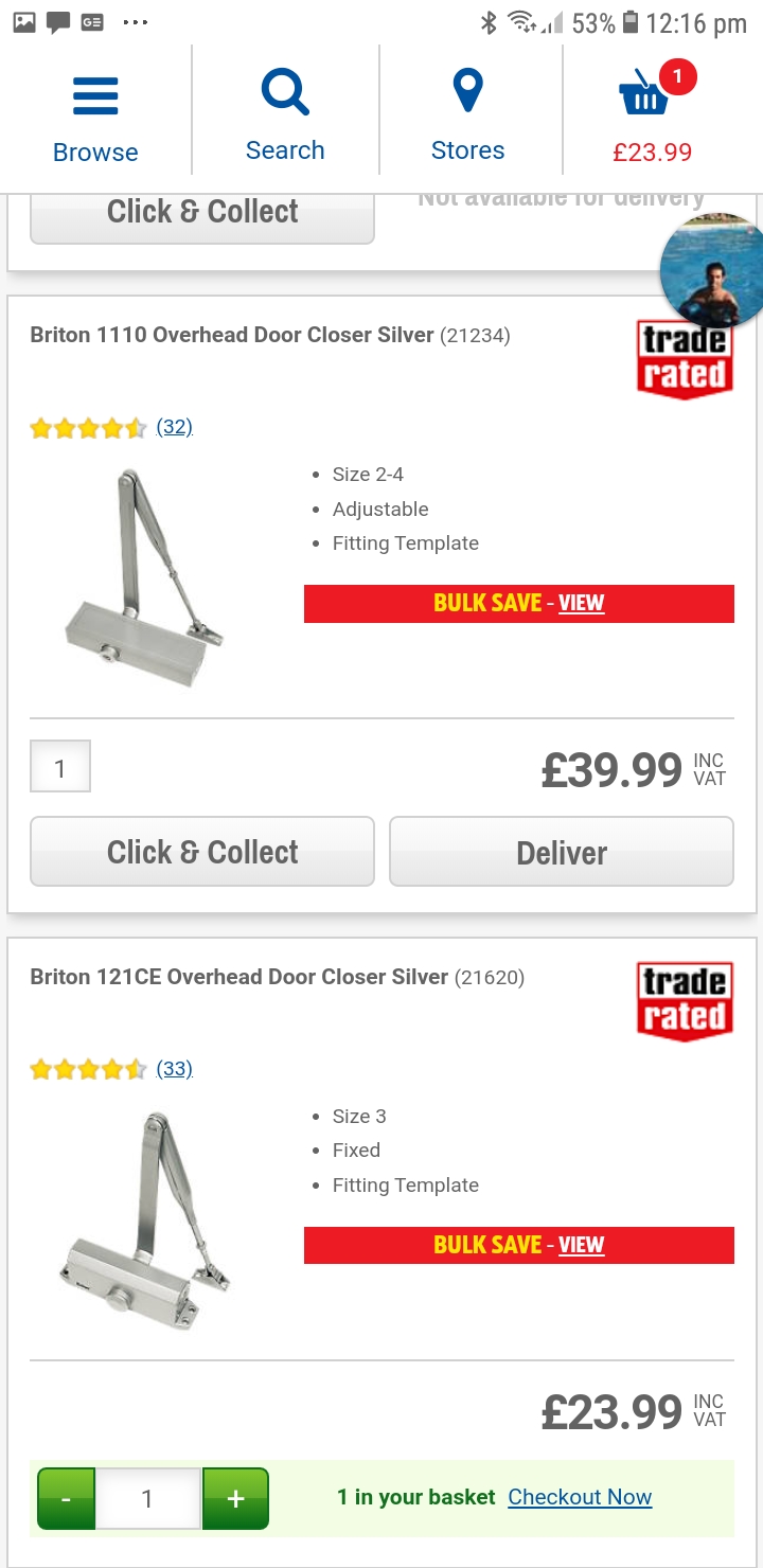

Are there are different door closers for different door weights? ! I heard for 80kg door weight is around £60?
Would these closers from screwfix do the job?
How do I know the weight of my door?

I did so. Thxs.
I spoke to someone who sells doors and closers. Apparently glass in these doors weighs 20kg per square metre. The rest a bit less. So the door no more than 40 kg.
